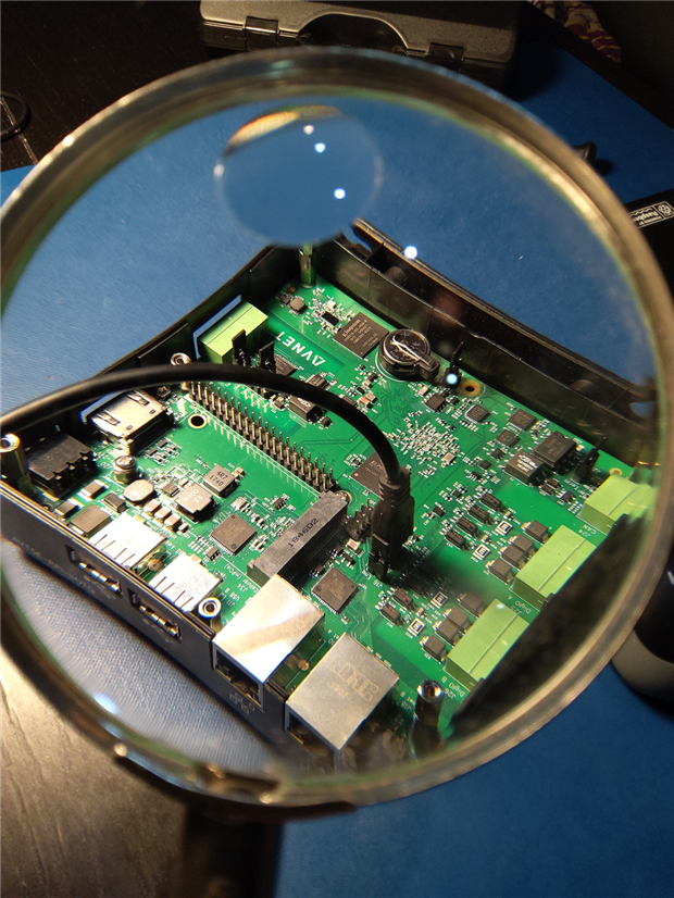

The SmartEdge is family of the Raspberry Pi Compute. You use a rpiboot to load an image.
I noticed that with my device, the Windows and Linux rpiboot didn't work.
If I build the AVNET version from source on a Linux (virtual) machine, it works.
sudo apt install libusb-1.0-0-dev
git clone https://github.com/Avnet/smartedge-iiot-gateway-custom.git
cd smartedge-iiot-gateway-custom/rpiboot
make
check what drives are available (look for sd* devices)
lsblk
unplug the SmartEdge, open it, connect the internal USB to your PC.
check that the jumper next to the USB connector is mounted.
sudo ./rpiboot
provide power to the SmartEdge
check what drives are added (look for new sd* devices, you should find a new sdX, sdX1 and sdX2)
lsblk
You can now use the dd utility to move the image to the SmartEdge (replace the X with the new device that appeared when running lsblk the 2nd time):
sudo dd if=avtse-iiotg-v11-20200326.img of=/dev/sdX
ntewinkel adds these parameters to see progress and get higher throughput:
bs=4M status=progress
Just before finishing, place an empty file called ssh on the boot partition. This will allow you to connect over an ssh terminal (e.g.: PuTTy) as soon as the device is set up. It saves you from having to go find a QUERTY keyboard and monitor.
Then you can unplug the USB cable,power cycle the SmartEdge, and use the AVNET's IoTConnect app to set the WiFi. I had to remove the existing device in the app, before searching for the "new" device.
