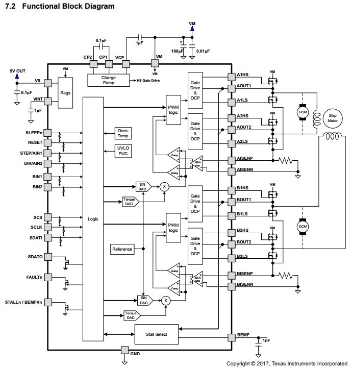

Stepper Motor Controller
I'm using a DRV8711DRV8711. Its main purpose is to control a stepper (although it can also act as a 2 DC motor driver).
source: datasheet
The behaviour of the IC is controlled via SPI. You can set various parameters such as the step divider (allows you to take micro steps down to 1/256 of a step) and speed-up /wind-down profiles.
One of the more challenging attributes is the blanking time. If that's applied smartly, you can have a smooth rotating stepper motor.
All configurations are register based and programmable via that SPI interface.

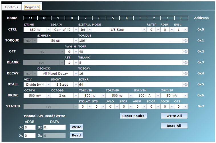

The datasheet for the DRV8711 explains this in much detail. But it's easier to use the demo application for the BoosterPack. It shows on-screen what values are set i  the register.
You can see - and change - how the motor behaves and validate the register settings directly in that app.
