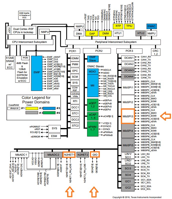

In the fifth post I check what peripherals should be used to drive the DRV8711 from the Hercules RM57 safety microcontroller..

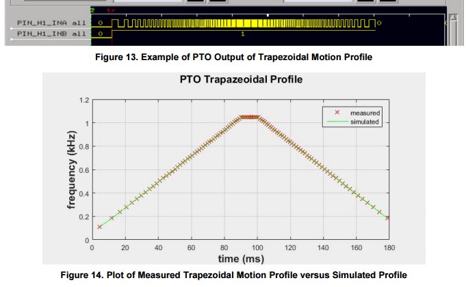

Side note to self: this (found when writing the blog image ) Pulse Train Output application note from TI may contain most of the PWM code.
If that's true, it may be an unexpected windfall.
I was afraid to start programming the NHET subcontroller with the HET assembly language. It's been my weak point since as long as I work with the Hercules family.
I haven't checked the document in detail but it looks promising ...

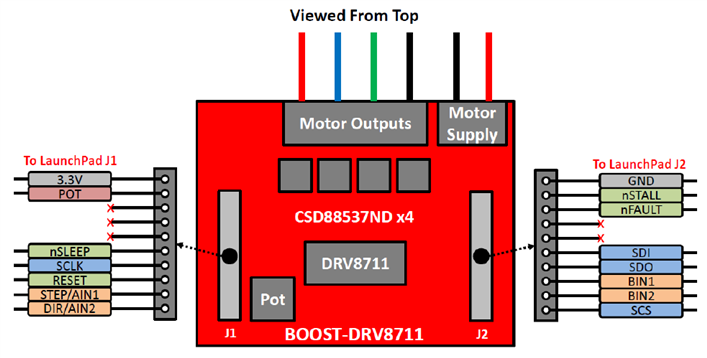

DRV8711 BoosterPack pins
The critical ones are the SPI pins (SCLK, SDI, SDO, SCS) and the PWM pin (STEP/AIN1).
The green pins and DIR/AIN2 can be handled with any pin that's GIO capable.
3V3 and GND are standard, not to worry.
I don't need the potentiometer input and the BIN pins.

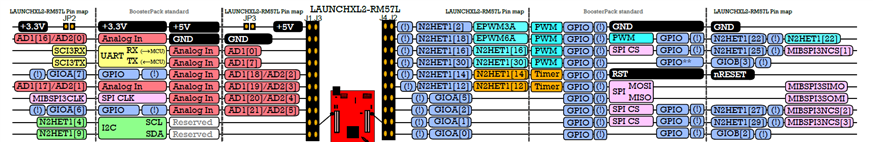

Hercules RM57 LaunchPad pins
Good news. A match for many. This is not that common with Hercules Launchpads. They defer often from the BoosterPack layout (deliberately not using the word standard here).
The match table below shows where I am confident and where more investigation is necessary.
BoosterPackFunctionRequirements for HerculesHeader 4
3.3V
nSLEEPtell driver to sleep (no current to the stepper coils)GIO out
AD1[17] or AD2[0]
SCLKSPI clockSPI clockMIBSPI3CLK
RESETreset driverGIO outGIOA[6]
STEP/AIN1PWM inputHET / PWM outNHET1[4]
DIR/AIN2motor directionGIO outNHET1[9]
GND
nSTALLis the motor stalled?GIO inNHET1[22]
nFAULTis the driver in error state?GIO inNHET1[[25] or MIBSPI3NCS[1]
SDISPI Slave in Master outSPI MOSIMIBSPI3SIMO
SDOSPI Slave out Master inSPI MISOMIBSPI6SOMI
SCSSPI chip select (active high !)SPI CSGIOB[2]
My main worry is the nSLEEP pin. I'll have to read the doco to see if I can render an analog input into a digital output.
I don't understand why this particular pin is used on the BoosterPack for a signal that has to be driven by the microcontroller.
On the BoosterPack standard, this is reserved for analog in signals. The pin above that is a generic IO pin. And its free. Why?

    It seems that I can't turn the ADC pin that's connected to nSLEEP as a GIO output. Except for the ADC event pin, the module isn't configurable as GIO.
    External event pin (ADEVT) programmable as general-purpose I/O
    That means that I'll have to hack the BoosterPack. The pin above the ADC is a GIO.
    I've just double-checked with a meter that it isn't connected to anything.
    So I can put a bridge between J1 PIN 5 and 6 on the BoosterPack.
    Then I can drive the GIO pin high or low as needed. The ADC pin won't mind. It can have 3V3 without issues.
    I'll use a male pin header and hack that onto the connector pins. I can then use a jumper to make and break.
