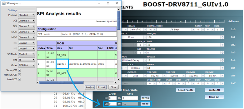

The image below is a capture of setting the driver using the TI demo application for this motor.

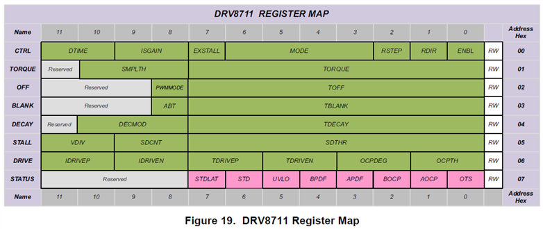

You see 8 blocks of commands, each writing to a particular register. The register map from the DRV8711 datasheet shows what each of the controls:

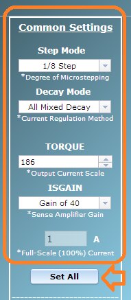

The GUI of the demo app gives an easier view - and you can change and read them directly from the app.

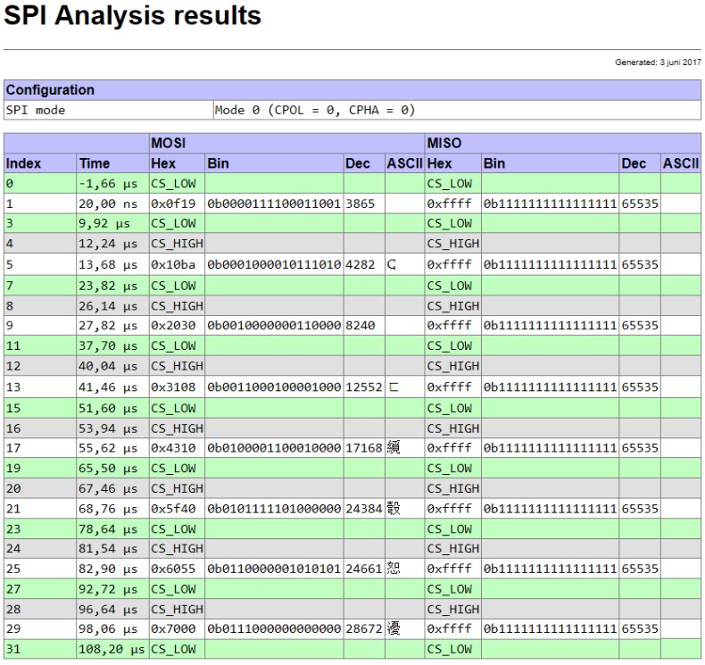

The SPI capture from my protocol analyser shows the result of shooting the following init settings:
Full output of the analyser (ignore the MISO columns, there's only traffic from MSP430 to DRV8711 in this scenario):
SPI Analysis results

The column of interest is MOSI - in the Hex or Bin format of line 1, 5, 9, 13, 17, 21, 25 and 29.
Compare those with each register's explanation in the DRV8711 datasheet to get what's happening.
