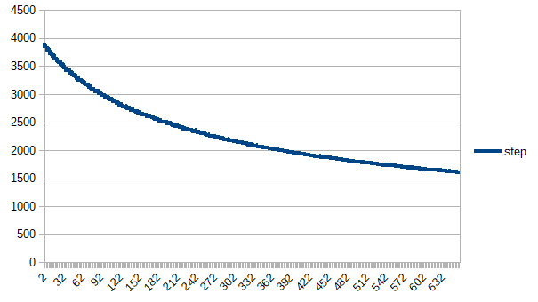

In the fourth post I check the PWM signal that the MSP430 generates for the ramp-up, steady and ramp-down stages. And what it does when you ask for a fixed number of steps.
MSP430 Generates Period-modulated PWM
(somehow this title sounds recursive, I'm open to a better suggestion)
The typical way we deal with PWM is using duty-cycle modulation.
For this application though, where we're trying to ramp up a stepper motor gradually, period modulation is needed.

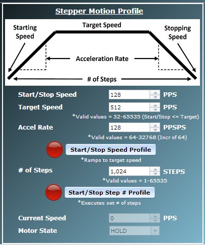

The image below is a capture of the PWM that the MSP430 timers generate to ramp up the motor from stance,
with 128 pulses per second as start speed, 512 PPS as stable speed and an acceleration rate of 128.
(click the image to see it at a useful size)
You can see that the time between the pulses is decreasing - the motor is speeding up.
The capture doesn't have the full reach from start to end - I ran out of logic analyser memory.
It's good enough to show the ramp-up though.
When the motor starts, the time between two level shifts is 3925 ns. So approximately 7850 ns for a full pulse (a PWM *** has two level shifts).
That matches with the initial setting of 128 PPS (the theoretical value is 7812.5 ns). The timer outputs 127.39 pulses per second at the start.
After 1 second, the time between two pulses is 2006 ns (see the attached spreadsheet). The time for a pulse = 4012 ns. So after a second the MSP430 outputs 249.25 pulses per second.
At this point I give up on the math. I leave it to the reader to check if an increase from 128 to 250 pulses is an increase rate of 128 (because I am old and my brain blocks right now image ).
