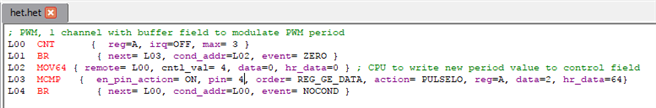

Today I just want to see if I can get a HET program assembled and linked into my code, and have a HET pin generate a PWM signal.
The program is a little more complex than it can be, because it allows for flexible period - something we can ignore here.
; PWM, 1 channel with buffer field to modulate PWM period
L00  CNT      {  reg=A, irq=OFF, max= 3 }
L01  BR        { next= L03, cond_addr=L02, event= ZERO }
L02  MOV64 { remote= L00, cntl_val= 4, data=0, hr_data=0 } ; CPU to write new period value to control field
L03  MCMP   {  en_pin_action= ON, pin= 4, order= REG_GE_DATA, action= PULSELO, reg=A, data=2, hr_data=64}
L04  BR        { next= L00, cond_addr=L00, event= NOCOND }
Don't try to understand this unless you want to learn the assembler language. A manual is available from TI's Hercules product page.
The only thing that's interesting for this exercise is knowing that this code will generate a 234 kHz PWM with 50% duty cycle on HET pin 4.

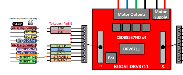

I've chosen PIN 4 deliberately because that matches the stepper pin of the DRV8711 Stepper Driver BoosterPack.

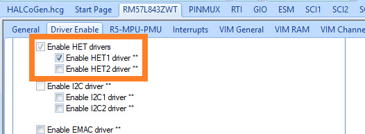

Like the other modules, HET is configured in HALCoGen. First thing to do is enable the driver:

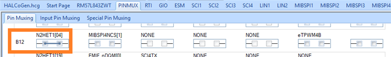

This will take care that HALCoGen creates the driver code for the timer. Then we set the PINMUX so that NHET1 pin 4 is active.
(not really really needed because it's the default assignment for the pin, but it helps finding conflicts later on)

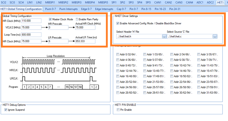

On the NHET module itself, you define the frequency, and say that you want to use HET assembly.
(This module can also be configured as a straightforward PWM generator without programming)
The .h and .c files that we select here are the ones generated by the HET IDE when you pressed the assembler.
When you press the HALCoGen "Generate Code" button later on, thes files will be copied into your Hercules project code.

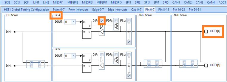

The last step in the HET configuration pages is to make HET1 pin 4 an output pin:

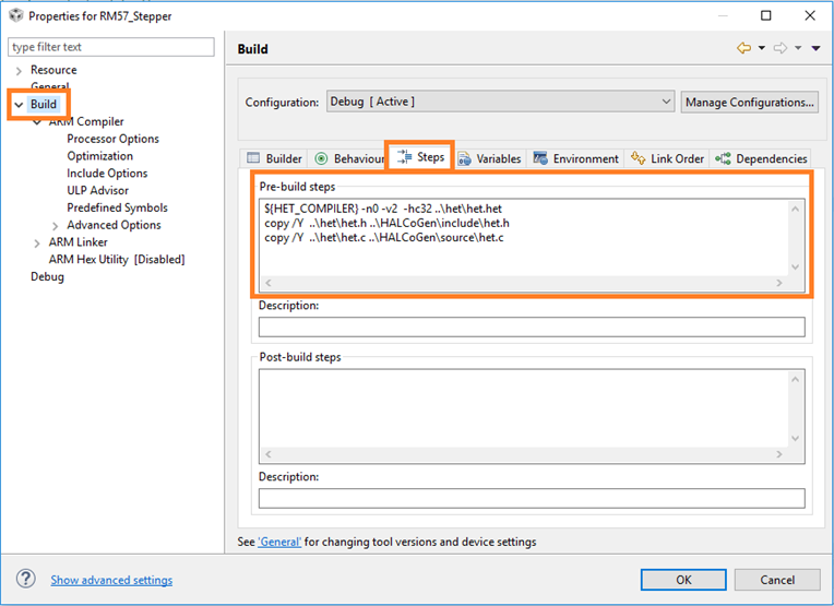

I prefer to minimise the number of manual steps when building a firmware binary. If at all possible, no manual steps, so that a build is repeatable.
In this case it is possible because the HET suite for the Hercules come with a command line assembler.
In CCS, you have the option to add commands before or after a build, so that's a perfect location to put these.
I have created my HET IDE project in the het subfolder of the CCS project.
For some reason, the build steps are executed from a folder one level in the project (too lazy to find out which one), so we have to prepend all folders with  ..\.
The first line assembles the .het source into  .c and .h files in the het folder:
${HET_COMPILER} -n0 -v2  -hc32 ..\het\het.het
The next two lines copy the .h and .c into the HALCoGen project source:
copy /Y  ..\het\het.h ..\HALCoGen\include\het.h
copy /Y  ..\het\het.c ..\HALCoGen\source\het.c
That's all. A little bit of scripting automates the whole thing. The results can be found back in the console after build:

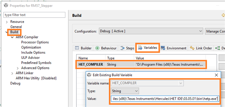

I've registered the HET command line tool in a project parameter, so that the script is PC independent:

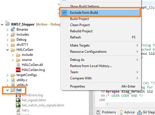

A last point of attention: if the HET project is a subfolder of your CCS project, you'll have to exclude it from compiling. Else you have the het.c file twice in your build and it'll fail.

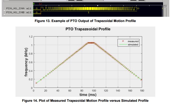

The end-game is to get a signal like this out of the module, based on a ramp profile that we define.
