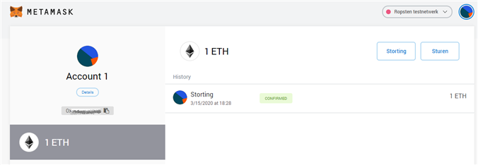

Get a 1 ether Test Coin in your Wallet
Then open a new tab to https://faucet.metamask.io/
When you click on request one ether from faucet, it asks to log on to your metamask wallet and then creates a transaction id for 1 ether.
When you (right-)click on the transaction URL, you navigate to the ropsten test website and see the status.
When that page confirms success of the transaction, the 1 ether is in your wallet.

    My balance after the transaction:
    oldest transaction was the 1 free (yet worthless) ether.
    Then I moved 0.1 of that to the smart card*, and that costed 0.000042 ether.
    I now have 0.1 on that card and 0.899958 ether left in the MetaMask wallet.
    * the coins aren't on the card. Not even stored on there. The coinfinity app uses the cards keys to go and retrieve the ballance of the account related to that key.
