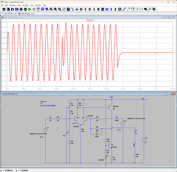

  • michaelkellett
    michaelkellett 5 months ago in reply to michaelkellett
    Here's an alternative diff amp - looks amazingly like the power amp with some bits removed !
    10 cycles of one input, then 10 of the other - note phase change at the switch over.
    MK

    shabaz 5 months ago in reply to michaelkellett
    I thought I'd give the difference amp a shot.. Q1 and Q2 are probably not needed since I'm taking the output from the non-current-mirrored side, but I figured I'd leave them in there, because some applications may want a lot more gain. With the diagram as shown, the gain is about 10 dB, but if taken from the other output, it is more than 30 dB (too much for the requirement).
    The circuit is powered from 8.5V. The current sink is approx 2 mA, and is compliant down to about 1.9V.
    The blue signal is the output when there is a signal on one input only. I think there is some instability however, since if you look closely at the blue signal just after the peak, there is a bit of distortion, so something may be oscillating... don't know what!
    Frequency response is good:
    Distortion is low:
    DC voltages and currents:

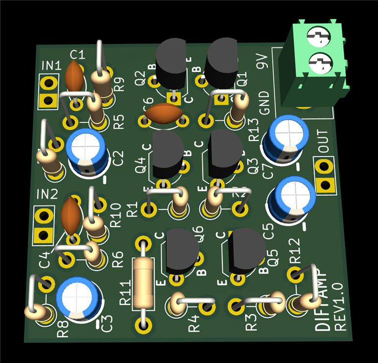

    Thanks for that! I laid out my attempt last night:
    Despite suspecting it may have instabilities, I figured it could be interesting to debug.
    I'll lay out a similar sized PCB for your design, since that will actually function!
    By coincidence all these amplifier circuits so far are just the right amount of components to fit on tiny 40 x 40 mm boards without components being too squashed together.
