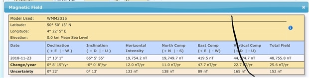

    Have you tried to calibrate out hard and soft iron interference? Because from your data it seems there is some present. If you are in Belgium you should be getting total magnetic field of around 49 uT…

    Have you tried to calibrate out hard and soft iron interference? Because from your data it seems there is some present. If you are in Belgium you should be getting total magnetic field of around 49 uT with inclination of 66 deg. You can check magnetic field data for your exact GPS location at:
    https://www.ngdc.noaa.gov/geomag-web/#igrfwmm
    From your data I'm getting total length of magnetic field vector ( =sqrt(x^2+y^2+z^2) ) from 48.3 uT to 87.1 uT.

    Jan Cumps over 8 years ago in reply to kulky64
    There is an iron molecule in my neighbourhood image
    Here’s the calculation:
    I can compare with a micro:bit.
  • kulky64
    kulky64 over 8 years ago in reply to Jan Cumps
    Then assuming properly identified and corrected hard and soft iron distortion you should be getting total length of magnetic field vector around 48.7558 uT in any orientation of the sensor.
