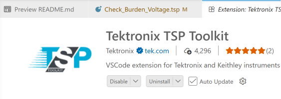

TSP Toolkit for VSCode
Tektronix released version 1.5 of their VSCode TSP plugin. It supports TSP script development from the IDE, and gives you some remote control options.

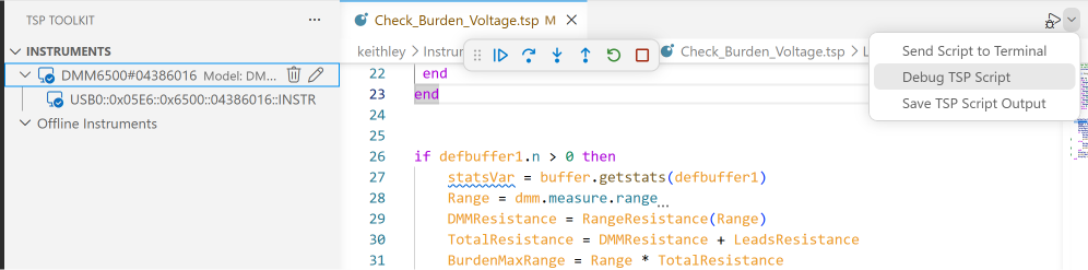

Execute and Debug

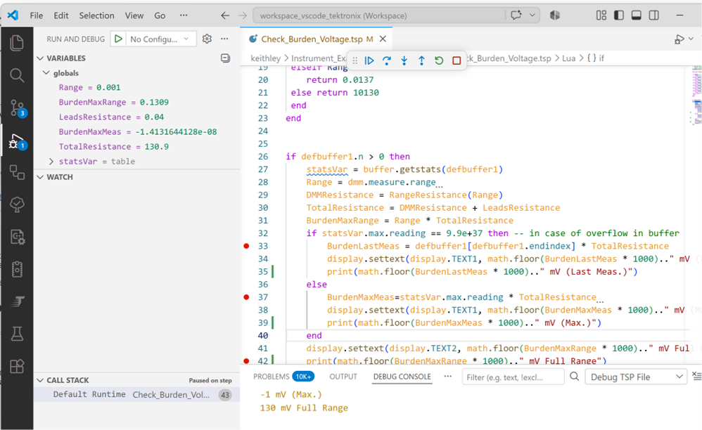

The plugin allows you to execute the code directly on your DMM. Text output and error messages are routed to the VSCode terminal window.
Remote debug is also supported. You can load the script in the DMM6500's memory and then step through the code. Variables and watch expressions are supported. For both options, the DMM has to be reachable from your development PC. More on that in the next section.

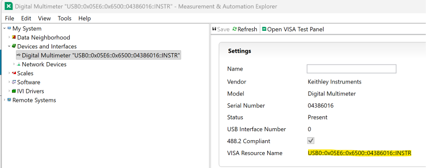

The plugin lets you connect to your instrument. This is not really an option. It's required to be able to do anything useful. The easiest way to connect, is when you know the VISA connect string of your instrument or its IP address. This version of the toolkit supports USB and tcpip connected devices. For this review, I connected a DMM6500 via USB, and used the connect string I retrieved from my NIVisa install:

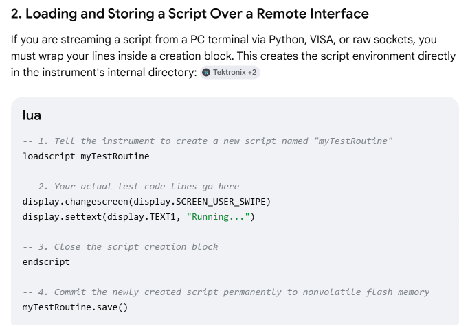

What I didn't find: an option to permanently store scripts on the DMM's disk. This is supported by Lua commands, though. So you can use the VSCode terminal to store a script.

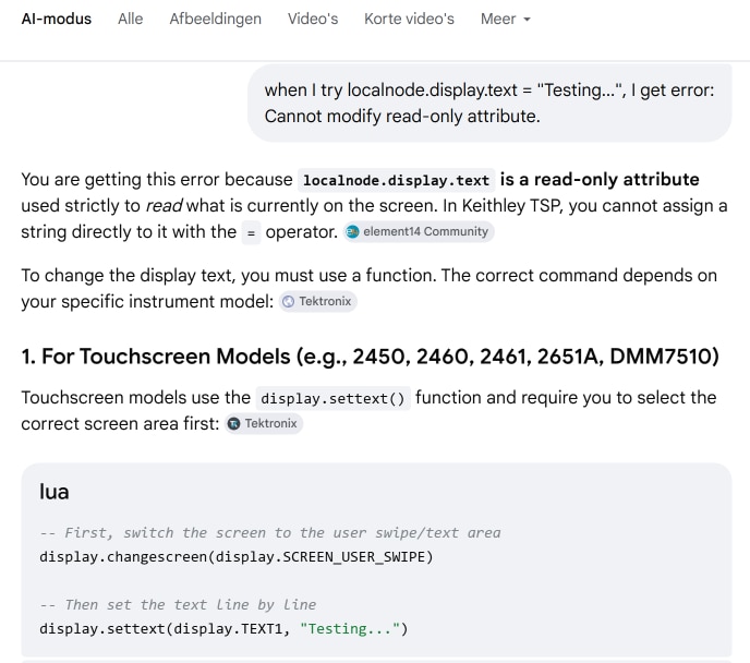

Don't know TSP or Lua? Google AI does.
