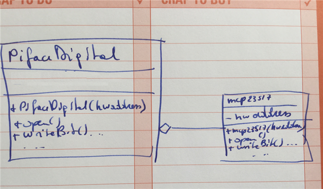

API and Abstraction
I've used exactly the same level of abstraction as the PiFace official procedural API.
The OO API you talk to is the one that knows the PiFace Digital hat inputs and outputs.
That API depends on a separate more low level OO API, the one of the SPI port expander used on the hat (MCP23S17).
I've turned each of these into a class. The PiFace Digital functions are served by the PifaceDigital class.
The mcp23s17 class supports the SPI port expander's functions.
What's different is that the in the original PiFace API, all functions are static. They have no context.
In my OO API, both objects are aware of the hardware address of the PiFace Digital hat (more subtile: the mcp23s17 object knows, and the PifaceDigital object is hard linked to that object).
For the programmer, the difference is that, in the traditional API, you pass the hardware address of the board to each function.
If you have multiple hats, you pass the correct hardware address whenever you want to address a particular one.
In my OO API, you create a PifaceDigital object for each hat. In the constructor, you give the hardware address so that the object knows which hat it represents.
From then on, to talk to a particular hat, you use the object that presents that one. No need to deal with addresses anymore.

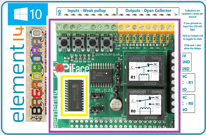

I like it when my classes represent real world things. In this case the match is 100%.
image source: the icon of one of Robert Peter Oakes' youtube videos.
The hat (purple rectangle) is the PifaceDigital class. The SPI port expander (yellow rectangle) is the mcp23s17 class.
Just like in my API, a hardware hat owns exactly one port expander, and the hat routes the traffic to-and-from it.
Because the physical hat can't work without one single SPI expander (the mcp23s17s IC is soldered on it, you can't get more entangled than that) , I construct them together in the API and destruct them together too.
They share the same lifespan.

You can see that the class does not store the hardware address. Instead, it dynamically creates an mcp23s17 object and passes the hardware address to that.
Because our class only has one mcp23s17 object, the right commands will go to the right hat.
The connection between a PifaceDigital object and its mcp23s17 is made at construction time:
PifaceDigital::PifaceDigital(uint8_t hwAddr) {
_mcp23s17 = new mcp23s17(hwAddr);
From that moment on (and there is no earlier moment in this object's life cycle), the two objects are bound together.
The PifaceDigital object can talk to only one mcp23s17 object.

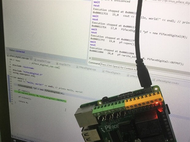

Talking to a hat is easy. Create it, open it and then talk to it.
When done, dispose of the object.
    PifaceDigital *pf = new PifaceDigital(0);
    pf->open();
    pf->writeBit(1, 0, PifaceDigital::OUTPUT);
    pf->close();
    delete pf;
In the above exampe, the program creates an object to represent (i.e.: binds to the hardware of) a PiFace Digital with address 0.
It then opens (initialises)  the communication, sends a command (sets output #0 to high), then closes the communication.
It then disposes of the object. The program doesn't hold any resources to that particular hat anymore.
