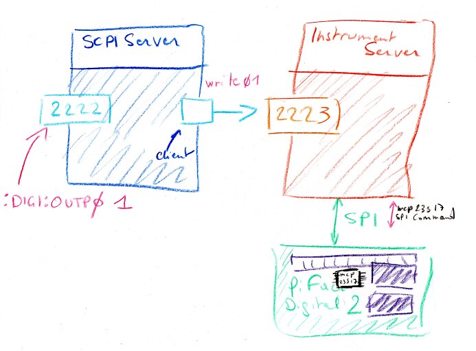

I'm building a SCPI electronics lab instrument for Linux.
This post connects the C SCPI parser service together with the C++ Instrument service.
I've split up the SCPI interpreter and the instrument control for my own learning. I'm trying to use daemons on a linux SOB that talk together.
I could have used named pipes, messages or file structures to let them interact but I've used sockets. Critique in the comments please.
What Came Before and Linking Things Together
In the previous posts I've shown the SCPI parser (a C program) and the PiFace controller (object oriented). The two worked on their own but not together.
Both programs are TCP/IP servers. They listen on a port and react on traffic arriving.
The SCPI server reacts on SCPI commands it receives over the network.
The Instrument server reacts on GPIO commands it receives.
I've added a TCP/IP socket client to the SCPI server. Whenever it receives SCPI commands that have to be executed by the PiFace Digital, it translates them and sends instructions to the Instrument server's port.
It waits for the instrument's feedback and returns SCPI replies based on that.
Currently it knows how to control the outputs of the PiFace Digital.
The SCPI parser listens for this SCPI command:
DIGItal:OUTPut# TRUE|FALSE
If it retrieves such a command, it sends the Instrument service the instruction to set the requested output pin high or low.
If you send DIGI:OUTP0 1, it will send write01 to the Instrument port.

int sendToInstrument(char *buffer, size_t size) {
  //Send instruction to instrument
  buffer[size-1] = '\n';
  if( send(cs_socket_desc , buffer , size , 0) < 0)
//  if( send(cs_socket_desc , "hello, world!\n" , 14 , 0) < 0)
      puts("Send to instrument service failed");
      return 1;
  //Receive a reply from the server
  if( recv(cs_socket_desc , buffer , size , 0) < 0)
      puts("Receive from instrument service failed");
      return 1;
  return 0;
The Instrument server will know (because I've programmed it) that when it retrieves a write command, that the next two characters are the pin and value.

    Jan, How very timely - a friend mentioned SCPI to me just this week, so I'm looking forward to reading through this series you've been posting in depth to try and learn some details. Rod
    Jan Cumps over 8 years ago in reply to 14rhb +2
    If you want to dig deeper in SCPI, the electronic load we're building here on element14 may give a completer overview: Programmable Electronic Load . That one has a rich set of SCPI commands. The source…
