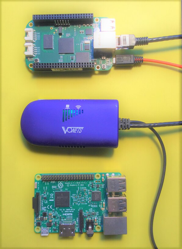

I'm building a SCPI shell for Linux.
I have the basis working over TCP/IP on a Raspberry Pi and a BeagleBone.
In this post I'll show the basics: the Pi or BB listens to SCPI commands and sends replies.
I'll include the LabVIEW test bed that I used to get this working.
In this series, I'm focusing on the specifics for TCP/IP communication with a SCPI service. I will not make an instrument but this project can serve as the basis of a SCPI programmable Linux device.

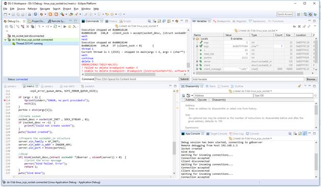

I've written the program in C. It uses common, fairly stable Linux libraries and uses them in shared object mode, so there's no hard dependencies on Linux version.
Because of that, it also cross-compiles and debugs straight away from the Arm DS-5 Community Edition IDE.

The main function is very straightforward. Init our SCPI library and prepare the program to act as a server side Socket listener.
int main(int argc, char *argv[]) {
  int c, read_size, portno;
  struct sockaddr_in server, client;
  char client_message[2000];
  signal(SIGINT, sig_handler);
  SCPI_Init(&scpi_context, scpi_commands, &scpi_interface, scpi_units_def,
  SCPI_IDN1, SCPI_IDN2, SCPI_IDN3, SCPI_IDN4, scpi_input_buffer,
      SCPI_INPUT_BUFFER_LENGTH, scpi_error_queue_data,
      SCPI_ERROR_QUEUE_SIZE);
  if (argc < 2) {
    fprintf(stderr, "ERROR, no port provided\n");
    exit(1);
  portno = atoi(argv[1]);
  //Create socket
  socket_desc = socket(AF_INET, SOCK_STREAM, 0);
  if (socket_desc == -1) {
    printf("Could not create socket");
  puts("Socket created");
  //Prepare the sockaddr_in structure
  server.sin_family = AF_INET;
  server.sin_addr.s_addr = INADDR_ANY;
  server.sin_port = htons(portno);
  //Bind
  if (bind(socket_desc, (struct sockaddr *) &server, sizeof(server)) < 0) {
    //print the error message
    perror("bind failed. Error");
    return 1;
  puts("bind done");
Some of the functions called here, like signal() and SCPI_xxx(),  I'll discuss later on in this post.
But for now, you can follow the main flow. When this code has executed, our SCPI library is initialised and the server is ready to start the listen and reply cycle.

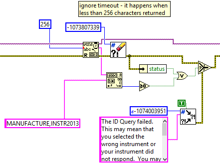

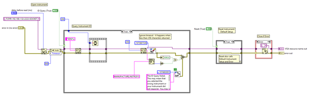

LabVIEW Test Bed
The code isn't production ready yet, but good enough as a test bed. It sends the *IDN? command to the Linux device and validates the return value.
The IP address and port are fixed here but that's not the end state.
One thing to look at is the Read block.
I've added an error handling block to discard TCP/IP timeouts. I have this issue that when the reply is less than the byte count passed to the read block, it tims out.
I've tried to check the number of bytes waiting for read, and to implement the termination attribute for the VISA connection, but both constructs are flagged as unsupported at runtime.
So I've decided to overrule the timeout error.
If this gives an issue (it doesn't in the current test bed because there are further checks that validate the data), I can improve this construct.
The great thing is that it works.
