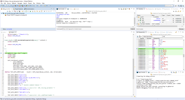

I'm trying to build a SCPI shell for Linux.
I'd like to have it working over TCP/IP on a Raspberry Pi and a BeagleBone.
tl;dr It works. The rest of the blog series explains how to build a lab automation device that controls 8 outputs (2 of them relays), and read 8 inputs. With a Raspberry Pi and a PiFace Digital (2).
Here on element14, we've been playing with SCPI and microcontrollers. We have several instruments working on MSP432, Arduino and Hercules devices.
This time I'd like to get a Linux instrument up. To get some device independence, I'll try to make the source work on two different boards with different distros.
The program is expected to run as a background process.
I have a head start. My favourite SCPI library has a LwIP SCPI server example.
A relative head start, that is, because I have to find out how to get all the dependencies - I want to develop on a Windows PC image.
If this project fails, it'll be because of my develop for Linux skills.

    Yay! It works. Above is the capture of a LabVIEW back and forth communication - with the Raspberry Pi as a VISA TCP/IP device. *IDN? command sent, and the reply from the Pi arrived at LabVIEW.

    Jan Cumps over 8 years ago in reply to Jan Cumps +3
    what's not working ok: even though I get a reply, the Visa Read block in LabVIEW throws a timeout error. when I close a connection (regardless of telnet, LabVIEW), the service on the Raspberry Pi goes…
    I had a read on the timeout. It happens when the expected numbers of characters haven't arrived after the given timeout.
    Because TCP/IP in VISA doesn't support querying the number of characters waiting to be read (I've tried and I get Not Supported by this instrument), I have made this decision:
    After reading from the TCP/IP pipe, throw away that particular timeout error, because it is expected. Comment f you would do this differently.
