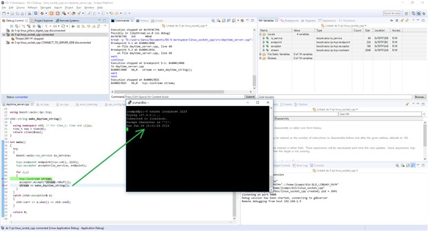

This is how a C++ TCP/IP socket server looks like:
  try
    boost::asio::io_service io_service;
    tcp::endpoint endpoint(tcp::v4(), 2223);
    tcp::acceptor acceptor(io_service, endpoint);
    for (;;)
      tcp::iostream stream;
      acceptor.accept(*stream.rdbuf());
      stream << make_daytime_string();
  catch (std::exception& e)
    std::cerr << e.what() << std::endl;
(I changed the port from boost's example from 13 to 2223, because 13 is in a range that needs elevated rights (sudo) access)
The program above is just an example. It accepts a request. Upon connection, it sends the current time.
Because the loop creates a new stream each time, the original connection closes and you get a new one.
