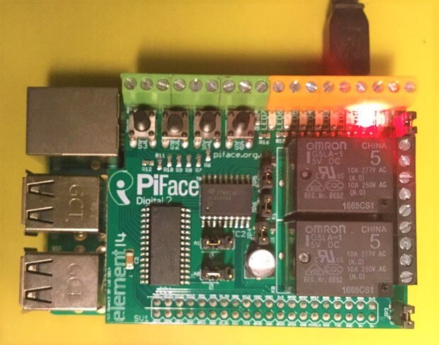

This morning I received a PiFace Digital 2PiFace Digital 2 from element14 (thank you!)
This board, with digital inputs, outputs, relays and LEDs can be a nice LAB automation utility.
In this post I check if I can control the PiFace Digital 2 via C.
TL;DR yes

PiFace Digital 2
This Pi hat is a port expander that gives you 8 digital inputs and 8 outputs, 4 buttons, 2 relays and 8 LEDs that you can control from your Pi.
Communication goes via SPI.

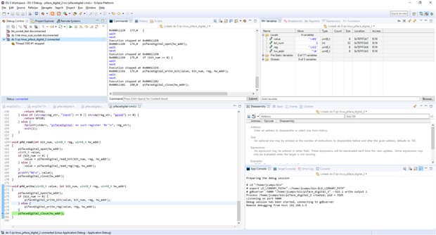

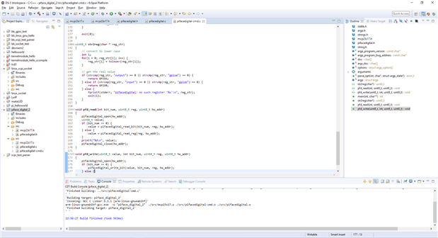

That was easy too. Piface has example code on their github.
You need the c and h files from these two repositories:
libpifacedigital
libmcp23s17
Both come with a makefile and you can build them right away on your Pi.
I'm developing on a windows computer and cross-compile for Linux, so I've created a project in the ARM DS-5 IDE.
This allows me to interactively debug the program from the windows PC.
As you can see on the photo at the start of the blog post, I was able to control a LED. I've also tested a relay.
Here's an action shot of the debug session:

    I’ve checked the hardware on the hat:
    8 digital inputs (can all be turned into outputs)
    8 digital outputs, open collector, each with LED in parallel.
    2 relays with snubber, each sharing one of the outputs. They can be disconnected.
    I/O is buffered, not isolated.
    For isolation, the two relays can be used. up to 20 V.
