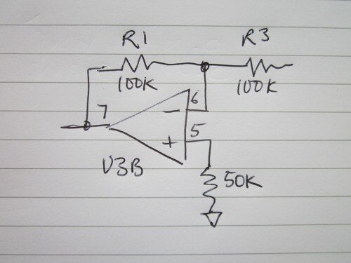

    For the inverting amplifer U3B, lift the non-inverting pin and connect a 50k resistor from the pin to ground. (If you don't have a 50k 1% resistor, use two of the 100k ones in parallel.)  That gets you this
    the output of U3B should now be much closer to the gain of -1 and with 0.108V going in should read within a millivolt or two of -0.108V. At least that's what theory says. Try it and see.
    To understand why it works, look at the line above the one I highlighted on the datsheet (offset current). That's saying that, although the bias current is fairly high, the difference in the bias current of the two inputs is quite small (no more than one part in a hundred - less than 1%). That comes about because, although the bias current is the base drive to a transistor and is a bit variable  (it will vary from batch to batch), the transistors on a particular chip match very well in their characteristics (because they're all fabbed together). That matching can be made use of.
    For this part, the bias current is out of the input pin (it's the base current of a PNP transistor). When it flows through whatever resistance is connected to the pin it generates a voltage. If the resistance seen by both inputs is the same, then those voltages will be the same (we don't know precisely what the voltage will be, because the bias current varies quite a lot, but we do know that both inputs will see a very similar additional voltage because the currents match well). Since the two inputs are difference inputs, the two voltages will then pretty much cancel out as part of the normal action of the op-amp.

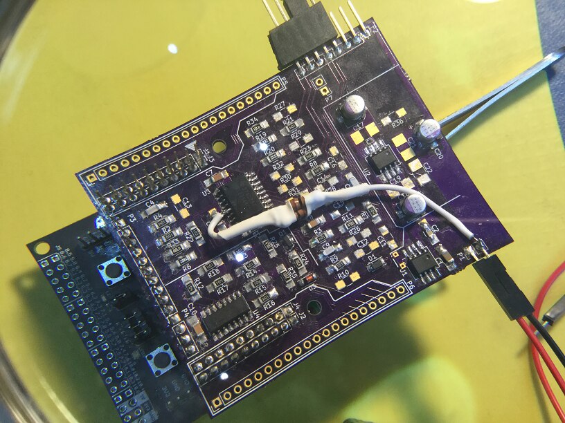

    I have added the 50K from non-inverting input to ground of U3B.
    The voltage at that input is 0.051 V.
    On the output, it's - 0.106 V.
    Jan Cumps over 8 years ago in reply to Jan Cumps
    Bodging is done, I can now test the first part:

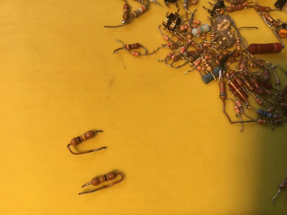

    Years of hoarding passives finally pays off:
    started ... can you believe that I just have one 100K left.
    Maybe it's time to buy one of those SMD resistor kits that you can backfill when stock runs out.
    Tomorrow I'll check in my stack of discarded PCBs if I can recycle something close to 50K ...

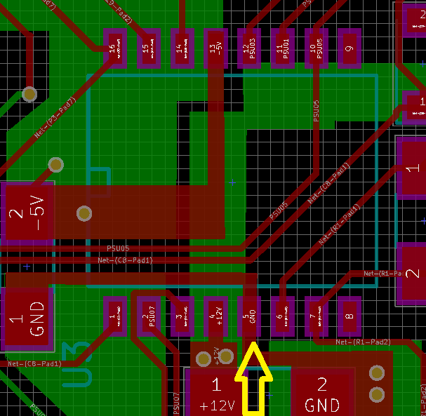

    note to self: lift pin 5

    A third option, that a textbook would give you, is to balance the input resistances. It's something that Jan could try quickly with what he's already built, if he wanted to.
