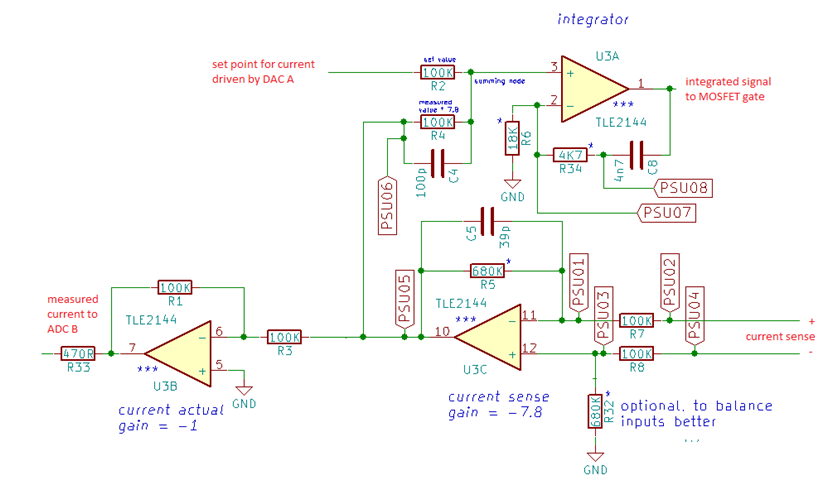

This blog documents investigates the feedback node of the electronic load that Robert Peter Oakes, jc2048 and Jan Cumps are designing.
It's an important spot in the load's design. It measures the set point and the feedback from the output.
When the output is driven to 0, it should be on a potential as close as possible to 0 V.
On the first prototype it's -0.2 V. Not so much off, but the negative value  influences our ADC measurements.
This document checks how we can get this node to 0 V.
Because this document is evolving, some comments below may be out of sync with the content. That's because the content is adapted based on the conversation.
The measurements taken here are based on the original design, without R32 in place and U3B + tied to ground.
The current sense side of R7 is connected to ground, and a variable negative voltage from 0 V down is applied to the current sense side of R8 to simulate current being sensed.
The circuit isn't complex. The set point is driven by a DAC. It's set to 0 for this test.
The second input to this node is OpAmp 3C. It has both inputs tied to ground so should theoretically have 0 V at the output.
On my board I measure a potential of -0.212V at the left side of R33.
I hope to get this closer to 0 V to ease the ADC a bit - its performance degrades with negative voltage at its inputs.

    To hopefully simplify things a little We have this, Upper op amp is simply to provide an inversion of the measured value back tot he ADC, hence the gain of -1 Lower right op amp measures the volts across…

    I've been studying up on the KiCAD schema editor some more, and was able to move the power part of the driver board to another sheet.
    This gives some more space to draw the opamps and I've restructured the diagram a little.
    It gives this view for the control loop and control feedback (edited picture to remove other components):
    I haven't added the option to replace the U3B + direct to ground with a resistor (50K, 2 parallel 100K resistors) to balance inputs.
    Let's see how your boards behave with or without these before adding them.

    Jan Cumps over 8 years ago in reply to jc2048
    jc2048  wrote:
    Does it still affect the other ADC channels (going negative by only 5mV) or is it going to be usable in normal operating conditions?
    The ADC seems to behave well up to at least -250 mV, and has errors on all channels when one input is below -700 mV. I haven't checked the in-between yet to find the tipping point - and haven't investigated the datasheet for this condition.
    jc2048  wrote:
    You've still got the problem with abnormal conditions - ie if someone connects the load output the wrong way round. Perhaps the way to deal with that would be to make it a 'perfect diode' circuit, though that wouldn't give you any warning that the output was connected wrongly.
    Yes, I will have to test what situations can cause negative values on ADCs in normal conditions too.
    jc2048  wrote:
    5mV error is a bit better than 200mV, so it's a definite improvement (worth having for two extra resistors). But it's only 40 times better and substituting an op-amp with bias currents maybe a thousand times less would give much more benefit.
    If you take a look at the datasheet above, you'll see that the voltage offset error is typ 0.5mV and may be more. Amplified by the 6.8 gain of the differential amplifier, that gives the potential for several millivolts of error at the ADC input. Saying it another way, the reduced bias current error is now around the same level as the voltage offset errors, which means, if you want to go further and try and make it even more precise, you're trying to work with (and disentangle) two error sources rather than just the one.
    An exercise for the future or for someone who wants to improve the design - and certainly an interesting one.
