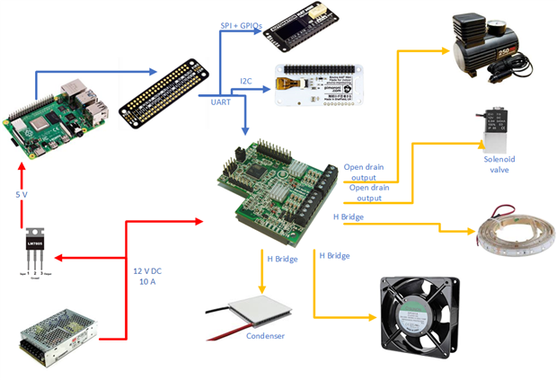

In this post I will note down the overall electrical design of this project.
The main components are
  • A Raspberry  Pi 4 board (included in the challenger's kit)

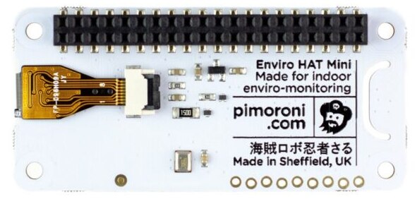

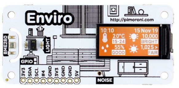

  • A PIM486 Enviro Hat (included in the challenger's kit)

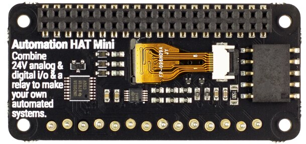

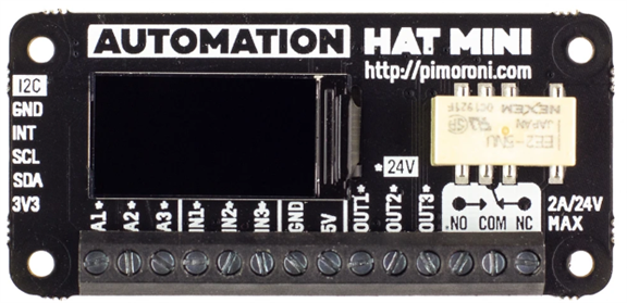

  • A PIM487 Automation Hat mini (included in the challenger's kit)
  • A PIM300 Pico Hat hacker (included in the challenger's kit)
  • A Gertbot for Raspberry Pi board
The above-mentioned components will
  • read Gr0G box environmental status (light, temperature, humidity)
  • Switch on and off the compressor
  • Open and close the solenoid valve to release the air/water mixture
  • Dim the LED strip(s)
  • Control the speed of the fan to cool down the box
  • Control the Peltier cell to reduce Gr0G internal humidity
Here is a diagram of the system with the components and their connections
Enviro Hat is connected to the Raspberry Pi board on the I2C (sensors - refer to https://pinout.xyz/pinout/enviro_plus . This is the pinout for the EnviroPlus, but the Enviro Hat is just the same board with less sensors). It provides a full set of sensors to monitor the Gr0G box. To have good readings, the board will be installed closed to the center of the cube

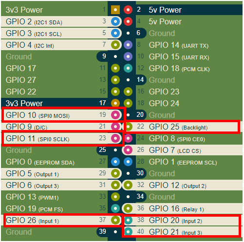

Sensors readouts will be displayed on the Enviro Automation Hat. We need to connected SPI bus to control the display and the GPIOs to read digital inputs in case I will install a keypad - refer to https://pinout.xyz/pinout/automation_hat_mini  for PIM487 pinout details
Raspberry Pi UART will be available for the Gertbot board
The signals required by the Gertbot board will be picked from the Pico Hat Hacker headers

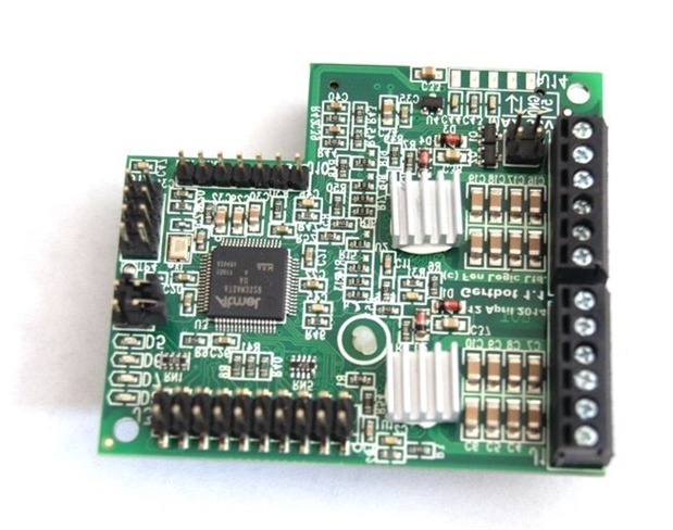

The Gertbot board actually requires just 3 signals (UART TX, UART_RX, ATT) plus +5V and ground, so soldering the wires should be an easy task.

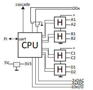

Despite the easy wiring, the Gertbot board is a quite powerful board. Here is a picture and its internal schematic
It features
  • A 64 MHz Atmel CPU
  • Four H-bridges capable of 2.5 A each
  • Two open drain outputs rated at 30 V and 3 A
  • Two Digital-To-Analog converters
  • Two Analog-To-Digital converters
  • Ten General purpose I/Os
This hardware capabilities will leave the design a lot a room for future expansions
The Gertbot was designed to drive stepper motors and similar robotics application (and, for this reason, a GUI is provided to simplify the configuration of motor steps) but nevertheless it is suitable for any application that requires driving power loads. As already mentioned, for this project I will use open drain outputs to switch on and off loads and H bridges to perform a PWM control of the power transferred to the loads

Open drain outputs
An open drain is like a switch. But you can only switch DC currents and you must connect a power supply to the drain pin (OD0 or OD1).
As you can see from the diagram above, there is no power available at the output. For an open drain output to work, the user must provide an external power source. The open drain output does nothing more than provide a path with a very low resistance to ground when it is switched on. There is no protection on the open drain outputs. So care must be taken not to exceed the current or voltage specification. Gertbot open drain outputs use MOSFETS transistors, which have the notorious habit of a large capacitive coupling from the drain to the gate. To prevent capacitive voltage spikes from blowing up the controller there is RC filtering between the gate and the controller.

    Hello James I can not stack the Pimoroni hats because (I suppose, because schematics are not available) I2C devices will generate address conflicts and because I need to install hats in a peculiar way…
    balearicdynamics over 6 years ago +1
    A so linear and neat project! Nice

    amgalbu over 6 years ago in reply to balearicdynamics +1
    It's linear now... I expect thousands of issues when I will start building the box!

    amgalbu over 6 years ago in reply to aspork42
    Hello James
    Raspberry Pi and Gertbot will be mounted on a plywood board, the Automation hat will on the opposite side of the plywood board (to make it visible to the user) and the Enviro hat will be installed at the centre of the cube
    So I will solder wires to the Pimoroni hacker board and connect the I2C/SPI/UART accordingly
  • aspork42
    aspork42 over 6 years ago
    It appears that you don’t have any pin conflicts which is great. How will you physically connect them all though? Pi hats don’t generally stack like arduino ones.
