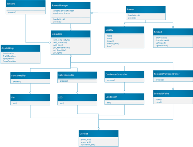

The picture below shows the classes being developed and their interactions
The main classes involved in the software architecture are
  • DataStore: stores a sensor readouts (both current and historical values). Currently I'm planning to keep all the data in memory, but the class can be eventually extended to handle a database
  • Sensors: handles the communication with the PiMoroni Enviro hat
  • ScreenManager: manages the navigation through the screens. Each Screen class implements two functions: update (to update the screen content) and handleKey (to handle the key press events). The ScreenManager keeps track of the current screen and reacts to the key event that the current Screen is not able to handle
  • Display: implements some user-friendly functions to make access to the PiMoroni Automation Hat's display easier
  • xxxController: implements the logic to control a specific component of the Gr0G box (fan, condenser, LEDs, solenoid valve). Each xxxController class has full access to the DataStore and can apply a control logic that can be customized and changed as the project evolves. Each xxxController also includes a class (Fan, LED, Condenser, SolenoidValve) that hides the details regarding the access to the physical board

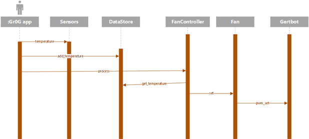

The diagram below shows how classes interact

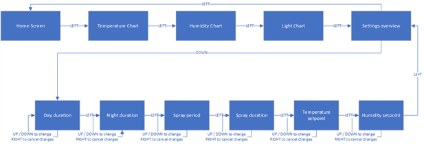

The screens I am currently planning to develop are
  • Home: shows an overview of the current box status (temperature, humidity, light)
  • Temperature chart: show a chart with the last 160 temperature readouts
  • Humidity chart: show a chart with the last 160 humidity readouts
  • Light chart: show a chart with the last 160 light readouts
  • Settings: shows the current settings, namely
    • Day duration: duration of the day
    • Night duration: duration of the night
    • Spray interval: how often the solenoid valve is opened to feed the plants with the air-water mixture. According to the literature, the best method to provide nutrients to the plants in an aeroponic system is to dispense at regular intervals. I will try this simple approach at first. Then, depending on the results, I will eventually implement a more complex algorithm
    • Spray time: the amount of time the solenoid valve stays open
    • Temperature setpoint: when temperature inside the box reaches the threshold, the fan is switched on to cool down. I did not provide an heater because I expect the starship environment control system to keep the temperature at a comfortable value. The only problem I foresee is that the electronic components inside the box may cause undesired raise in internal temperature that we must be able to cope with
    • Humidity setpoint: when humidity inside the box reaches the threshold, the condenser is switched on. To build the condenser, I will use a Peltier cell and a PC heat sink. The Peltier cell will cool down the heat sink and, as a consequence, the humidity will condense on the heat sink itself
