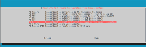

Disable serial console and enable UART
The internal serial console must be disabled to free the serial port for the Gertbot (as a matter of fact, Raspberry Pi communicates with the Gertbot board using the UART0, which is typically used as a Linux serial console).
By default the serial port on the Raspberry PI is configured for console input/output
To disable Linux serial console and enable UART, you have two options. The second option is actually less straightforward, but I like to understand what happens behind to scene and maybe someone could be interested as well
  • run raspi-config, navigate to Interfacing options, then Serial.
          When asked if you want to be able to access from a serial console, select No, When asked if you want to enable serial hardware, click Yes

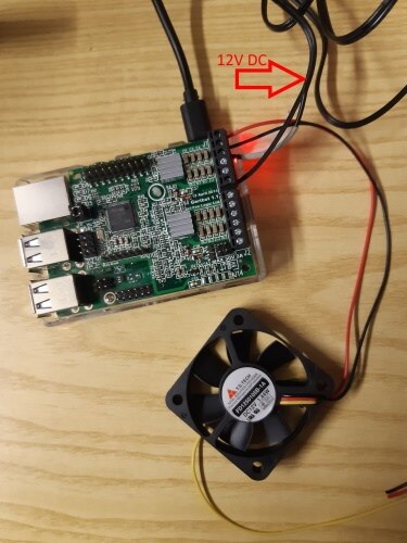

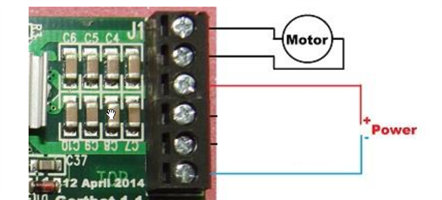

First application
I created a simple application to test PWM output. I connected a 12 Volt power supply and a fan
Then I downloaded the Python library from
https://www.gertbot.com/gbdownload/rev2.8/python_code.tgz
and untared the file
tar xzvf python_code.tgz
There are many samples included in the tgz file, but I will create a very simple application to get familiar with the library itself
I created a new folder for my application, and here I copied file gertbot.py from the folder where the library archive was extracted. Finally, I created a simple application
In this application, I simply
  • initialize the output
          gb.set_mode(board,channel,gb.MODE_BRUSH)
          gb.move_brushed(board,channel,gb.MOVE_B)
  • set the PWM frequency and the duty cycle to vary fan speed
          gb.pwm_brushed(board,channel,freq,dc)
  • switch off the PWM
          gb.set_mode(board,channel,gb.MODE_OFF)
Here is the result (I hope the fan speed is visible in the video)
Hooray! Another step in this challenge!
