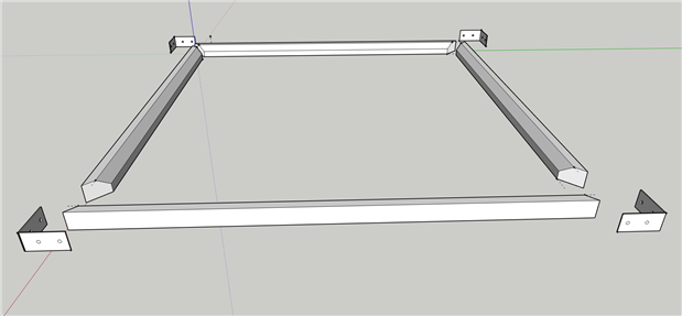

In this post we will finally start building the frame of Gr0G box
Building the top and bottom panels
Parts list
To build the top and bottom panels, you need
  • 8 pieces of bar with LED housing 46 cm in length with 45 degrees cut on both sides (when cutting, keep the LED housing facing upside)
  • 8 clamps. I got my clamps from an L-shaped 40 mm x 40 mm x 1.5 mm aluminum bar. I cut 8 pieces of 20 mm in height
  • Rivets (16, at least). I used 3 mm rivets, so I drilled the parts with a 3.3 mm bit
  • a 46 cm x 46 cm plexiglass
  • 8 M4 x 20 mm screws with bolts
How to proceed
  • Drill two holes for each side of the clamps (4 holes per clamp, in total). Try to stay on the middle of the clamp (see picture) because the section of the bar with the LED housing is irregular and you will get a better result if stay 10 mm from the border
  • Mate the clamp with the aluminum bars and fix the parts with 2 rivets per side
  • With a 4 mm bit, drill 2 holes for each edge of the frame, close to the corner in order not to interfer with the LED strip we will install later. Drill the holes close the inner edge of the aluminum bar or you will not have enough room for the bolt
  • Screw the screws and bolts
Building the four lateral panel
Parts list
To build the four lateral panels, you need
  • 4 pieces of bar with LED housing 50 cm in length
  • 4 pieces of L-shaped 30 mm x 20 mm x 1 mm aluminum bar 50 cm in length (referred as bar "A")
  • 4 pieces of L-shaped 20 mm x 20 mm x 1 mm aluminum bar 50 cm in length (referred as bar "B")
  • 4 pieces of 30 mm x 1 mm aluminum bar 50 cm in length (referred as bar "C")
  • Rivets. I used 3mm rivets, so I drilled the parts with a 3.3 mm bit
  • 4 50 cm x 50 cm plexiglass
  • 16 M4 x 20 mm screws with bolts
How to proceed
  1. Drill holes in bar "A" as shown in picture
  2. Mate the bar "A" with the LED aluminum bars and fix the parts with 2 rivets
  3. Drill holes in bar "B" as shown in picture
  4. Mate the bar "B" with the LED aluminum bars and fix the parts with 1 rivet
  5. Mate bar "C" with bar "A" leaving 20 mm from the edge of bar "A"
  6. Mate bar "C" with bar "B" leaving 20 mm from the edge of bar "B"
  7. Put the plexiglass in place and, with a 4 mm bit, drill 2 holes in bar "A" and two holes in bar "B"
  8. Screw the screws and bolts
