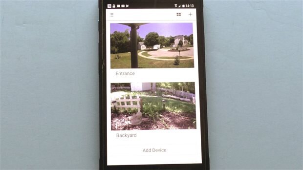

Figure 1 shows what the screen looks like when I have two cameras connected. Since my Internet bandwidth is too low to handle two cameras. I will turn off the Backyard for the demo.
   Figure 1.

Video 4 Demonstrates how the camera works. The video taken by the camera is jerky due to my Internet service as low bandwidth. Also, notice that the person's face is too dark to identify because it is in the shadows. This camera does not adjust when the background is bright and the object of interest is in the shadows.
