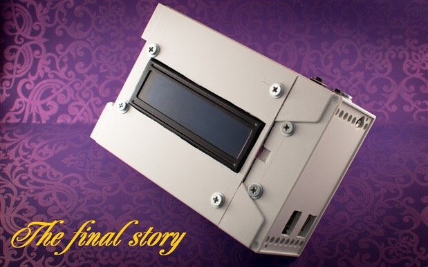

Experiments are certainly good thing, but the goal that Stranger had set before him was to fulfill the plan Minimum. Even without having any components from Farnell, Stranger, as mentioned above, could still build a full-fledged bike computer.
For one week an LCD display was connected to  FRDM-KW41ZFRDM-KW41Z and the possibility of outputting information about training was realized
An another week later, the computer was already in a fully operational state, all the main functions of the computer were implemented, as well as a set of special smart functions that Stranger uses during his training sessions.
Perhaps the reader is wondering what a typical Stranger’s training looks like. Here’s the answer to this question.
The first 20 minutes he goes at a low speed, sufficient to warm up muscles, then for a long time, and sometimes while the whole training (80-100 min), he goes at a normal rhythm. Here the most important thing is not to slow down, because you get used very quickly to a low speed and it will be quite difficult to return then to the previous tempo.
Sometimes Stranger prefers cyclic training: 20 seconds of slow riding, and then 20 seconds of fast riding, this rhythm is suitable when our hero does not have enough free time for full training. Another way to shorten the training time is to accelerate strongly on the last "leg", passing it (last 10 km) at the limit of physical abilities, but after such intensive training you can not stop immediately, you need to walk around the house for a while, otherwise the next day, it will be impossible purely physically to perform a regular exercise.
The problem with the above "smart" trainings is the need to constantly monitor the average speed, which is difficult to do with just a watch and a speedometer, so adding smart screens (called AST) has completely solved this problem!

The project is finished and all the stories are told, what is the result? Let us recall what our hero's plan was and briefly discuss what we managed to do in these 11 weeks.
There was a completely, carefully executed plan Minimum, in addition, there were fulfilled certain points from the plan Maximum:
  • an additional tension sensor added;
  • experience provided in generating electricity by rider’s muscle strength;
  • realized charging the smartphone from the bike computer.
An attentive reader will probably ask, but how was the charging of the smartphone realized, since the experience with the generator turned out to be unsuccessful? It's very simple: thanks to the sandwich of two  FRDM-KW41ZFRDM-KW41Z the bike computer has not 1 but 2 USB ports the first one is connected to a charger or PowerBank and to the second one you can connect a smartphone for subsequent charging The solution does not look as elegant as wireless charging however as it turned out Stranger’s smartphone does not have this function(wireless charging and even implemented in the project it would not be possible to test it
Neither a computer program nor a program for the smartphone were written, but this, as it turned out, was not needed: the received device (shown in photo at the beginning) has a standard Bluetooth protocol GATT CSC, which is supported by many mobile applications, which in turn can transfer data about training to a personal computer. This, by the way, was the reason why the computer does not have a pulse sensor installed – it is easy to connect such a sensor to the phone (for example, available at Stranger Xiaomi Mi-band 2) and use it together with a bike computer.
The only function that our hero did not have time to implement and regrets about it (note – this function was included in the list of options) is the function of automatic turning on / off audio on the smartphone. With this function, Stranger could go deeper into the world of literature, like the hero of one of Stephen King's works. However, let the benevolent reader cast aside doubts  – once, on a wonderful day this function will be realized!
