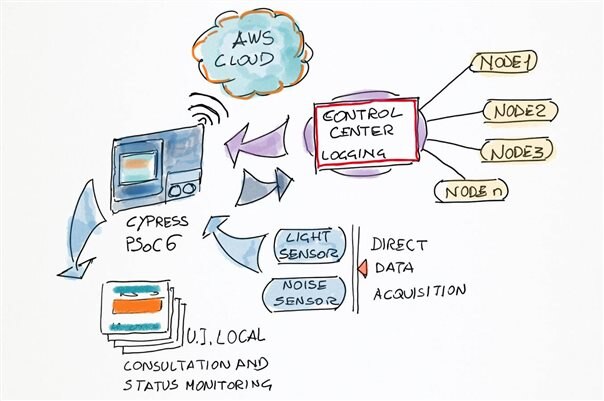

Conditioned by the roled of the PSoC6 Cloud Node the scheme below shows the software skeleton and the UI schema:
While the PSoC6 is one of the endpoints of the Super Smart Home IoT network its UI role is for monitoring and consultation only for which I planned to use the FTF screen included with the PSoC6 Kit. The application active part instead should connect in a secure way to the Raspberry Pi 4B Control Center receiving the log, buffered on one of the monitoring pages of the interface (there is not a story of the log saved locally, as it is already done by the Control Center), as well as sending its status to the Raspberry Pi.
The other active part is dedicated to the timed acquisition of the light level and noise level; these two environmental values are acquired and interpolated by the PSoC6 program while only the alarm triggered values – daylight and dark light changes, and over the preset limits of the noise level – are sent to the Control Center.
Both the logged statuses from the Control Center and the environmental sensor values are updated through the MQTT shadows to the  AWS IoT console to be displayed on the SiteWise web.

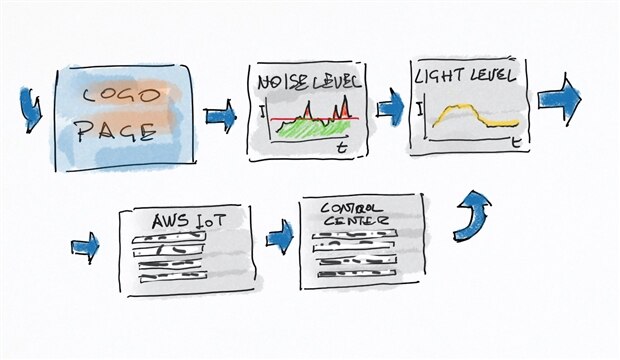

Display Monitoring Pages
The above scheme shows the strategy I adopted to monitor all the data through a simple user interaction; due to the reduced TFT screen resolution of the PSoC6 kit every group of data has been organized on a page (a single view of the TFT display). The pages are visible in sequence scrolling in both directions with the two Capsense buttons. Also if I plan to add more pages in the future it is not difficult to add others in the middle.

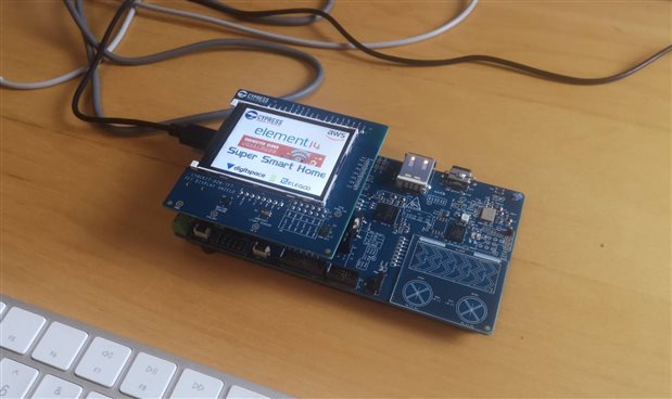

UI development has been the most complex part and I had to spend a full day to understand the logic to control the TFT display, very few documented in the Cypress Tools. The main page of the UI is the Super Smart Home graphic image; I discovered how to proceed with the UI design just when I tried to discover how it was possible to convert a bitmap to something usable by the device firmware.
The above image is the graphic screen for the first page (shown at power-on) I prepared and exported in PNG format at the TFT resolution (320x240 pixel). Digging on the net I finally discovered that the TFT display component – and only this, all the other parts of the same Arduino Compatible board are managed by the Cypress libraries – uses the Segger third-party components. It is included in the library configurator of the Modus Toolbox IDE but is undocumented by Cypress.

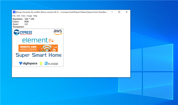

After discovering that it was this library my problem I investigated and found the emWin specifications on the Segger site. The documented API of the library, are available from the Segger emWin site, as well as in the document attached to this post.
Also in the same site emWin includes a lot of useful software utilities (Window only) to convert images, videos, and fonts in the format accepted by the emWin library. It is possible to access this stuff and download it for free only after registering on the Segger portal. Ther I found the bitmap conversion program to generate the code for the PSoC6 TFT display.
The above image shows the image conversion tool I have used to generate the graphic content shown on the main page of the PSoC6 TFT on boot.
Above: the final result, shown on the TFT display of the PSoC6 WiFi BT Pioneer kit.
