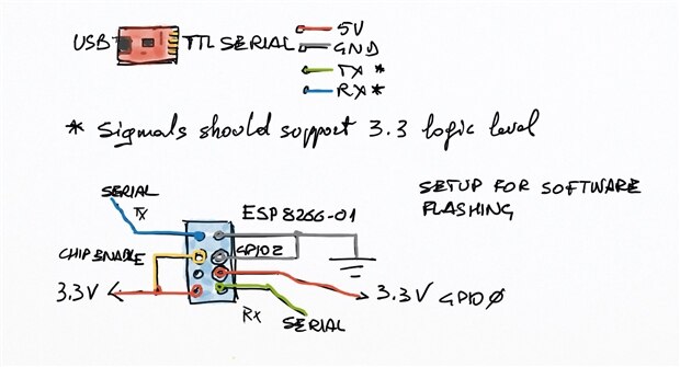

The ESP8266-01 is one of the smaller boards of the ESP family with only four GPIO pins (two of them are also used for serial TTL connection) but has a lot of powerful features on the WiFi side, as well as a considerable amount of memory. Thanks to the effort of the ESP8266 developer group and the popularity of the Arduino IDE it is possible to develop C software on this platform after installing the IDE extra component with the board manager (more details can be found on the ESP8266/Arduino GitHub repository). The issue I met was to find the right way to wire the microcontroller so it can be programmed with the Arduino IDE and a USB adapter on the computer.
To make a long story short, during the first week of tests I have found a series of issues that made me crazy (maybe more crazy!); the real problem is that you can find on the Internet an incredible quantity of different wiring schemes, circuits suggestions all partially working but not in a fully trustable way. After a first phase trying to keep my learning curve as short as possible, due to the few available time, below I list the most common issues experienced and in some cases the reason why:
  1. It is not possible to program the ESP8266-connected to the software serial. It works while using the AT commands but not for programming. The reason is that the software serial works at low speeds (the suggested speed is 9600 bps). Good for communicating but impossible to use for programming, where the requested speed is 115Kbps.
  2. Someone suggests so use a couple of resistors to step-down the signal voltage of the serial between the 5V TTL of the popular FTDI USB to Serial adapter and the 3V3 absolutely needed by the ESP board to avoid to damage it permanently. Actually it is not sufficient, it is a crap solution and this method works only sometimes. If choosing this way it is needed a real step-down adapter based on a chip or using a couple of NPN transistors.
  3. Someone suggests put the chip-enable pin to 3V3 and someone else to put to GND
  4. Someone advice to use a pulling resistor while others avoid it
  5. Someone ask to pull down or up the signals with a resistor
and more.

Without pretending to find the definitive solution, I have developed a small prototype programmer (it can be done more and more better) that works, accordingly to the specifications of the ESP8266-01 datasheet when it is set in programming mode.
Thanks to the USB to serial adapter from the Cypress PSoC 4 board it was possible to ignore the problem of the signal levels compatibility so only the USB 5V power line has been reduced with an LM1085, the last I have found here around.
The advantage of the LM1085 is that it already provides a regulated 3V3 voltage so no extra trimmer is needed. If I need other regulators for this project I will use one of the LM350 regulators that need a bit more complex circuit design. After excluding most of the suggestions found on the Internet I have designed the wiring scheme for the programming setup of the ESP8266-01 based on the datasheet details (attached to this post).
Tested on different machines the final version of the programmer worked fine. The below image shows the simple circuit I have used.
In the original circuit, I left the reset pin floating; as the reset is needed to reprogram the board I have added the temporary switch you see in the circuit.

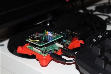

The first tests have been done using the bench power supply but I needed a more flexible method to follow the development lifecycle of the ESP, also considering that I plan to use more than one of them in the project nodes. As the Raspberry Pi 4B will be used as the desktop station to control the nodes and both signals and power voltage of the Pi works at 3V3 I decided to make a prototype Pi Shield for efficiently test the board, including the serial communication. Changing a while the programmer circuit I made the scheme shown below:
Note that the reset button does not need any resistor but – again after a long series of tests with Jan Cumps – I have added a jumper to enable or disable the serial connection between the Pi and the ESP, as well as a power switch. The creation of the prototype shield based on this circuit worked well but due to a latch-up condition on the Raspberry Pi, it is not possible hot powering the shield. Despite this detail, the ESP8266 can communicate with the Raspberry Pi Serial and is powered without difficulty.
The right procedure to plug and remove the board from the shield is the following:
To Remove the ESP8266
  1. Power off the switch on the shield
  2. Optionally disable the Serial Pi Tx signal (suggested)
  3. Remove the ESP8266
To Insert the ESP8266
  1. Shutdown the Raspberry Pi
  2. Insert the ESP8266 board
  3. Power on the board and also the Raspberry Pi will power on.
