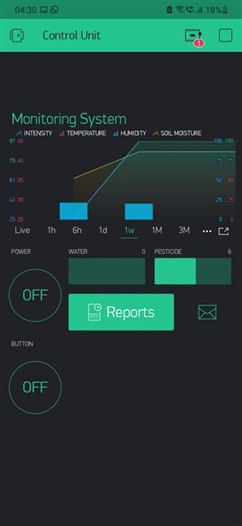

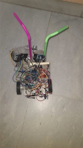

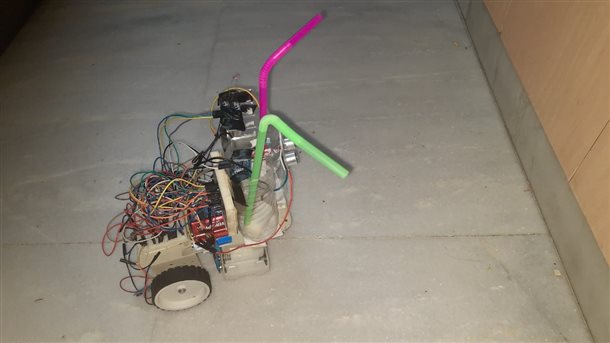

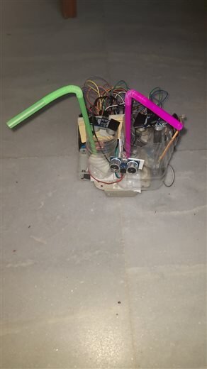

In this blog, we will link all individual components to Arduino Nano 33 IOT and setup the remote control server.
Finally, all the code and wiring has been completed. I have uploaded the same here as well as on Github. The pictures have been added so that you can see how the setup can be done on both hardware and software end.

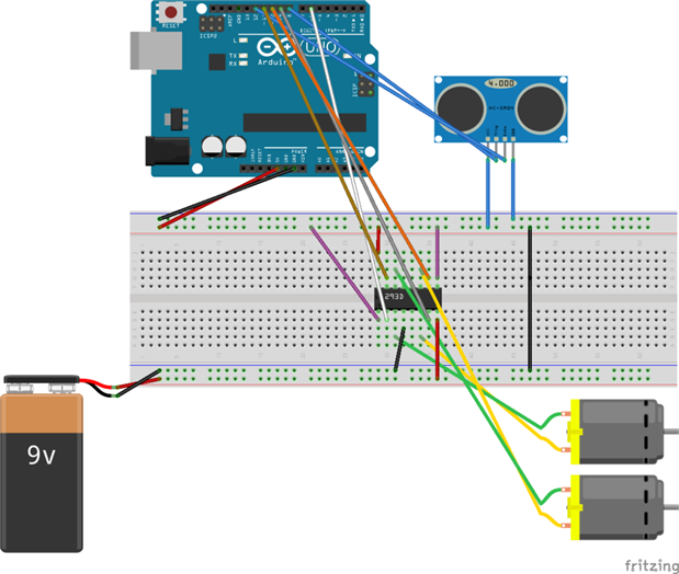

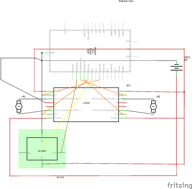

The Arduino Uno code has been changed a bit. I have had to remove the servo as I was left with no space on my chassis. So, I have removed that code and the servo. Due to that, the bot will always more left when it encounters an obstacle(or right if you would like to change it). I completely forgot about the size before starting and getting a new chassis right now would be a little too difficult. Any case, we worked with both things so it was fun.
The Arduino Nano 33 IOT code is same as in the last blog as everything was linked in that post.
The working video will be shown in the next Blog. Hope you are as excited as me!!!

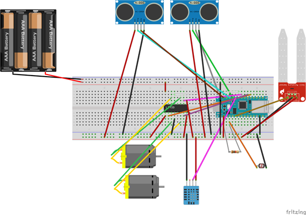

Wiring:
Code:
AgroBot final code(for Arduino Uno):
https://github.com/aaryan2134/Remote-Agriculture-Solution/tree/main/Final_Arduino_Uno_Code_-_Agrobot
//Remote Agriculture Solution
// Autonomous Agro Bot
/*          Arduino based bot for automatic movement around the farm
  Dev: Aaryan Arora
  For Design For A Cause 2021
//Libraries
#include <Servo.h>
int TurnDelay = 1100;
#define TRIGGER_PIN1  8  // Arduino pin tied to trigger pin on the ultrasonic sensor.
#define ECHO_PIN1     12  // Arduino pin tied to echo pin on the ultrasonic sensor.
long duration, cm;
//Constants
const int motorA1 = 6;    //motor A positive (+) pin to pin 6 (PWM) (from L293D module!)
const int motorA2 = 9;        //motor A negative (-) pin to pin 9 (PWM)
const int motorB1 = 10;   //motor B positive (+) pin to pin 10 (PWM)
const int motorB2 = 11;   //motor B negative (-) pin to pin 11 (PWM)
//Variables
int distance;         //Variable to store distance from an object
int checkRight;       //To store right distance
int checkLeft;        //To store left distance
//declaring functions
void forward();
void backward();
void stop();
void left();
void right();
int ultraFront();
void setup()
  //Setting Motor control pins to output
  pinMode(motorA1, OUTPUT);
  pinMode(motorA2, OUTPUT);
  pinMode(motorB1, OUTPUT);
  pinMode(motorB2, OUTPUT);
  //Setting pins from Ultrasonic Sensor
  pinMode(TRIGGER_PIN1, OUTPUT);
  pinMode(ECHO_PIN1, INPUT);
void loop()
  //Read distance...
  distance = ultraFront();
  //Check for objects...
  if (distance > 15) {
    forward(); //All clear, move forward!
  else
    left(); //turn left otherwise
// functions for various type of motions
void forward() {
  digitalWrite(motorA1, HIGH);
  digitalWrite(motorA2, LOW);
  digitalWrite(motorB1, HIGH);
  digitalWrite(motorB2, LOW);
void backward() {
  digitalWrite(motorA1, LOW);
  digitalWrite(motorA2, HIGH);
  digitalWrite(motorB1, LOW);
  digitalWrite(motorB2, HIGH);
void right() {
void left() {
void stop() {
//for measuring distance using ultrasonic sensor
int ultraFront() {
  digitalWrite(TRIGGER_PIN1, LOW);
  delayMicroseconds(2);
  digitalWrite(TRIGGER_PIN1, HIGH);
  delayMicroseconds(10);
  // Read the signal from the sensor: a HIGH pulse whose
  // duration is the time (in microseconds) from the sending
  // of the ping to the reception of its echo off of an object.
  duration = pulseIn(ECHO_PIN1, HIGH);
  // Convert the time into a distance
  cm = (duration / 2) * 29.1;   // Divide by 29.1
  return cm;
Monitoring System(for Arduino Nano 33 IOT):
https://github.com/aaryan2134/Remote-Agriculture-Solution/tree/main/Final_Arduino_Nano_33_IOT_Code_-_monitoring_system
