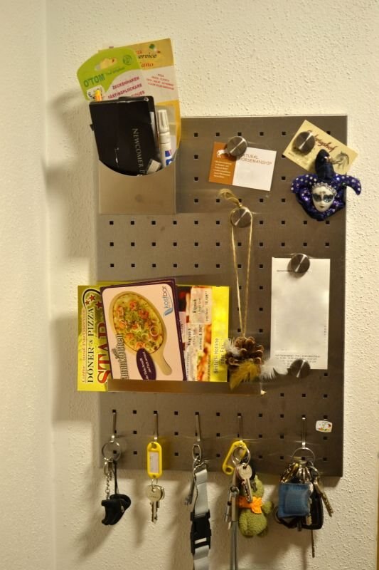

Smart Key Hooks
What are smart key hooks? Or what are key hooks anyway?
Basically they are a place to hang your keys like this:
But for me it is a little more. By looking at it I know who's at home and who not and it is used to exchange important messages between family members:
(The mess is just utensils you want to reach from the doorstep.)
As is it works perfectly, is accepted by the users, has a intuitive user interface and is highly robust to operating errors by the user. Why does it need to be enchanted then? For integration into a SmartHome system and to make it's functions available online. For the challenge I'v decided to concentrate on on the later.

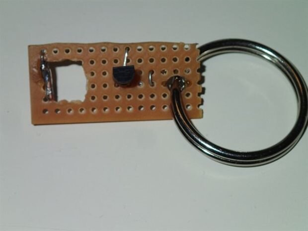

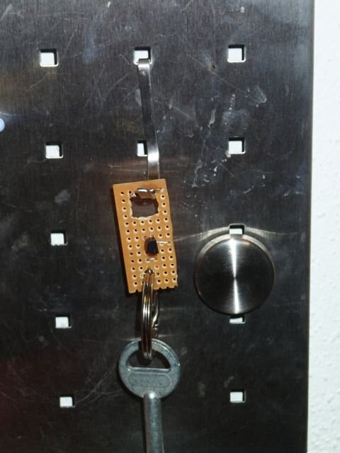

While testing various methods to detect and identify key rings which are placed on a hook (Identifying Keys) I found one solution which satisfies the optional feature 2).
By using 1-Wire EEPROM or ID devices inside a key tag I am able to identify individual key tags and thus key rings regardless on which hook they were placed as. In theory (but I haven't tested) this should work even when more than one key tag hangs on each hook since 1-Wire is a bus system. This is necessary for the clean and unchanged user interface of the Smart Key Hooks.

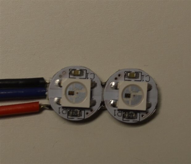

For the status LEDs I identified two options: use the provided Infineon RGB Shield and time division multiplex the output to multiple LEDs (preferred) or to use WS2812B LEDs on the SAMA5D4. In Using the RGB LED Lighting Shield on SAMA5D4 Xplained I found out that Linux does not support 10-bit I2C addresses and therefore abandoned this option as to time intensive.
Then I turned my attention to the second option which turned out to be a learning experience and not less time consuming. Since there was no library available which allowed interfacing with the WS2812 form Linux or the SAMA5D4 I had to find a solution: using PWM hardware to bit bang the required signal (Generating a Mysterious Signal, Use WS2812B on the SAMA5D4 Xplained and More Datasheet Studying). The code compiles but segfaults when I run it on the board. Unfortunately there is no time left to debug it.
