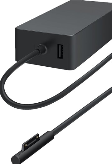

    I took apart (or tried to! I only got so far) an AC-DC converter today. It's a laptop supply that only lasts a couple of years. I've gone through several of these (Microsoft PSU model 1798), although they look well-built, there's clearly some flaw with them. After a couple of years, they only occasionally work, for a few minutes and then they stop.
    image (image source: Microsoft)
    It's near-impossible to tear apart, the electronics are tightly packed in the thick plastic enclosure and welded shut. It's in fact impossible to remove without milling the case off on multiple edges. Anyway I don't intend to fix it, it was more from curiosity that I persisted in opening it.
    It's quite interesting.. theres a couple of extra wires inside the DC output lead, which presumably controls power so that there's no sparks when the magnetic connector is attached or detached.
    The power supply is mostly surrounded by copper.
