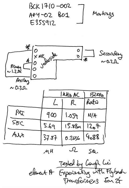

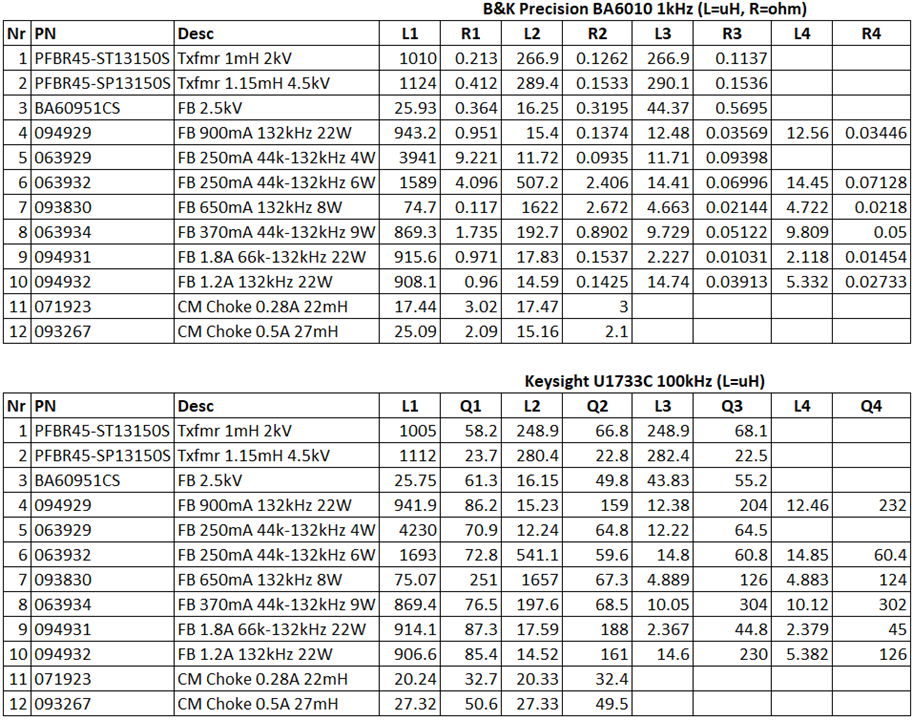

With the components in hand, I thought it would be important to measure certain characteristics just to confirm datasheet values and identify differences between different types of transformers.
LCR Measurements
I decided to use the B&K Precision BA6010 Battery Analyser as an LCR meter. This meter is intended for use in measuring AC internal resistance for batteries and acts like an isolated 1kHz AC LCR meter. While its ranges and accuracy may not be as good as a proper benchtop LCR meter, it’s more accurate than most handheld meters.
To back this up, I decided to also use my Agilent (now Keysight) U1733C Handheld LCR Meter for higher frequency, 10kHz testing.
This should be a closer match to datasheet testing conditions, although I was not able to match the test current in all cases as the meter decides what current to use.
In general, the measured parameters match quite well with the datasheet specifications and measurements between equal windings only differed slightly, in part due to slight wire length and test lead positioning differences between tests.

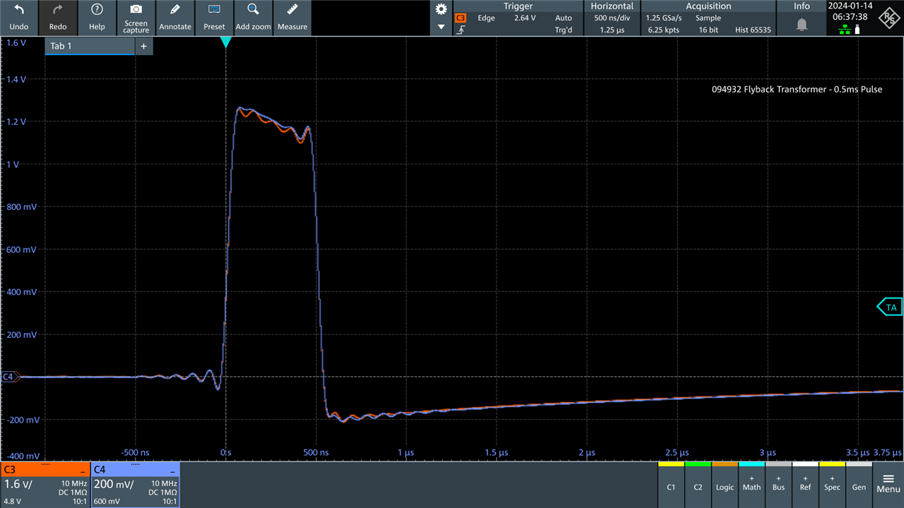

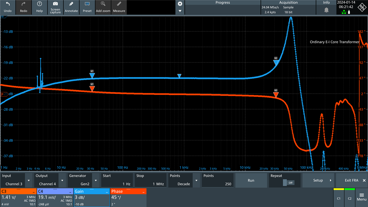

Another thing I thought was worth measuring was just how these transformers behave in the frequency domain and with square wave excitation at various frequencies, compared to ordinary mains transformers.
image image

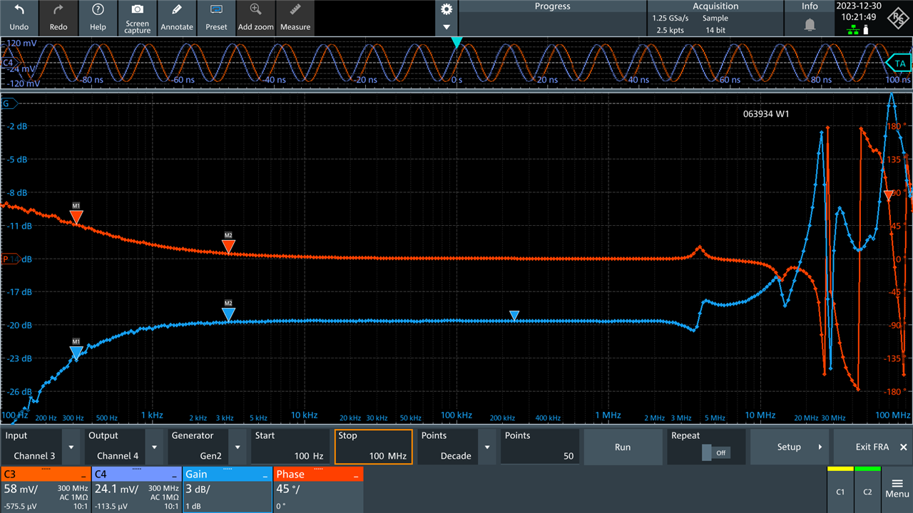

For this, I used a Rohde and Schwarz MXO4 Oscilloscope (review pending) with its onboard signal generator to run some bode plots on a few products.
Looking at this test of a flyback transformer, it seems that the gain tails off in the low frequency end around 2kHz. I presume this is because of core saturation effects. Towards the 4MHz region, there is a bit of a dip, but self-resonance doesn’t seem to occur until 25MHz (or is that just my clip ground lead). Nevertheless, this reminds us that part of the “magic” of the small transformer is in its higher operating frequency than the mains transformer.

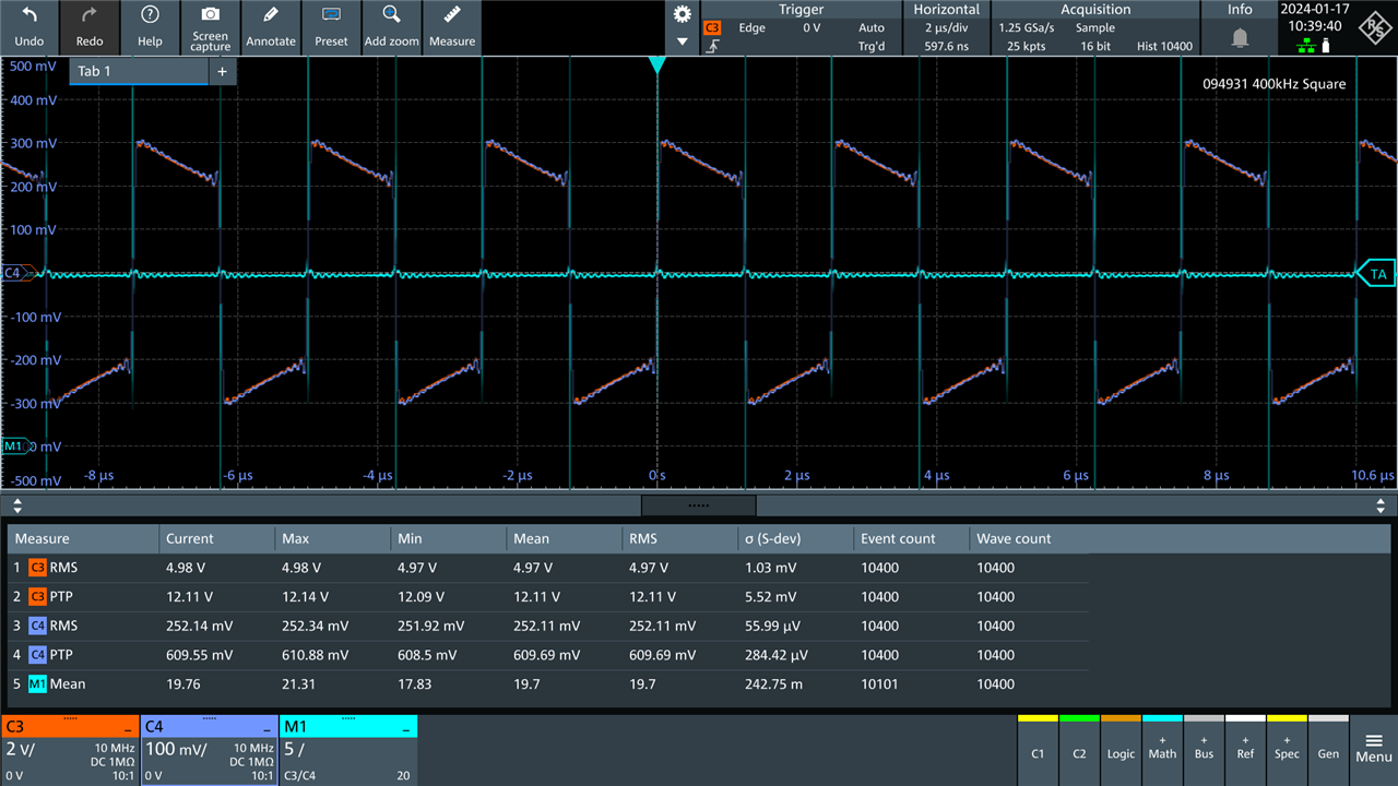

Driving a 0.5ms pulse into a flyback transformer results in faithful reproduction.
Taking the ordinary E-I core mains transformer, and ignoring the few gain spikes due to range switching, we can see that it is happier at low frequencies but starts deviating significantly by the time we pass 20kHz, being self-resonant before 100kHz.
When this E-I transformer is excited by a 0.5ms pulse, it sort of “rings” around 54kHz.

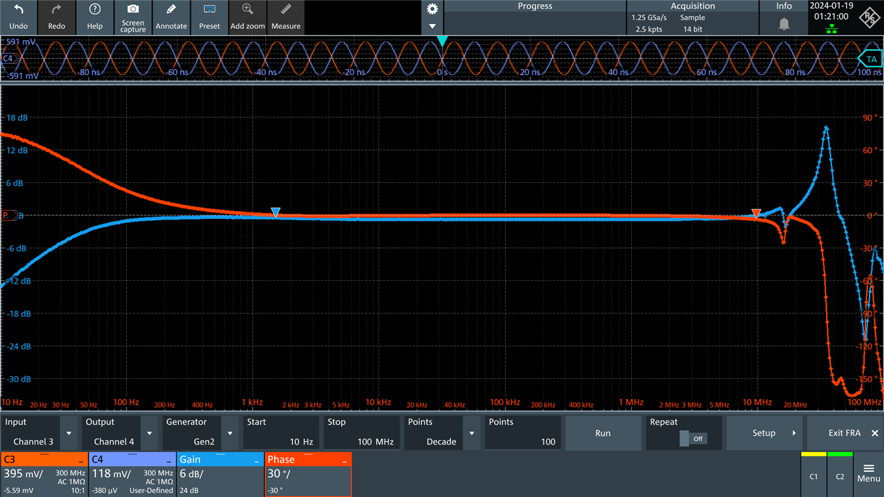

Testing of the ordinary PLC transformer (PFBR45-ST13150S) showed an excellent flat bandwidth response across a range of frequencies starting at around 45Hz (-3dB) and extending past 10MHz. Above there, the mess that is visible is likely due to the clip grounds. The reinforced insulation version had virtually identical results.

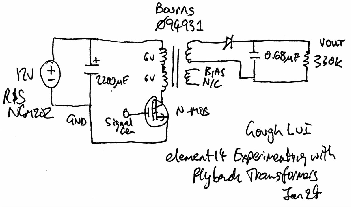

Q7: Building a Very Basic Flyback Circuit to Step-Up
For this experiment, I chose the Bourns 094931 SP-E 20/6 Flyback Transformer. The reason for this is several fold – for one, I wanted to avoid high voltage in my experiments as I couldn’t confidently work with it and switch it quickly with my junk box parts. Remembering that the physics of transformers is (generally) reversible, the distinction in primary and secondary is merely by name. As long as the secondaries were rated at reasonable voltages that I could work with, I could drive them and expect the system to step-up the voltage to something bigger. The 094931 has two 6V/1.8A-rated secondaries, which could be wired in series so I could drive it nicely from 12V.
Another reason for this choice is that generating high voltages from low voltages can be immensely useful. This transformer claims a 19.75 : 2.75 : 1 : 1 ratio, as a result, I would expect, giving 12V to the two 6V windings in series, I would get 19.75 x 6V = 118.5V from the primary. I decided to keep things simple and left the bias winding open, but were I greedy, I could have series this with the primary to get a total of 22.5 : 1 ratio or an expected 135V.
Of course, the simple circuit needs some additional “helpers” – the first being a tanky primary side capacitor. This was mainly just out of concern that the wildly rapidly pulsating current may not play well with my wires and the power supply, even though I chose to use a very competent and fast Rohde & Schwarz NGM202 for this experiment. The second is a rectifying diode for the output, which I chose to use a classic 1N4004 (400V, 1A, 0.7V Silicon) – inexpensive, somewhat fast but perhaps not low-loss. For the capacitor to smooth the output voltage, I used an X2 safety rated capacitor, 0.68uF 250V AC-rated. Being a polyester film capacitor, usually these are pretty tolerant of a bit of overload. Of course, because I didn’t want to get zapped, there had to be a load to quickly discharge the capacitor once power was shut down, so I chose a 330kΩ 1/4W carbon film resistor from the junk box.
The switching element is classically an N-MOSFET and I have not deviated from this. Rummaging through my junk box, I found some Rds Test PCBs I had previously built with certain MOSFETs mounted on them. As a result, I pressed one back into service for this experiment – one containing an ST Microelectronics STP22NF03L (30V, 22A, 50mΩ). I do realise that my “addiction” to low-Rds MOSFETs is unhealthy when it comes to fast switching due to high gate charge/capacitance and reduced breakdown voltages.
To drive this, I would use the onboard signal generator on the Rohde & Schwarz MXO4 Oscilloscope (review pending). As signal generators typically have a source impedance of 50Ω, this is not ideal for quickly changing the gate voltage, but it may still be a good enough drive.

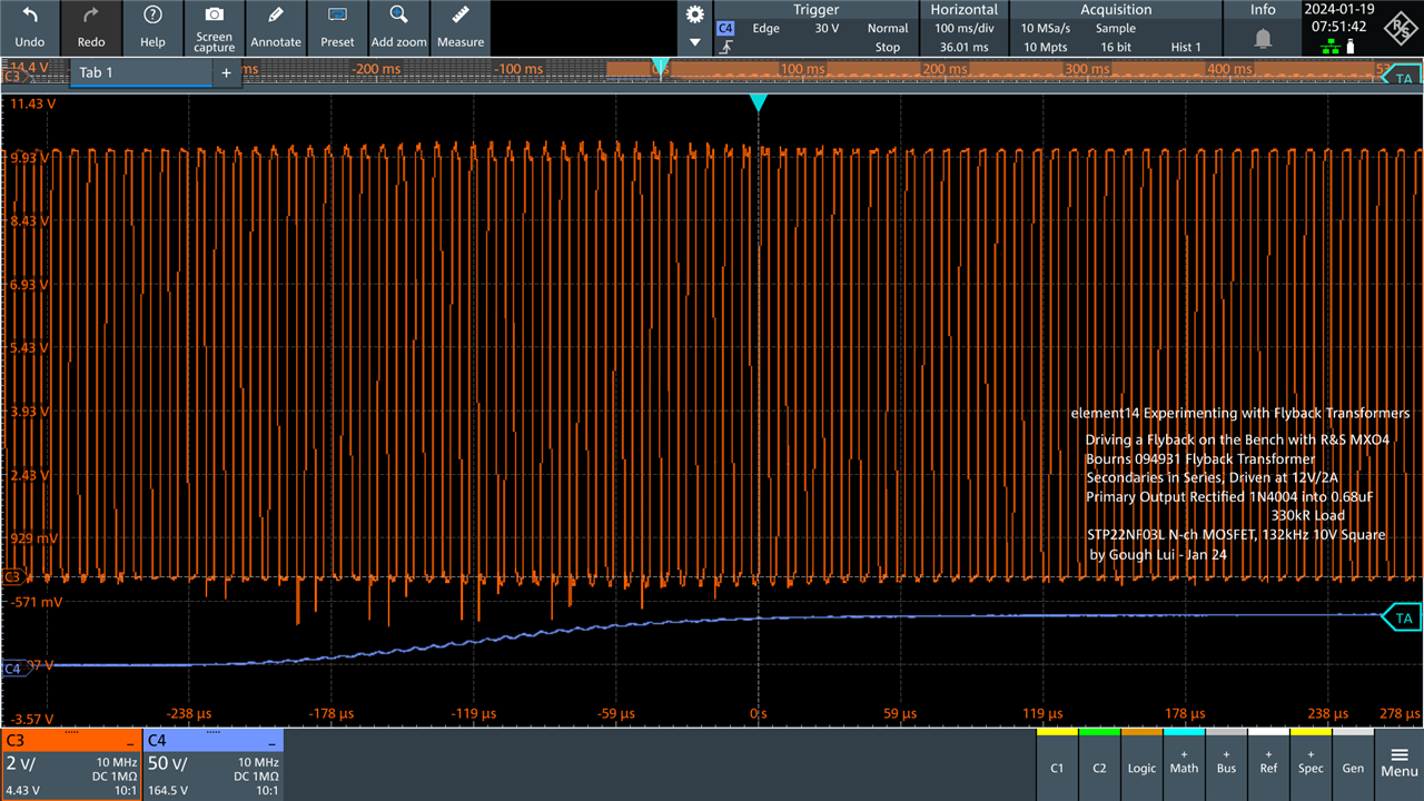

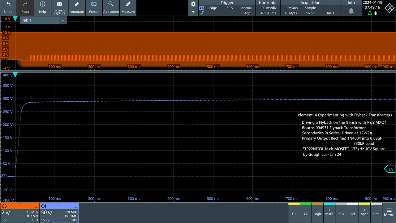

Attempt #1: It Works … Sort-Of.
Setting the signal generator to 132kHz Square Wave, 10V drive with 5V offset (so as to swing between 0V and 10V to drive the gate “hard”) and 50% duty cycle (because it seemed a good value) … I didn’t expect it to work when I applied the power.
But it did. It created an output voltage just shy of 300V, more than twice what I was expecting. It also seemed to be a bit of a current hog – it was drawing about 1.6A from my supply which seemed a bit much. In these diagrams, C4 (Purple) is the flyback output voltage and C3 (orange) is the gate input voltage.
Overjoyed that something actually happened this time. I turned it off, set my ‘scope up differently and powered it back up again.
Using a lot of zoom, we can see how it starts up – the voltage does have “ripples” between each pulse, indicating that it is doing what a flyback does – charging the magnetic core through the primary when the MOSFET is turned on and dumping that into the secondary when the MOSFET is opened.
So why is the output voltage higher? I suspect it’s because of inductive kick or perhaps because there is some sort of ringing. But it’s perhaps a nice bonus.
But before I could celebrate and get some more results, it stopped working. Instead, now, it wasn’t showing any of its flyback behaviour and it seemed to be loading the supply a lot more.
Without thinking, I decided to feel around to see if anything was hot and the MOSFET was literally burning. The tip of my index finger definitely felt it – this thermal image was taken a whole minute afterward.

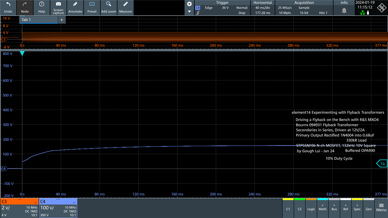

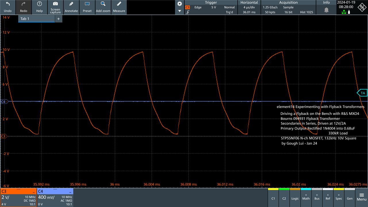

Attempt #2: I’m Not a Chef. Why Am I Cooking Chips?
One MOSFET down and a few ideas later, I got out the desoldering tool, whipped off the dead MOSFET and chucked in an ST Microelectronics ST55NF06. This time, it’s 60V, 50A, 18mΩ rated with a normal threshold gate that can tolerate 20V absolute maximum. Surely, this uprated MOSFET would be up to the task! I also improved the grounding, providing a direct ground path to the MOSFET independent of the flyback’s ground path to avoid voltage differentials.
I put it into circuit, but then I decided to take off the supply to the flyback just to begin with.

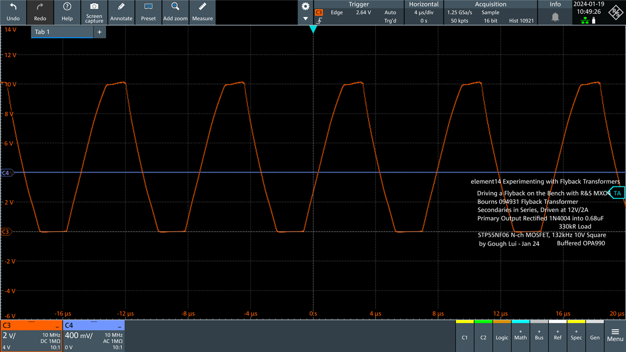

Turns out the gate on this MOSFET is a big one as my signal generator is putting out shark-fins rather than square waves. [Insert expletive of choice].
While the MOSFET may be up to the task, the signal generator is not … and with this kind of slow turn on/off, I can expect only wonky results and perhaps even more dissipation than before.
This is where I should be using a proper gate driver IC. I tried looking for my Infineon 1EDN8550B Gate Driver from a previous RoadTest but cannot locate the evaluation board. A second-best would probably be to use an opamp as a voltage follower and have that “buffer” the signal generator output and provide the bulk of the current. The problem? I don’t have many opamps on hand that can handle 10V+ and the ones that I do are slow with GBP of 1MHz and slew rates no more than about 5V/µs. The best I had was an OPA990 which I soldered onto a breakout and powered from the same 12V bus as the flyback itself …
… but this resulted in a more trapezoid waveform.
At least it looked somewhat nicer … even if it is slow. I guess I won’t have to be concerned about potential for dV/dT failures of MOSFETs with such a slow gentle waveform, but instead dissipation and linear-region operation is the concern instead.
After plugging in the flyback, the gate waveform now looks very strange indeed. At a duty cycle of 50%, I’m now getting 500V on the output – I wonder if this is because the capacitor itself is “leaking” enough to balance the voltage out or whether it’s the 1N4004 reaching its true limit (400V rated, likely with some headroom) and breaking down, but not passing enough energy to actually harm itself. This is a very suspicious number to arrive at.
Reducing the duty cycle to 10% dropped the voltage to a more manageable 160V or so. As a result, it seems we have been able to show the use of duty cycle to control the transferred energy and thus, regulate the voltage (assuming you have some feedback and a controller that can modulate the duty cycle).
Not long after this … this MOSFET perished as well, as I was not taking care of the heat while gawking at the results and trying repeatedly to get meaningful oscilloscope captures.

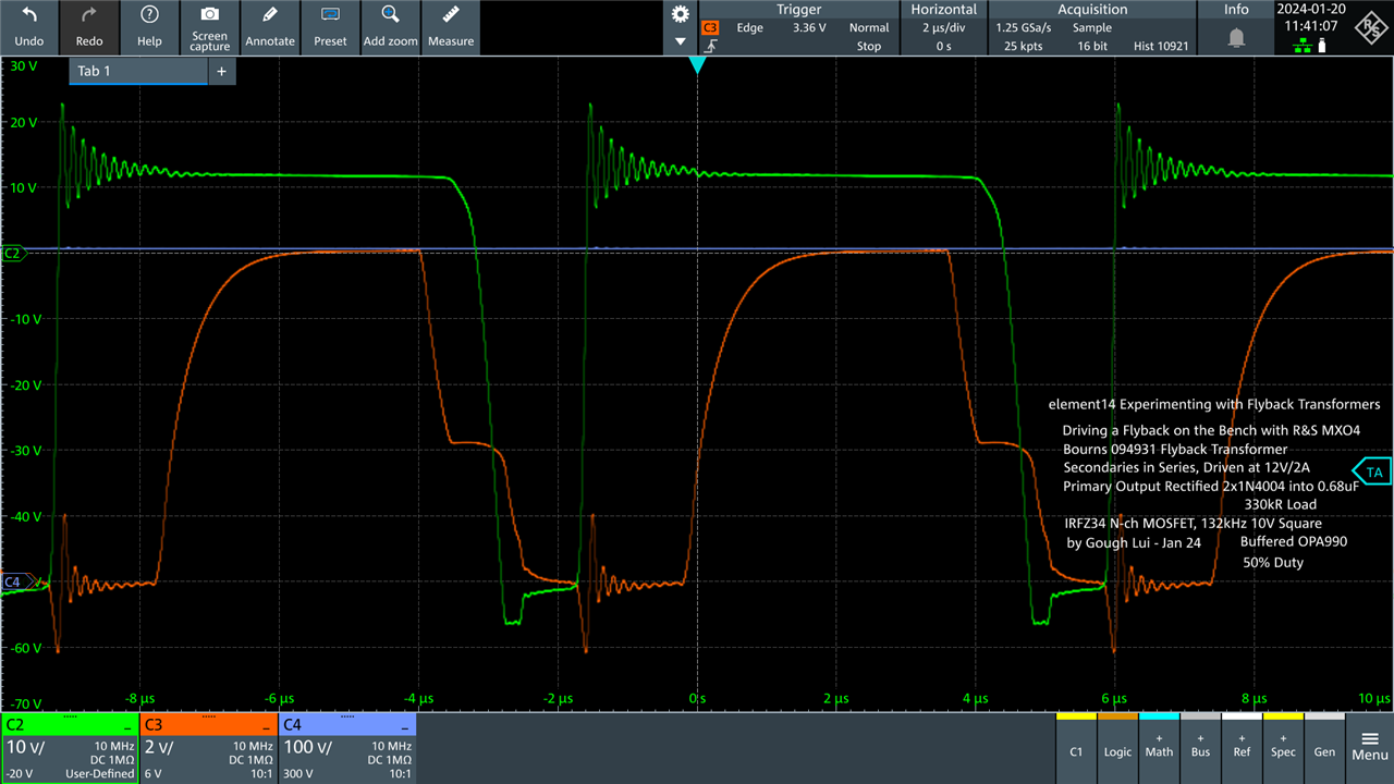

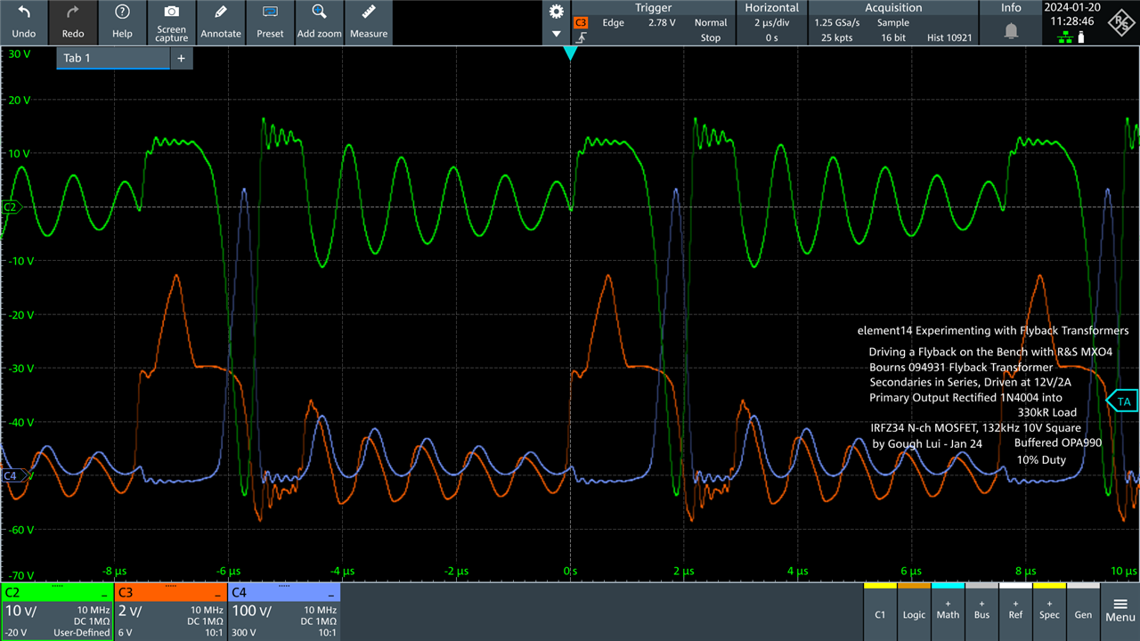

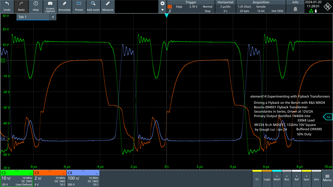

I removed the output capacitor to see how the circuit is really behaving. Looking at the flyback input voltage in green, we can see that flyback action is actually happening. The trigger point is when the MOSFET is turned on, and the coil is nicely charging at 12V. As the MOSFET turns off (somewhat delayed), the input coil drops negative and the output coil “flies” back to a much higher voltage – in this case, we’re seeing about 600V peak! Part of this is winding ratio, but the other may be some kind of resonance (with the ringing) and inductive “kick”, but I’m not entirely sure. This “flyback” action on the output coil only lasts a while until the field seemingly collapses and then the input coil voltage “flies up” again with a seemingly bigger ring before the cycle begins itself anew.
Looking at this, I am somewhat confused. I didn’t realise that during the flyback, the primary voltage would get so negative, even if briefly. I would expect the MOSFET’s body diode to conduct in about 100ns which I would have imagined would short it out if the coil developed a negative voltage. Considering this “peak” – if it were real, would have resulted in 1185V on the secondary by pure ratio – but perhaps the 330kΩ load dragged this down to the ~600V peak observed. The ringing is quite an interesting phenomenon – perhaps it’s affecting the ground enough that the MOSFET’s actually getting to the point of a partial turn-on during one of the rings. Maybe the faster edges in some cases were provoking more severe ringing, heating up and killing the MOSFETs quicker.

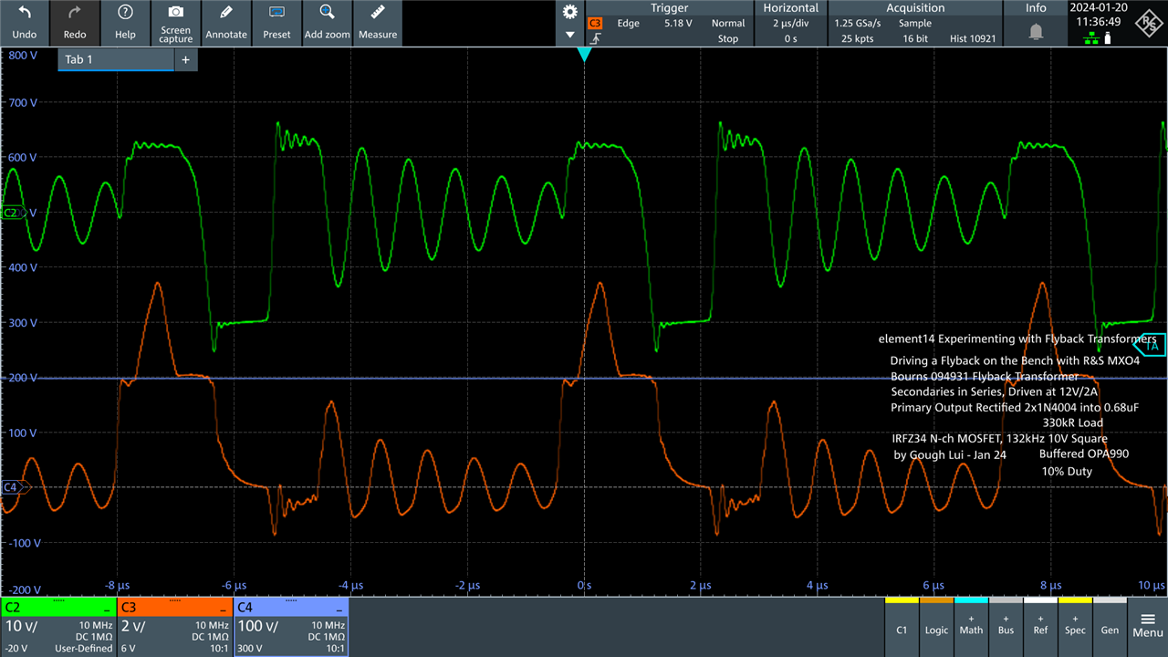

At this point, seeing the voltages are approaching 600V, I wondered if it’s the 1N4004 that’s letting me down. I decide to replace it with two 1N4004’s in series for a total of 800V to see if the output voltage would rise – it didn’t. I wonder if increasing the MOSFET’s Vds breakdown rating would help there or whether it’s something else entirely (perhaps the Q of the transformer itself).
Here’s the same test with the output capacitor connected – the ringing is quite a bit cleaner to see and the nature of the ringing is different. Perhaps this is removing the secondary ringing from reflecting back into the primary.
Dropping the duty cycle to 10% seems to show the ringing behaviour more clearly, with two different ringing frequencies observed. The voltage spike is more like 530V now, but for a shorter time, which when smoothed by a capacitor, results in a lower (average) voltage.
Here’s the same test with the capacitor plugged in. The waveform differs subtly when the output is smoothed – it seems less secondary ringing means less secondary ringing being inducted into other parts of the system. Overall, I would consider this experiment a success, even if it was rudimentary.

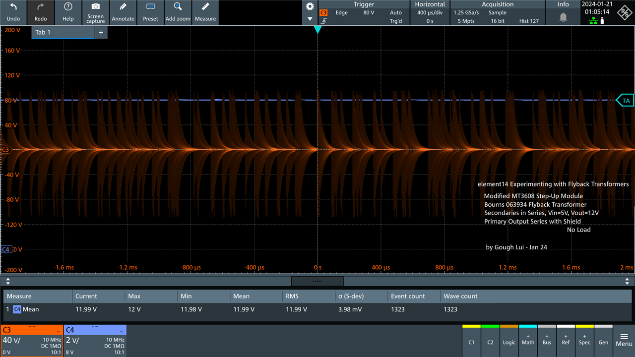

Q9: The Final Push – Another Modification Attempt with a Boost Module Instead

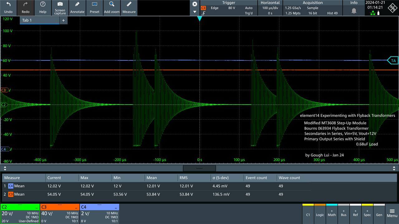

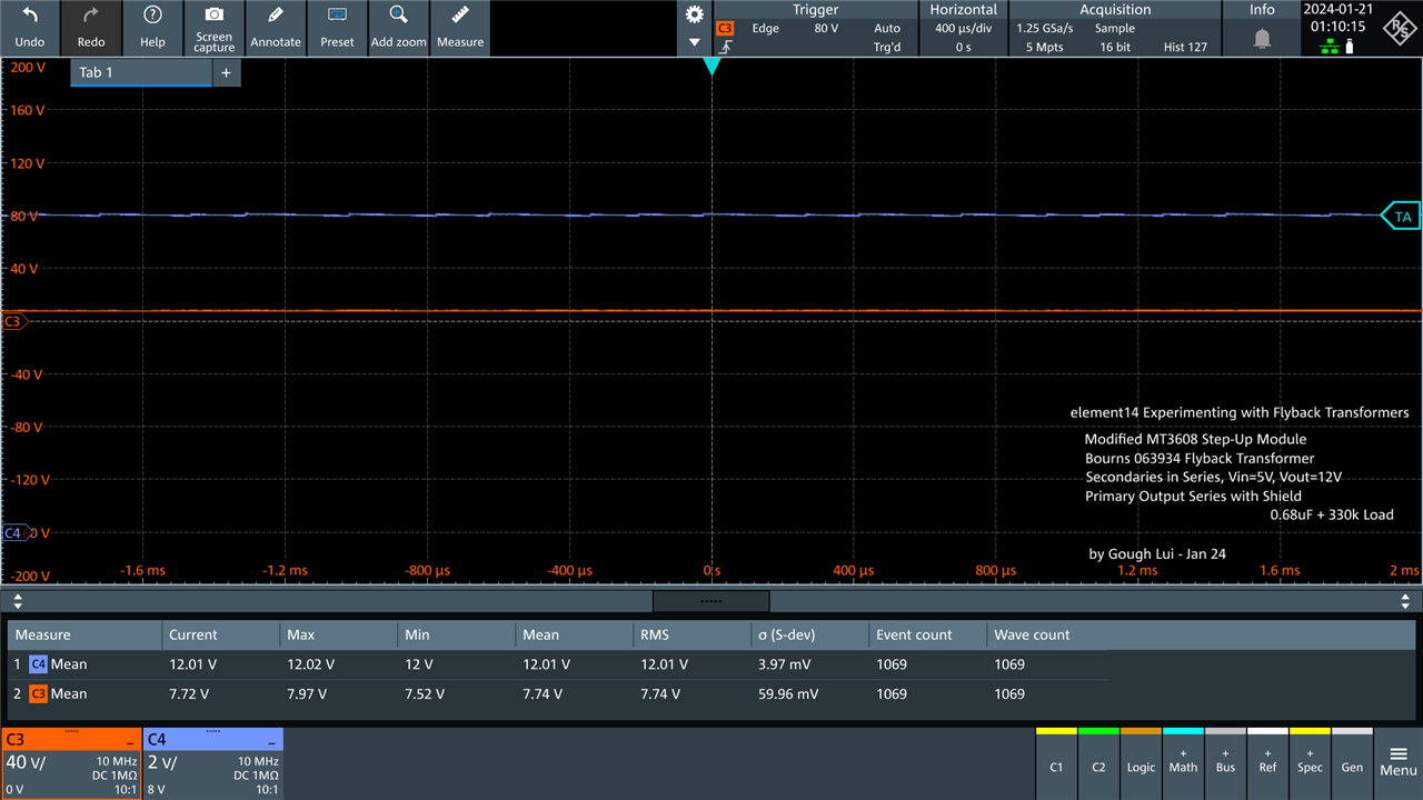

I wasn’t entirely satisfied with a lack of regulated flyback action, so thanks to a comprehensive comment by jc2048  on Part 5, I decided to give it one more go but this would be my absolute last given the time I have available.
Remember that the flyback topology resembles a boost converter with a transformer instead of an inductor? That gave me an idea which was so obvious in hindsight, I’m surprised I didn’t try it first. I got out one of these rather popular MT3608 boost converter modules as the basis for a bit of modification. This is not an ideal module to be using as the IC switches at 1.2MHz, which is quite a lot higher than the 132kHz the transformer is optimised for, but I had none of the older variety which switched at 400kHz in my junk box.
The proposed “step one” would be simple – remove the inductor and replace it with the secondaries (in parallel) of a Bourns 063934. Changing nothing else, I was hoping that in spite of the difference in inductance and the high operating frequency, that the unit was still able to run as an ordinary boost converter just with a “second rail” consisting of the primary and bias windings in series, which may be at a higher voltage. I didn’t know what would happen to it – would there be some regulation? Likely not because the feedback was not on this second rail.
With some creative soldering and solid core wire, I was able to realise this configuration for testing.
To my surprise, when I fed the module with 5V and adjusted the potentiometer, it was working as a boost converter and giving a nice 12V output on its main output. The second rail, in orange, was showing the converter was operating in some sort of low-power hiccup mode, with ringing pulses peaking around 110V. That sounds about right …
Putting a diode, capacitor and resistive load on it, however, dragged the rail down to about 7-8V. A far cry from what I expected. I suppose this is what happens when you only load one of multiple-rails in a flyback system.
Now that I can see this working, I decided to take one more step – let’s move the feedback to the second rail consisting of the primary and bias windings in series. To do this, I would modify the PCB by removing the rectifier diode and then patching in the feedback potentiometer and resistor to the positive side of the second rail. The negative side would be commoned to ground.
This would make a non-isolated converter which eliminates a key benefit of the flyback transformer, but it should still work in theory.
A little more creative soldering and it’s been built.
Powering up, the output from the other side of the transformer was rock-solid at the 12V that it was previously set to indicating the circuit was indeed regulating the output. I was able to dial it up to about 30V (the original maximum voltage) because of the way the voltage divider was set but after a short time, the MT3608 died a dead short …
This is when I decided to take a look back at the difference between schematics – hmm, originally the normal output goes through a Schottky diode, a capacitor filter in-parallel with a resistor trimpot for feedback. Aha! That network, while not intended to be, actually acted as a RCD snubber it would seem, which is why the circuit didn’t blow up initially. Once I removed the Schottky to move the feedback around, that removed whatever snubbing effect it may have had, which probably overstressed the internal MOSFET.
Knowing this, I tried building a separate snubber network with different values, replacing the MT3608 and adding resistance to the divider network to allow for higher regulated output voltages, but it just chose to blow right away every time even with a 5V input. In my haste, I changed multiple variables at once, which is bad science. I am a component murderer … but at least there wasn’t any smoke or physical injury this time. But alas, it seems a few minutes of flyback action is all I can muster for now. That's the end of my weekend!
Conclusion
