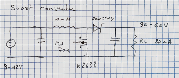

I'm reviewing a set of inductors for the Experimenting with Magnetic Components design challenge.
Because it's a design challenge, I'd like to start with a working product. A switch mode DC converter.
It's one of the standard circuits: the boost converter. A design that increases a DC voltage.
Goals:
  • 9 - 12 V DC input
  • 30 - 60 V DC output
  • up to 20 mA output current
  • max 200 mV ripple
  • common components
  • no regulation or feedback
But first:

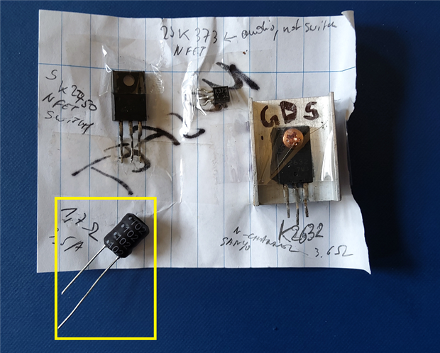

The inductor: Bourns RLB Series 1mH Radial Lead InductorBourns RLB Series 1mH Radial Lead Inductor
image: Bourns RLB0914-102KLRLB0914-102KL 1MH inductor with candidate MOSFETs
The datasheet is available on element14. All info is taken from that document.
image: the specifications of the 1mH inductor
Measurements on the component in my kit:
The datasheet did the measurements at 252 KHz. I'm doing them at the maximum setting of my meter: 100 KHz.
The meter (comparable with GW INSTEK LCR-916) was calibrated before the measurements.
Results (f = 100 KHz)
L:955.5µH
Q:  106.5
D: 0.009 (1/Q)
ϕ: 89.4°
ESR: 5.64 Ω

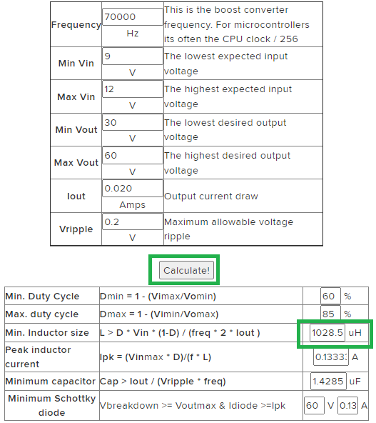

The Boost Converter Calculations
I'm using the most common boost converter design. Adafruit (and others) posted a calculator online.
I used that, and changed parameters until the design matched the 1 mH inductor.
image source: calculation done with the Adafruit boost converter calculator.
Whe in I use a switching frequency of 72000 Hz, the calculator suggests exactly 1 mH.
Texas Instruments has an application note on the calculations.
Coursera has an excellent Power Electronics course, from U of Colorado Boulder.
Hang on while I'm starting the build.

    My function generator should be up to the job.
    It can generate a square wave that's 22 V p/p. I can use it isolated and concider the -11 V as ground level.
    If I use its offset mechanism to make it ground-referenced, I can get a 13.5 V square wave:
    I don't worry about the negative shoot-through in offset mode, should not harm the gate.
    But most likely I'll use it in isolated mode.
    In any case. 8 V and more should do it in my scenario:
    source: Sanyo 2SK2632LS datasheet
    Jan Cumps over 5 years ago
  • jc2048
    jc2048 over 5 years ago in reply to Jan Cumps
    Without feedback regulating the output, I think if you take it off load you'll probably see either the Schottky break down or the output capacitor fail.
    If you can't manage to get the generator to work with the offset, you could experiment with AC-coupling and clamping the gate side to ground with a Schottky. This seems to work in the simulator
    Jan Cumps over 5 years ago in reply to jc2048
    Yes. I've soldered the load on proto board. It's all a bit brutal but it should do for the experiment.
    shabaz over 5 years ago in reply to Jan Cumps
    Hi jan,
    Nice prototyping!
    Btw there's a typo, you mean 72000 Hz but have written 72000 kHz.
    Jan Cumps over 5 years ago in reply to shabaz
    fixed
