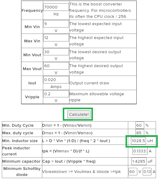

I'm reviewing a set of inductors for the Experimenting with Magnetic Components design challenge.
Because it's a design challenge, I'd like to start with a working product. A switch mode DC converter.
It's one of the standard circuits: the boost converter. A design that increases a DC voltage.
Goals:
  • 9 - 12 V DC input
  • 30 - 60 V DC output
  • up to 20 mA output current
  • max 200 mV ripple
  • common components
  • no regulation or feedback

The inductor: Bourns RLB Series 1mH Radial Lead InductorBourns RLB Series 1mH Radial Lead Inductor
image: Bourns RLB0914-102KLRLB0914-102KL 1MH inductor with candidate MOSFETs
The datasheet is available on element14. All info is taken from that document.
image: the specifications of the 1mH inductor
Measurements on the component in my kit:
The datasheet did the measurements at 252 KHz. I'm doing them at the maximum setting of my meter: 100 KHz.
The meter (comparable with GW INSTEK LCR-916) was calibrated before the measurements.
Results (f = 100 KHz)
L:955.5µH
Q:  106.5
D: 0.009 (1/Q)
ϕ: 89.4°
ESR: 5.64 Ω
The Boost Converter Calculations
I'm using the most common boost converter design. Adafruit (and others) posted a calculator online.
I used that, and changed parameters until the design matched the 1 mH inductor.
image source: calculation done with the Adafruit boost converter calculator.
Whe in I use a switching frequency of 72000 Hz, the calculator suggests exactly 1 mH.
