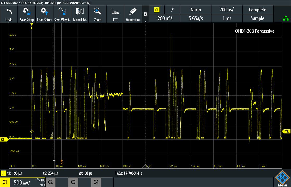

    Spoiler Alert - this is something I wanted to save for the next post, but since you asked, I'll give you a tiny sneak peek -
    The easiest way I could think of to assess this was to take a break-type switch (that is normally closed), drive it with 1V/1mA from an SMU to ensure it meets the minimum voltage/current requirements (or a PSU + resistor would also work). I have an oscilloscope probe hooked over the switch and then I give it a sharp impulse from a screwdriver hitting the face of the unit.
    Treating this like a system with a resonant frequency response, a sharp impulse would have energy across the spectrum, but the dominant resonance should show up. Indeed, the switch seems to resonate at about 14.7kHz (dependent on the package and reed geometry), but there may be sub-resonances as well, as you can see it "damp" into an irregular train of switching transitions.
    The datasheet for the TRS-series did allude to this possibility in the line "Thermal Reed Switches have a specific resonance frequency. Please contact a KEMET representative if an oscillation is added." I suppose that's what I found ... although this frequency does seem to vary depending on the package. I'll provide some further details in the next post which I'll hopefully have online by next weekend. Can't give everything away so soon ;).
    - Gough
