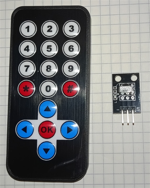

By mapping explicit hex codes from a handheld remote, the car acts on standard movement directions. Because a single button press should not trigger indefinite movement, an optional timeout sequence safely cuts power to the motors when the transmitter goes quiet.
This sketch boots the vehicle into manual mode, giving you directional control via your handheld remote. When a key is released, a built-in safety timeout automatically halts the motors to prevent runaway scenarios.

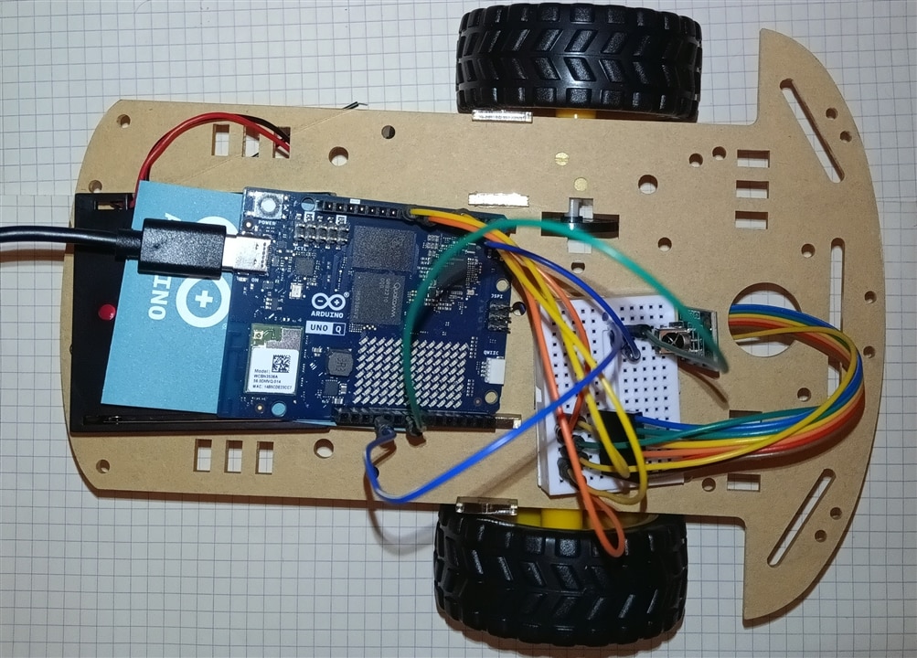

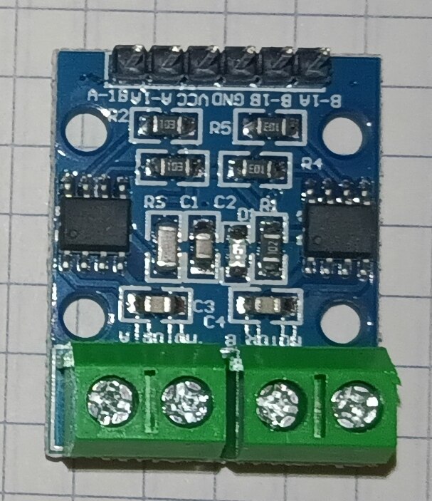

The STM32 microcontroller controls the motors using the L9110S chip located on a board attached to the motor. The power module board contains two L9110s chips, each controlling a single DC motor.
The vehicle can be controlled locally using a remote control
The assembled vehicle, ready for testing, is shown in the photo below. The vehicle includes an Arduino Uno Q, a 4x1.5V battery pack, and a breadboard containing an infrared receiver.
Here is the circuit connection and pin configuration guide for setting up your Arduino board with the L9110S motor driver, IR receiver, and power system.
Pin Mapping Table
Component Component Pin Arduino UNO Q Pin Notes / Description
L9110S Motor Driver A-1A / A-1B Pin 5 (PWM) Motor A Direction & Speed
A-1B / A-2A Pin 6 (PWM) Motor A Direction & Speed
B-1A / B-1B Pin 9 (PWM) Motor B Direction & Speed
B-1B / B-2A Pin 10 (PWM) Motor B Direction & Speed
VCC External Power (+) 6V - 12V (Battery pack)
GND Common Ground (-) Shared GND with Arduino
IR Receiver OUT / DATA Pin 2 Signal line (INPUT_PULLUP)
VCC 5V / 3.3V Logic power supply
This Arduino sketch implements a complete control system for a two-wheeled mobile robot managed via an Infrared (IR) remote. It decodes custom IR timing signals, controls DC motors using an L9110S H-bridge driver, provides visual status updates via onboard RGB LEDs, and displays directional arrows on an 8x13 LED matrix.

4. Low-Level IR Signal Decoder (readElecrowIR)
Implements custom pulse-width decoding for the Elecrow IR protocol without relying on standard IR libraries. It measures microsecond pulse durations, reconstructs 32 bits (4 bytes) of data, and validates signal integrity using a bitwise checksum (data + data == 0xFF).

void driveMotors(int a1, int a2, int b1, int b2) {
  // Omit pinMode() in setup to keep PWM functional on the UNO Q Zephyr core
  analogWrite(MOTOR_PIN_A1, a1);
  analogWrite(MOTOR_PIN_A2, a2);
  analogWrite(MOTOR_PIN_B1, b1);
  analogWrite(MOTOR_PIN_B2, b2);
void executeCommand(byte command) {
  switch (command) {
    case 0x18: // Up Arrow - Forward
      driveMotors(0, MOTOR_SPEED, 0, MOTOR_SPEED);
      set_led4_color(false, true, false);
      set_led3_color(0, 200, 0);
      matrix.draw(arrow_up);
      break;
    case 0x08: // Left Arrow - Turn Left
      driveMotors(MOTOR_SPEED, 0, 0, MOTOR_SPEED);
      set_led4_color(false, false, true);
      set_led3_color(0, 0, 200);
      matrix.draw(arrow_left);
      break;
    case 0x5A: // Right Arrow - Turn Right
      driveMotors(0, MOTOR_SPEED, MOTOR_SPEED, 0);
      matrix.draw(arrow_right);
      break;
    case 0x52: // Down Arrow - Backward
      driveMotors(MOTOR_SPEED, 0, MOTOR_SPEED, 0);
      set_led4_color(true, false, false);
      set_led3_color(200, 0, 0);
      matrix.draw(arrow_down);
      break;
    default:
      driveMotors(0, 0, 0, 0); // Stop for unassigned keys
      set_led4_color(false, false, false);
      set_led3_color(0, 0, 0);
      matrix.draw(stop_icon);
      break;
void setup() {
  Serial.begin(115200);
  // Enable internal pull-up resistor (Equivalent to Pin.PULL_UP in MicroPython)
  pinMode(IR_RECEIVE_PIN, INPUT_PULLUP);
  Serial.println("Elecrow IR Decoder for Arduino UNO Q Ready.");
  pinMode(LED4_R, OUTPUT); pinMode(LED4_G, OUTPUT); pinMode(LED4_B, OUTPUT);
  matrix.begin();
  matrix.setGrayscaleBits(3);
  matrix.clear();
void loop() {
  // Main loop logic translated 1:1 from the manufacturer's MicroPython code
  if (digitalRead(IR_RECEIVE_PIN) == HIGH) {
    long result = readElecrowIR();
    if (result != -1) {
      lastCommand = (byte)result;
      Serial.print("Retrieve key: 0x");
      Serial.println(lastCommand, HEX);
  // Safety and control: if the IR pin is HIGH (no transmission), stop the robot.
  // Otherwise, continue executing the last received command.
  if (digitalRead(IR_RECEIVE_PIN) == LOW) {
  } else {
    executeCommand(lastCommand);
  delay(10); // Small delay for main loop stabilization
