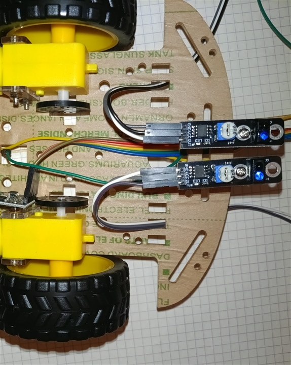

Manual driving is limited by line-of-sight. To implement autonomous navigation, we integrate dual Infrared Line-Tracking Sensors (TrackingPin_L and TrackingPin_R). These sensors output binary feedback depending on whether they detect a highly reflective light floor or a non-reflective dark path.To allow transitioning between manual piloting and automatic tracking, we establish a State Machine using a RobotMode enumeration. Pressing a designated toggle button (0x1C or "OK") alternates the core operating architecture.
This step implements a Finite State Machine utilizing the remote's OK button (0x1C). You can now toggle mid-flight between manual control and an automated tracking routine monitored by the optical sensors on pins A2 and A3.

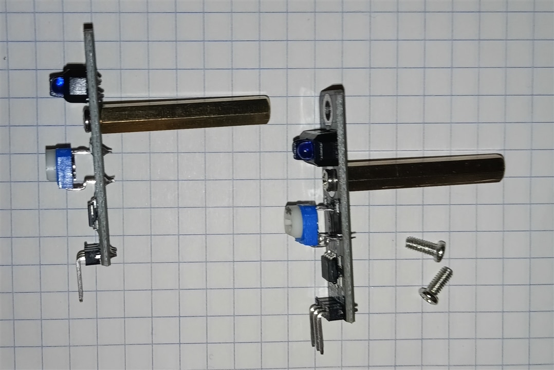

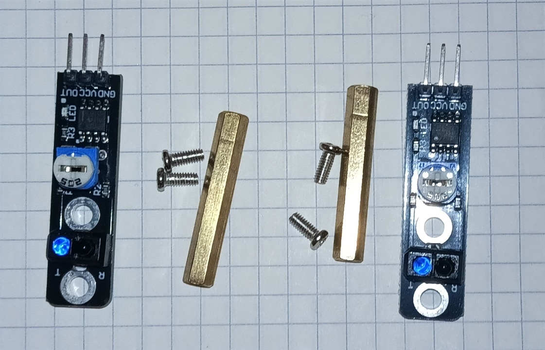

Hardware Wiring Diagram
Each IR tracking sensor module typically uses a 3-pin or 4-pin breakout board:
1. Left Tracking Sensor (TRACKING_PIN_L)
  • VCC Pin: Connects to 5V (or 3.3V, depending on sensor specifications).
  • GND Pin: Connects to GND (Ground).
  • OUT / Signal Pin: Connects to Analog Pin A2.
2. Right Tracking Sensor (TRACKING_PIN_R)
  • VCC Pin: Connects to 5V (or 3.3V).
  • OUT / Signal Pin: Connects to Analog Pin A3.
Pin Mapping Summary
Sensor Component Module Pin Arduino UNO Q Pin Wire Function
Left Sensor VCC 5V Power supply
GND GND Common ground
OUT / DO A2 Left line detection signal
Right Sensor VCC 5V Power supply
OUT / DO A3 Right line detection signal
Electrical Notes
  • Internal Pull-Ups: The code configures the pins using pinMode(A2, INPUT_PULLUP) and pinMode(A3, INPUT_PULLUP). This activates the microcontroller's built-in pull-up resistors, keeping the signal high by default and stabilizing digital state reads (HIGH vs LOW).
  • Digital Reading: Although A2 and A3 are labeled as analog input pins on the Arduino header, the digitalRead() function processes them as standard digital binary inputs (returning 0 or 1).
