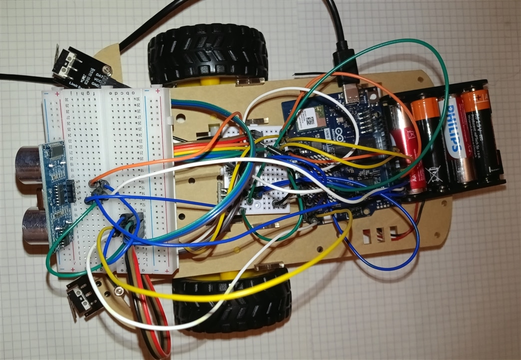

An autonomous tracking system can easily collide with static roadblocks. To mitigate this risk, we add an Ultrasonic Distance Module (HC-SR04). This sensor proactively measures the distance to upcoming obstacles by calculating the time-of-flight of high-frequency audio pings.To prevent software lag, we supply a 30,000 microsecond hardware limit to the pulseIn() function. This prevents the script from freezing if the sensor misses an echo pulse. If the calculated clearance falls beneath 30 cm, the robot suspends line tracking and maneuvers away.
Here, the vehicle gains a contact-free defensive boundary. While navigating autonomously, if the ultrasonic sonar module captures a barrier closing within 30 cm, the robot overrides line following to execute a sharp evasive turn away from danger.

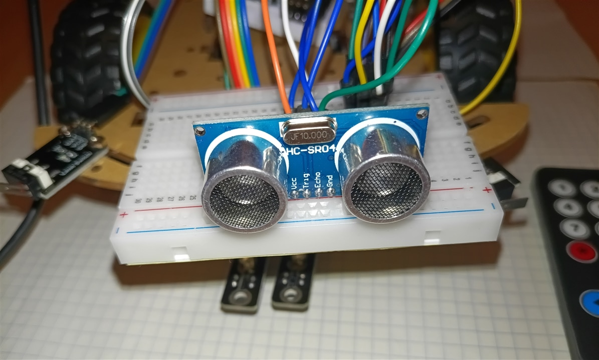

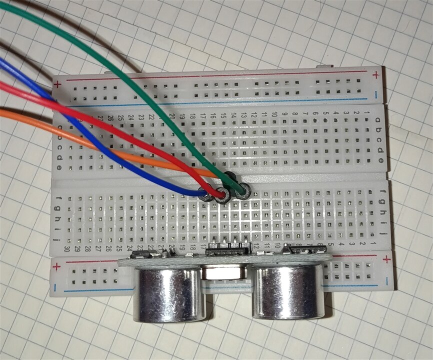

The sensor module is mounted on the contact board:
The complete vehicle intended for testing looks as follows:

1. Hardware Pin Definitions
Pin assignments for the HC-SR04 sonar module:
// Ultrasonic HC-SR04 Sonar Pins
const int TRIG_PIN = 4;
const int ECHO_PIN = 3;
2. Pin Setup in setup()
Configures TRIG_PIN to output pulses and ECHO_PIN to listen for returning sound waves:
// Ultrasonic Sonar pins configuration
pinMode(TRIG_PIN, OUTPUT);
pinMode(ECHO_PIN, INPUT);
