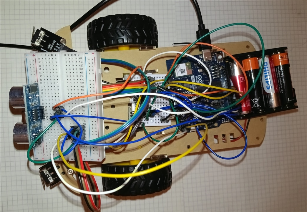

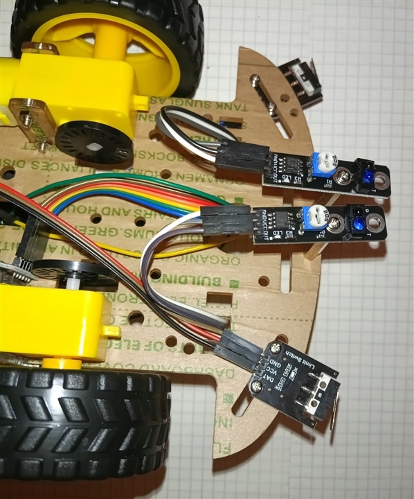

Ultrasonic sensors can miss low-profile objects, clear glass, or acoustic-absorbing fabrics. To handle these blind spots, we add physical Tactile Bumper Switches (CollisionPin_L, CollisionPin_R) as a final layer of defense.To manage all these inputs, the code uses a Strict Priority Hierarchy inside the core runtime evaluation loop:Priority 1 (Highest): Tactile Impact Check. If a physical collision is registered, the robot stops everything, backs up, and executes a wide turning maneuver.Priority 2 (Medium): Ultrasonic Proactive Clearance. If an object is detected within 30cm, the robot performs a quick corrective turn to avoid an accident.Priority 3 (Lowest): Standard Path Following. If both safety systems report a clear path, the robot continues tracking the line.

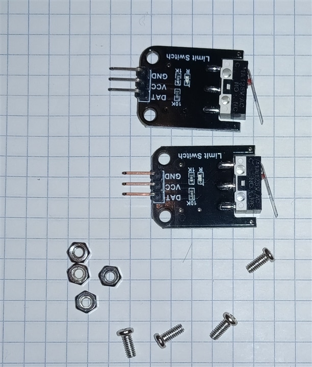

The full software build adds tactical mechanical bumper microswitches routed to pins A4 (18) and A5 (19). This program runs a rigorous hierarchy matrix: physical bumper triggers grab immediate absolute priority (initiating multi-second reversing maneuvers), sonar triggers handle medium-priority non-contact adjustments, while line following proceeds only when both safety nets report a clear path.
Here is the final, production-ready source architecture merging all four functional modules:
The primary addition is the support for physical collision sensors (bumpers) along with a 3-level safety hierarchy for handling obstacles.
1. Pin Definitions and Escape Speed
// Physical Tactile Bumpers (Mapped to pins A4 and A5 on Arduino)
const int COLLISION_PIN_L = 18; // Pin A4
const int COLLISION_PIN_R = 19; // Pin A5
const int ESCAPE_SPEED = 195; // Specific heavy escape/evasive speed vector

Added two new pins corresponding to the left (A4 / digital pin 18) and right (A5 / digital pin 19) physical collision microswitches/bumpers.
Defined ESCAPE_SPEED = 195, a dedicated motor speed used during longer backing-up and evasive maneuvers triggered by physical impacts.
2. Sensor Initialization in setup()
// Set as INPUT to match the original sponatenous logic of Elecrow modules
pinMode(COLLISION_PIN_L, INPUT);
pinMode(COLLISION_PIN_R, INPUT);
Explanation: Sets the bumper pins as standard digital inputs (INPUT). These modules send a high signal (HIGH / 1) to the pin when pressed.
3. Safety Hierarchy Logic in loop()
In autonomous mode (MODE_AUTONOMOUS), the code now executes operations based on a 3-level priority hierarchy:
Step 1: Read Bumper States (Binary Code)
int collisionState = (digitalRead(COLLISION_PIN_L) == HIGH ? 1 : 0) * 2 + (digitalRead(COLLISION_PIN_R) == HIGH ? 1 : 0);
Creates a bitwise variable collisionState with the following possible values:
  • 0 – No collision.
  • 1 – Right-side collision.
  • 2 – Left-side collision.
  • 3 – Central collision (both bumpers pressed).
Priority 1: Physical Impact Response (Bumpers)
This is the top priority, handling cases where the robot has physically made contact with an obstacle (e.g., an object below the ultrasonic beam):
if (collisionState > 0) {
  Serial.print("TACTILE COLLISION TRIGGERED. Code: ");
  Serial.println(collisionState);
  switch (collisionState) {
    case 1: // Right collision -> Reverse for 2s, then turn left for 2s
      driveMotors(ESCAPE_SPEED, 0, ESCAPE_SPEED, 0); delay(2000);
      driveMotors(ESCAPE_SPEED, 0, 0, ESCAPE_SPEED); delay(2000);
      break;
    case 2: // Left collision -> Reverse for 2s, then turn right for 2s
      driveMotors(0, ESCAPE_SPEED, ESCAPE_SPEED, 0); delay(2000);
      break;
    case 3: // Central collision -> Reverse for 2s, then perform U-turn (left) for 2s
      break;
Behavior: Upon impact, the robot reverses for 2 seconds, then spins away from the side of impact for 2 seconds to clear the obstacle.

void loop() {
  // 1. Process incoming IR signals
  if (digitalRead(IR_RECEIVE_PIN) == LOW) {
    long result = readElecrowIR();
    if (result != -1) {
      lastCommand = (byte)result;
      executeCommand(lastCommand);
  // 2. Continuous Mode Execution
  if (currentMode == MODE_MANUAL) {
    if (digitalRead(IR_RECEIVE_PIN) == HIGH) {
      driveMotors(0, 0, 0, 0);
      set_led4_color(false, false, false);
      set_led3_color(0, 0, 0);
      matrix.draw(stop_icon);
    } else {
  else if (currentMode == MODE_AUTONOMOUS) {
    float distance = getDistance();
    // --- HIERARCHY LEVEL 1: Physical Impact Interception (Bumpers) ---
      set_led4_color(true, false, false); // Red alert
      set_led3_color(200, 0, 0);
        case 1: // Right-side collision -> Reverse, then turn Left
          matrix.draw(arrow_down);
          matrix.draw(arrow_left);
          break;
        case 2: // Left-side collision -> Reverse, then turn Right
          matrix.draw(arrow_right);
          break;
        case 3: // Central collision -> Reverse, then U-Turn (Left)
          break;
    // --- HIERARCHY LEVEL 2: Proactive Clearance Monitoring (HC-SR04 Sonar) ---
    else if (distance < 30.0) {
      Serial.println("Obstacle detected by Sonar! Turning left...");
      driveMotors(MOTOR_SPEED, 0, 0, MOTOR_SPEED); // Evade Left
      set_led4_color(true, false, false);          // Red warning
      delay(300);
    // --- HIERARCHY LEVEL 3: Standard Path Routine (Line Tracking) ---
    else {
      int trackL = digitalRead(TRACKING_PIN_L);
      int trackR = digitalRead(TRACKING_PIN_R);
      int trackState = (trackL * 2) + trackR;
      switch (trackState) {
        case 0: // Off track -> Stop
          break;
        case 1: // Right sensor active -> Turn Right
          driveMotors(0, TRACK_SPEED, TRACK_SPEED, 0);
          set_led4_color(false, false, true); // Blue
          set_led3_color(0, 0, 200);
          break;
        case 2: // Left sensor active -> Turn Left
          driveMotors(TRACK_SPEED, 0, 0, TRACK_SPEED);
          break;
        case 3: // Both sensors active -> Move Forward
          driveMotors(0, TRACK_SPEED, 0, TRACK_SPEED);
          set_led4_color(false, true, false); // Green
          set_led3_color(0, 200, 0);
          matrix.draw(arrow_up);
          break;
      delay(10);
