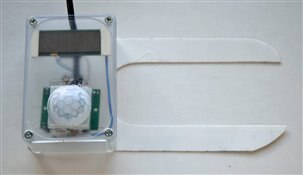

For the solution to be effective, it should be easy to implement by non technical persons, and leave no permanent markings (ie holes).
Granny is unlikely to be very happy, if you intend to drill holes in her home, regardless of the overall benefits.
I've overcome this with my PIR mount.  ( detailed here eLDERmon Final Assembly  )
This is safe, easy to manufacture, low cost and effective.

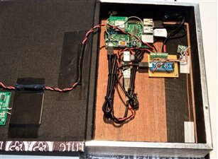

The business end of this (Raspberry Pi, EnOcean Pi and its connections) need to be protected and hidden away, and a suitable enclosure that doesn't look out of place, was another consideration.
Hence 'The Book' was conceived.

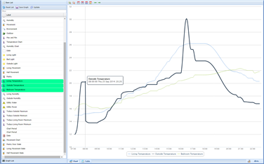

Data showing trends is best seen in graphs, and while OpenHAB has graphing capabilities, the fixed format was not flexible enough for my solution.
HABmin is an add-on that among other things provides the flexible graphing necessary to gather the information required to make informed decisions. (see  eLDERmon Graphs )
This example shows just three data sources, but clearly indicates the thermal gain by having the curtains open on a sunny day.
It also shows they were open before the sun rose, and therefore indicates someone was up.
