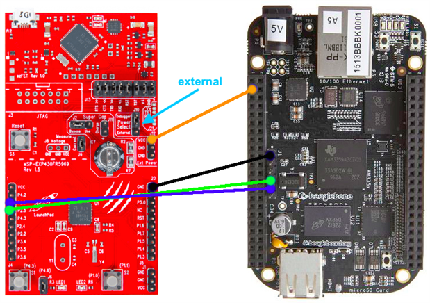

Control
The control the fan, I have a 433MHz transmitter module attached to the MSP430FR5969 which in turn is controlled by OpenHAB on the Beaglebone Black over UART.
This is the connection diagram between the MSP430 and the BBB:
MSP430FR5969Beaglebone Black
Ext Power VCCP9-3 (3.3V)
GNDJ1-1 (GND)
P2.6 (UART1 RX)J1-5 (UART0 TX)
P2.5 (UART1 TX)J1-4 (UART0 RX)
image Note: Don't forget to set the "Power Select" jumper to "External".
I then proceeded to configure openHAB with the serial binding, just like I did in the Forget Me Not Challenge: [CaTS] ForgetMeNot - Week 4: Arduino-OpenHAB communication
The only difference, is that instead of /dev/ttyACM0, it should be /dev/ttyO0.
With everything configured, it was now possible to turn the power socket ON and OFF from OpenHAB. This will later be triggered automatically by a rule, depending on the measured amount of dust.
I've used a small fan for testing, but will be using a bigger one with a filter attached to it, for the final setup.
The pieces are finally coming together, and with only two weeks remaining in the challenge I'm glad things are starting to work.
