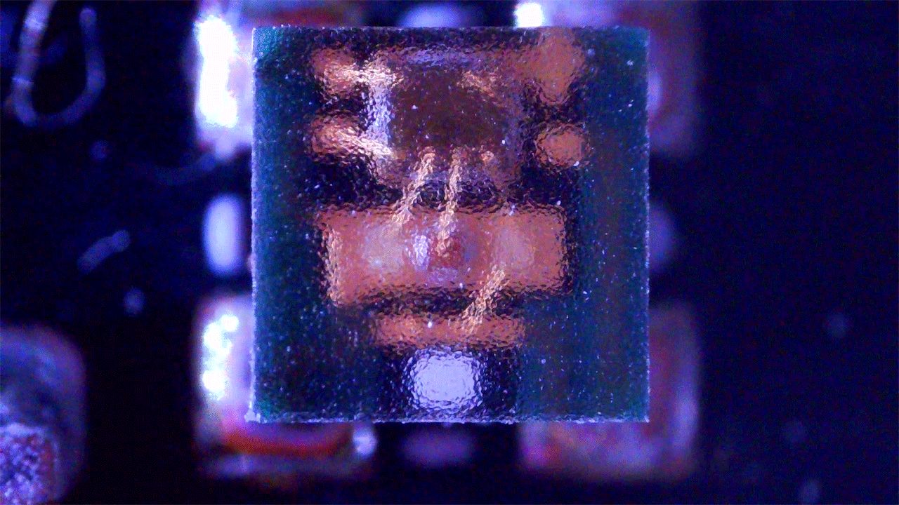

  1. Unboxing & Looking Closer
    In this posting, I unbox the challenger kit and take a close microscopic view of the supplied components. If you want to see the LEDs up close – this is the post for you!

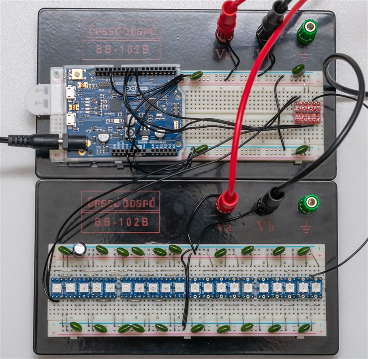

  3. Lighting Up My Life (a little bit)
    In this post, I get the WL-ICLEDs soldered in the previous post to light up, using the provided Arduino Zero and the FastLED library. It was a marathon breadboarding effort, spanning two breadboards! I perform some extra experiments looking at wavelength spectra, PWM frequency and current consumption. I also test the LEDs on the RP2040 platform – rather surprisingly, it all just worked and it seemed one can get away without a level shifter (albeit, being a bit borderline in some cases).

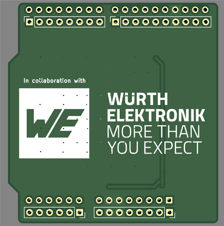

  4. Designing a PCB & 3D Printable Mechanicals
    It was time to get serious and put my money where my mouth is – it was time to draw up a design and get the PCBs manufactured and shipped to me. I design both a ring light, featuring 3 x 18 LED strings of different types, and an Arduino shield featuring 25 LEDs of another. I also design the 3D printable carrier for the device – this post containing various design files.

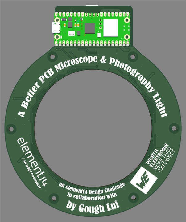

  5. PCBs Arrive & The Ultimate Skills Test
    I was afraid that the PCBs wouldn’t arrive in time, but everything did with ample time to spare especially as the contest was extended. This time, the LEDs were much smaller – so I go through a key list of “secrets to success” which I use. In the end, construction was successful and designed some additional 3D prints to improve the diffusion and beam characteristics of the light output. There were no casualties or lost LEDs, and the FastLED demo reel worked just fine.

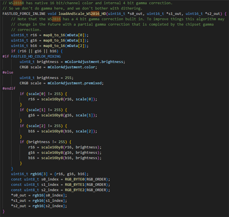

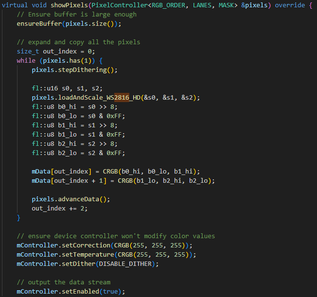

The 48-bit LED Problem
In the line-up of WL-ICLEDs, there is only one 48-bit type (1312121320437), so I didn’t have much experience with it. The protocol is similar to WS2812B for timings, but transactions required twice the amount of data per pixel. Of the 16-bits, four bits were used for current scaling and 12-bits for PWM data. Now, I thought this was corresponding to the WS2816 type selection in the FastLED library code, but when ramping up and down, it’s not smooth – instead it “flashes” up and down in brightness … coincidentally, sixteen times throughout the full range.
As FastLED is optimised for 8-bit pixel data, it’s not the best library to use if you want to make use of the full resolution. But for my non-demanding application, it would be (theoretically) fine.
One easy way out was to ditch four bits and use the low four bits only. Unfortunately, now you have a 12-bit pixel … which is worse than the 24-bit pixels. But I did confirm that doing this does get rid of the strobing as it doesn’t “cross” over the higher four bits when scaled up to 16-bits. The cause was simply that FastLED considers the pixels’ 16-bits to be “all data” while in reality, you can think of the first four bits more as a “multiplier” and the last 12-bits as data.
I went tracing through the library. The showPixels function for the WS2816 type shows how it manipulates eight bit values into an upper and lower, making them twice as long, but also needing to disable certain library corrections so they don’t modify the upper and lower bytes.
The secret seems to be in the loadAndScale_WS2816_HD function. I don’t understand it all – it mainly deals with corrections and whatnot, but it does type conversions with map8_to_16 and scale16by8.
From what I can see, they are naïve mathematical functions. But it’s not appropriate for this case – so I decided to simply replace the loadAndScale_WS2816_HD function with my own version that uses the bottom 12-bits by shifting in the 8-bit value and leaving the four LSB empty. Then, I take the upper four bits and set them to a fixed value – all ones for the maximum current. But I also need to take into account the global brightness value (as I’m using that in this sketch) which results in this function:
    FASTLED_FORCE_INLINE void loadAndScale_WS2816_HD(uint16_t *s0_out, uint16_t *s1_out, uint16_t *s2_out) {
        // GOUGH'S VERSION - DO NOT USE CURRENT SCALING BITS, FIX TO MAX
        uint16_t r16 = mData[0]<<4;
        uint16_t g16 = mData[1]<<4;
        uint16_t b16 = mData[2]<<4;
        uint8_t brightness = mColorAdjustment.brightness;
        if (brightness != 255) {
                r16 = scale16by8(r16, brightness);
                g16 = scale16by8(g16, brightness);
                b16 = scale16by8(b16, brightness);
        r16 = r16 | 0xF000;
        g16 = g16 | 0xF000;
        b16 = b16 | 0xF000;
        uint16_t rgb16[3] = {r16, g16, b16};
        const uint8_t s0_index = RGB_BYTE0(RGB_ORDER);
        const uint8_t s1_index = RGB_BYTE1(RGB_ORDER);
        const uint8_t s2_index = RGB_BYTE2(RGB_ORDER);
        *s0_out = rgb16[s0_index];
        *s1_out = rgb16[s1_index];
        *s2_out = rgb16[s2_index];
It's not going to work with all of FastLED’s features, but it does work for the features I need and the flickering is now gone!

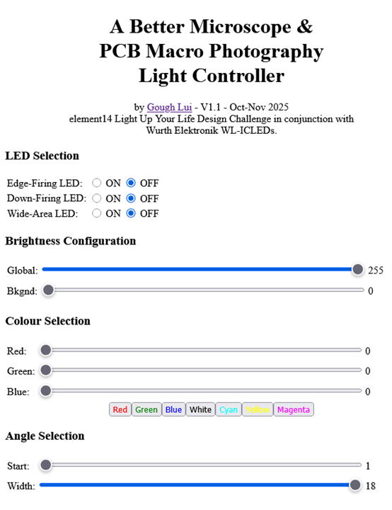

One thing I noticed about the last version of the software was that every browser request took some time to process and update on the LEDs, but in that time, another update could end up queueing up at the controller causing things to lag. As a result, I put in a JavaScript throttle to reduce the rate at which requests were being made. While this was successful at avoiding overload, it wasn’t as smooth as I would have liked, being about 10fps.
To improve this, I remembered that the Raspberry Pi RP2040 chip actually has two cores, so instead of having a single loop function, I can have two. Now the main core handles the web requests, while the second core writes to the LEDs. To prevent “sheared” writes, I implemented a set of flags which either cause the web request to wait for the write to LED to complete, or for the next LED write to be skipped while a web request was being processed. This way, I could update at a much nicer 30fps or so, making it feel almost silky smooth.
The updated code is provided in the “The Final Final Result” section.

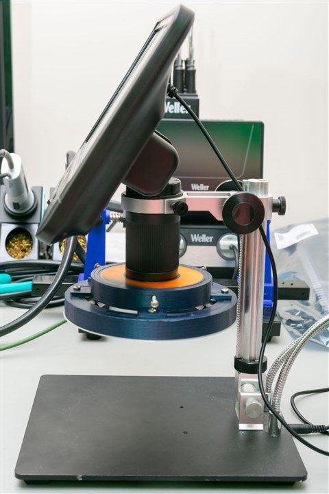

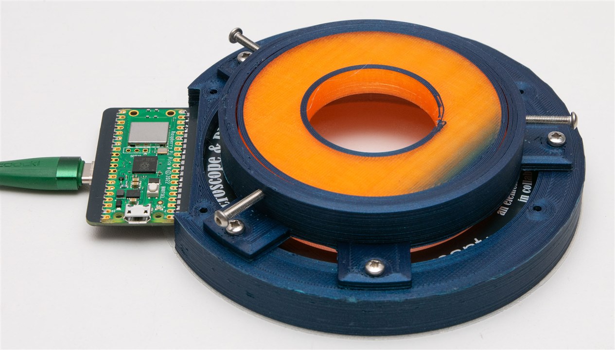

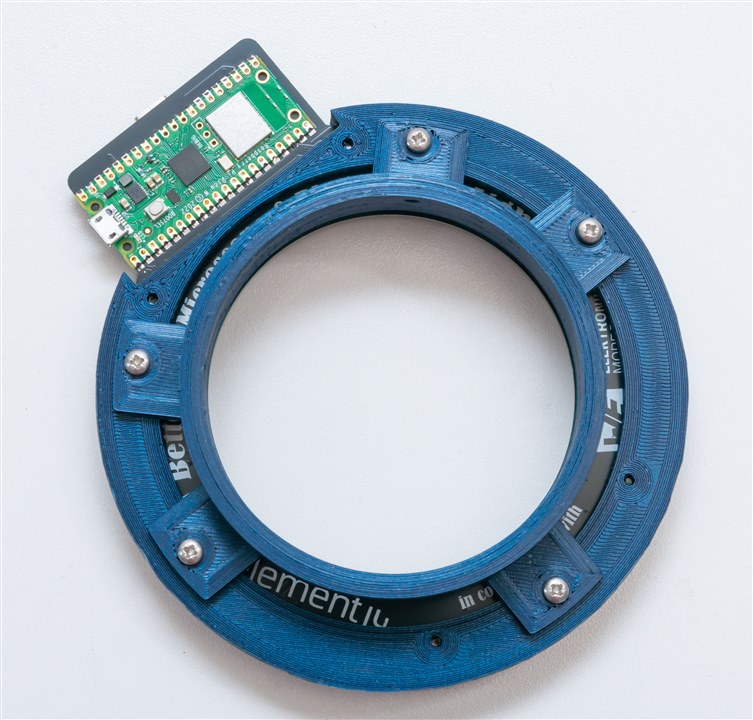

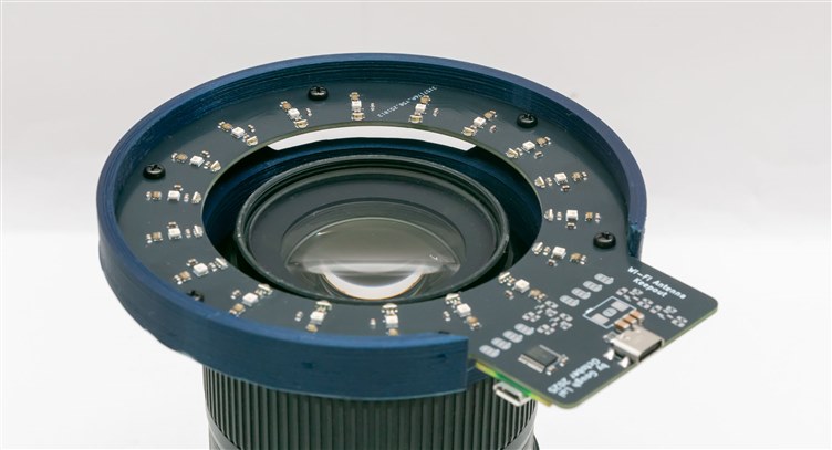

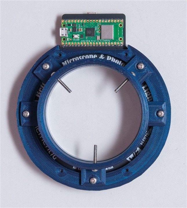

Fitting to a Microscope
From the outset of the project, I wanted the light to fit both my Nikkor 105mm macro lens and my microscope. The lens would set the minimum size of the inner diameter of the ring, while the microscope would set the maximum diameter of the ring (as it would otherwise collide with the stand). There wasn’t much wriggle room there, but I figured it would be possible.
While I did have screw holes for threading in M3 screws to cinch down onto the tube of the digital microscope, I didn’t count on the fact that the longest screws I had on hand simply weren’t long enough to make it fit.

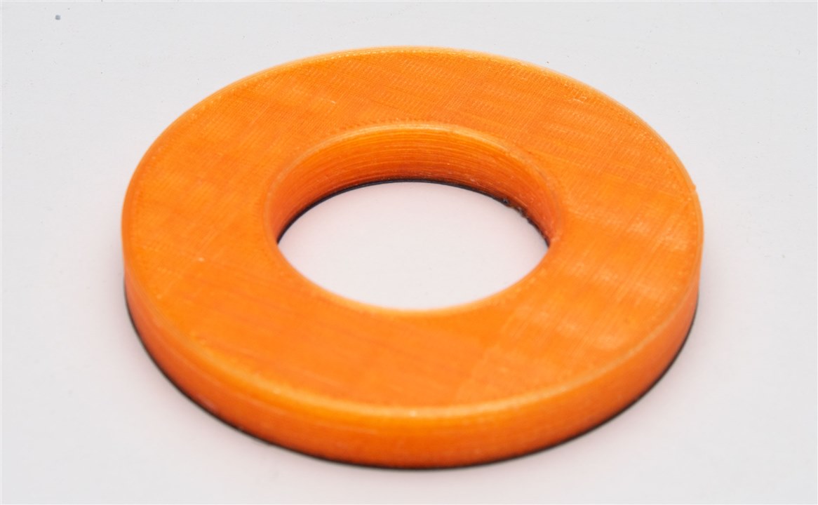

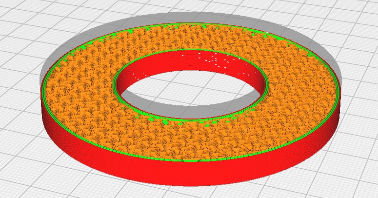

To fix this, I had to design a simple “donut” adapter. This was basically a solid 3D printed “ring” which could be put into the ring light and would friction-fit onto the end of the microscope. Alternatively, I could have made it two “half” donuts so the screws can “clamp” it together.
I managed to print it in translucent orange PLA that I had left over – not as nice as the metallic blue stuff, but I was in a hurry and I didn’t know if it will work so I used what was lying around.
It fits inside the ring light holder as such … and is kept captive by the screws.

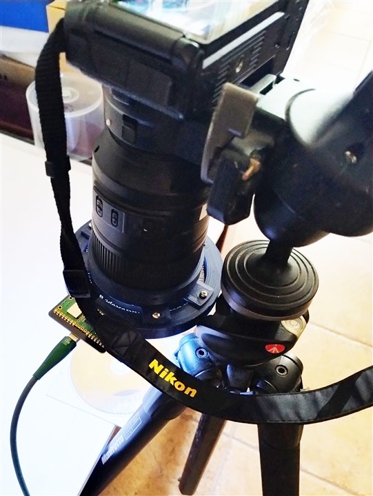

image image
No surprises – it’s a tight fit but it’s on the microscope! All that design work pays off! The printable STL design is provided in the “The Final Final Result” section.

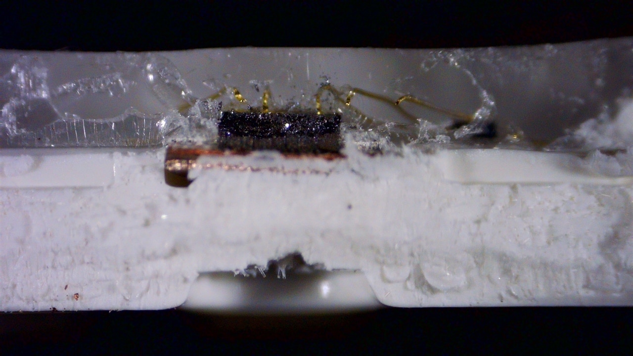

Co-ordinating Colour?

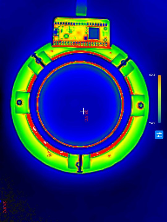

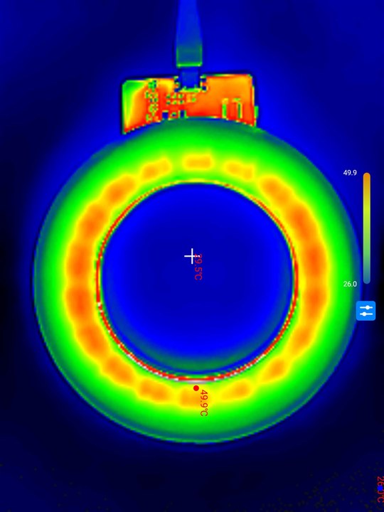

One thing I did notice was a minor LED-to-LED colour variation. This seemed particularly noticeable for the 48-bit type (1312121320437), but because of the way the LEDs were soldered, I can’t discount the possibility of overheating causing the issues. Nor could I discount the possibility of the LEDs themselves operating hot which can cause drifts in output.

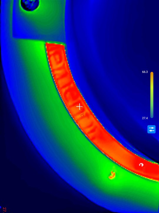

To test this, I tried running the ring light at full brightness white with all LEDs turned on for about half-an-hour. While it was running, I realised the diffuser and baffles acted as blankets, keeping the heat in, while the small slits on the back and the clearance around the edge-firing LEDs were the only way that heat would get out. I kept as much of the copper plane on the PCB to aid heat dissipation, but it was still only a two-layer board with 1oz copper.
From the back, we were already seeing a peak of 62.4 degrees C from the back side of the PCB.
Looking through the slit, it was more like 66.3 degrees C. This is “toasty” but perhaps not lethal to the LEDs (at least, not immediately). It does remind us that we need to be mindful of the total heat dissipation and junction temperature, especially in large arrays. But as long as we don’t turn everything on, things should be cooler.
From the front, with the diffuser on, there was no clear pattern as to any particularly hot spots, which is good. But one needs to be a bit careful too, as the temperature is pretty much at the glass transition temperature of PLA.
Perhaps a metal-core circuit board for high-density LED deployments is advisable, backing onto a heatsink for better thermal dissipation.

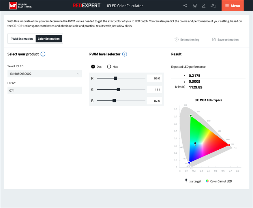

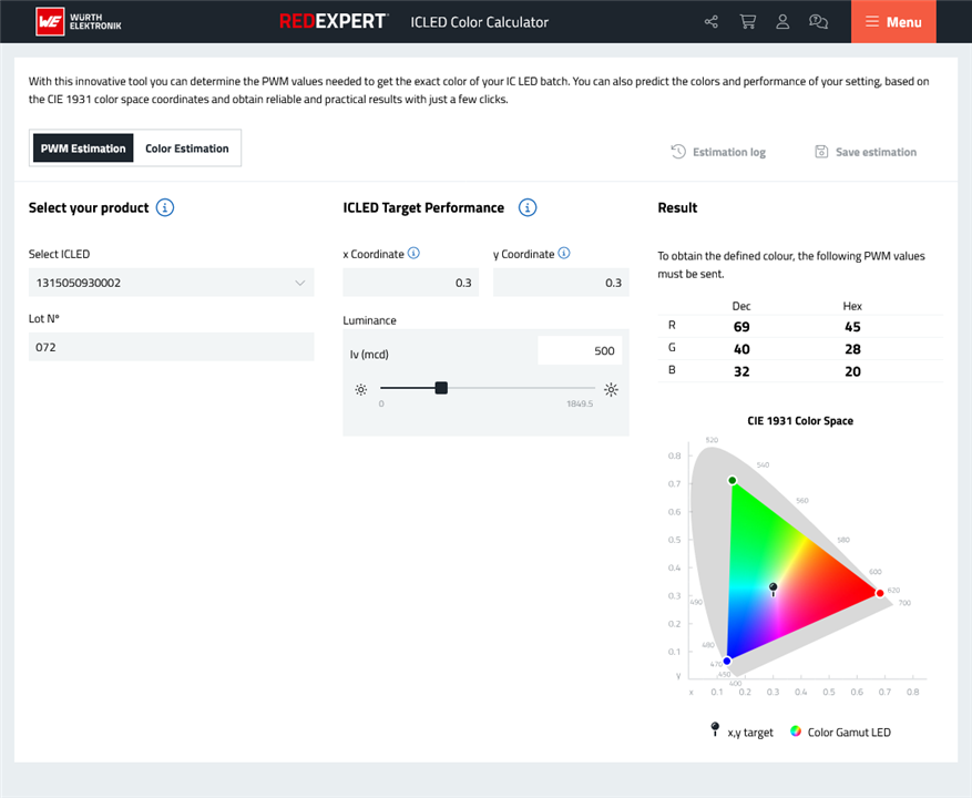

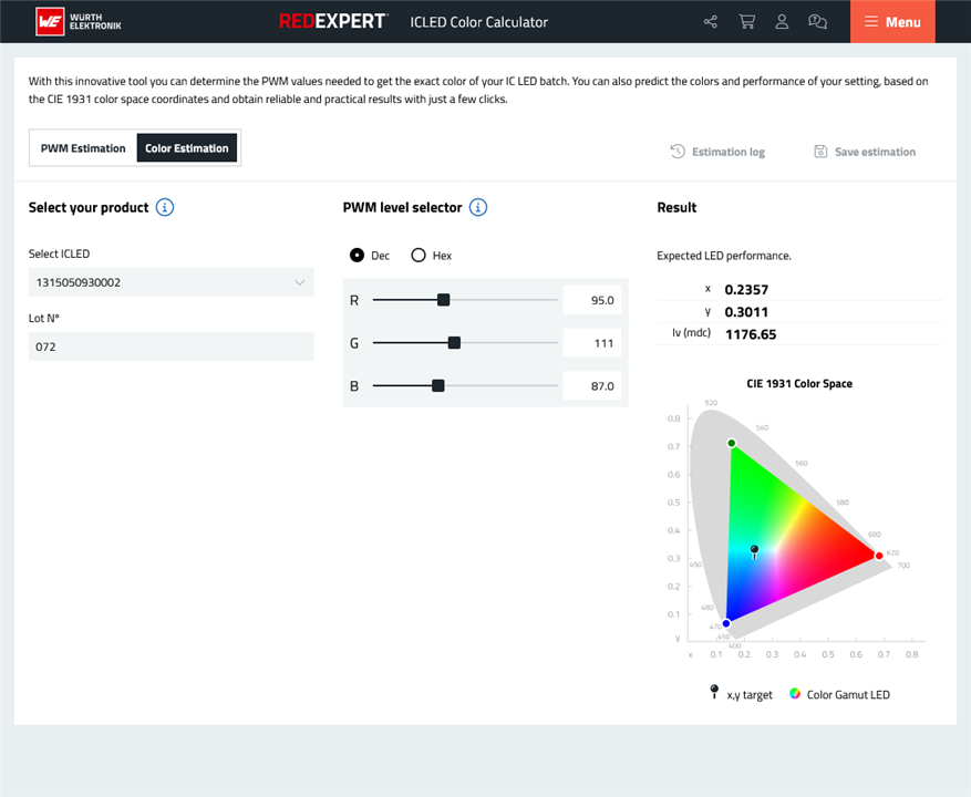

But then there is also the issue of batch-to-batch LED variation. I spotted a colour calculator on Würth Elektronik’s site, so I thought it’d be worth a mention. You don’t have to have a RedExpert account to use it but you do get more features (ability to save, recall logs) if you do.
image image
The two main modes are PWM Estimation and Colour Estimation.
Changing the batch does change the result, so it is likely based on real production data. However, it is only available for one type of LED at this time.

output8.innerHTML = slider8.value\;\
slider8.addEventListener(\"input\", function() {\
  output8.innerHTML = this.value\;\
</script>\

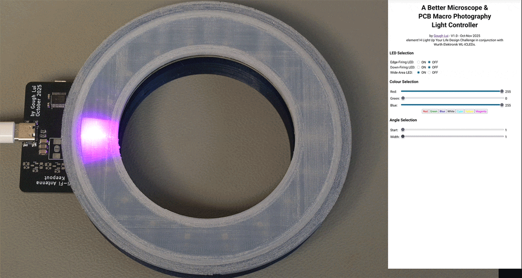

<h3>Colour Selection</h3>\
<table><tr><td>Red:</td><td><input type=\"range\" id=\"led_rvalue\" name=\"led_rvalue\" min=\"0\" max=\"255\" value=\"0\"></td><td><span id=\"rsliderValue\"></span></td></tr>\
<script>\
const slider1 = document.getElementById(\"led_rvalue\");\
const output1 = document.getElementById(\"rsliderValue\");\
output1.innerHTML = slider1.value\;\
slider1.addEventListener(\"input\", function() {\
  output1.innerHTML = this.value\;\
</script>\
<tr><td>Green:</td><td><input type=\"range\" id=\"led_gvalue\" name=\"led_gvalue\" min=\"0\" max=\"255\" value=\"0\"></td><td><span id=\"gsliderValue\"></span></td></tr>\
<script>\
const slider2 = document.getElementById(\"led_gvalue\");\
const output2 = document.getElementById(\"gsliderValue\");\
output2.innerHTML = slider2.value\;\
slider2.addEventListener(\"input\", function() {\
  output2.innerHTML = this.value\;\
</script>\
<tr><td>Blue:</td><td><input type=\"range\" id=\"led_bvalue\" name=\"led_bvalue\" min=\"0\" max=\"255\" value=\"0\"></td><td><span id=\"bsliderValue\"></span></td></tr></table>\
<script>\
const slider3 = document.getElementById(\"led_bvalue\");\
const output3 = document.getElementById(\"bsliderValue\");\
output3.innerHTML = slider3.value\;\
slider3.addEventListener(\"input\", function() {\
  output3.innerHTML = this.value\;\
</script>\
<center><button onclick=\"setColour('Red')\" style=\"color: red;\">Red</button>\
<button onclick=\"setColour('Green')\" style=\"color: green;\">Green</button>\
<button onclick=\"setColour('Blue')\" style=\"color: blue;\">Blue</button>\
<button onclick=\"setColour('White')\">White</button>\
<button onclick=\"setColour('Cyan')\" style=\"color: cyan;\">Cyan</button>\
<button onclick=\"setColour('Yellow')\" style=\"color: yellow;\">Yellow</button>\
<button onclick=\"setColour('Magenta')\" style=\"color: magenta;\">Magenta</button></center>\
<script>\
function setColour(rcolour) {\
if (rcolour == \"Red\") {\
slider1.value = 255;\
slider2.value = 0;\
slider3.value = 0;\
} else if (rcolour == \"Green\") {\
slider1.value = 0;\
slider2.value = 255;\
slider3.value = 0;\
} else if (rcolour == \"Blue\") {\
slider1.value = 0;\
slider2.value = 0;\
slider3.value = 255;\
} else if (rcolour == \"White\") {\
} else if (rcolour == \"Cyan\") {\
slider1.value = 0;\
} else if (rcolour == \"Yellow\") {\
slider3.value = 0;\
} else if (rcolour == \"Magenta\") {\
slider2.value = 0;\
</script>\
<h3>Angle Selection</h3>\
<table><tr><td>Start:</td><td><input type=\"range\" id=\"led_ivalue\" name=\"led_ivalue\" min=\"1\" max=\"18\" value=\"1\"></td><td><span id=\"isliderValue\"></span></td></tr>\
<script>\
const slider4 = document.getElementById(\"led_ivalue\");\
const output4 = document.getElementById(\"isliderValue\");\
output4.innerHTML = slider4.value\;\
slider4.addEventListener(\"input\", function() {\
  output4.innerHTML = this.value\;\
</script>\
<tr><td>Width:</td><td><input type=\"range\" id=\"led_wvalue\" name=\"led_wvalue\" min=\"1\" max=\"18\" value=\"18\"></td><td><span id=\"wsliderValue\"></span></td></tr></table>\
<script>\
const slider5 = document.getElementById(\"led_wvalue\");\
const output5 = document.getElementById(\"wsliderValue\");\
output5.innerHTML = slider5.value\;\
slider5.addEventListener(\"input\", function() {\
  output5.innerHTML = this.value\;\
</script>\
<br>\
<!--<center><input type=\"submit\" value=\"Submit\"></center>-->\
</form>\
<script>\
document.addEventListener(\"DOMContentLoaded\", function() {\
const i1 = document.getElementById(\"led_edge\");\
const i2 = document.getElementById(\"led_down\");\
const i3 = document.getElementById(\"led_wide\");\
const i1b = document.getElementById(\"led_edge2\");\
const i2b = document.getElementById(\"led_down2\");\
const i3b = document.getElementById(\"led_wide2\");\
const i4 = document.getElementById(\"led_rvalue\");\
const i5 = document.getElementById(\"led_gvalue\");\
const i6 = document.getElementById(\"led_bvalue\");\
const i7 = document.getElementById(\"led_ivalue\");\
const i8 = document.getElementById(\"led_wvalue\");\
const i9 = document.getElementById(\"led_gbright\");\
const i10 = document.getElementById(\"led_bgbright\");\
i4.addEventListener(\"input\", throttle(formfunc,40));\
i5.addEventListener(\"input\", throttle(formfunc,40));\
i6.addEventListener(\"input\", throttle(formfunc,40));\
i7.addEventListener(\"input\", throttle(formfunc,40));\
i8.addEventListener(\"input\", throttle(formfunc,40));\
i9.addEventListener(\"input\", throttle(formfunc,40));\
i10.addEventListener(\"input\", throttle(formfunc,40));\
i1.addEventListener(\"change\", formfunc);\
i2.addEventListener(\"change\", formfunc);\
i3.addEventListener(\"change\", formfunc);\
i1b.addEventListener(\"change\", formfunc);\
i2b.addEventListener(\"change\", formfunc);\
i3b.addEventListener(\"change\", formfunc);\
i4.addEventListener(\"change\", formfunc);\
i5.addEventListener(\"change\", formfunc);\
i6.addEventListener(\"change\", formfunc);\
i7.addEventListener(\"change\", formfunc);\
i8.addEventListener(\"change\", formfunc);\
i9.addEventListener(\"change\", formfunc);\
i10.addEventListener(\"change\", formfunc);\
</script>\
</body>\
</html>";

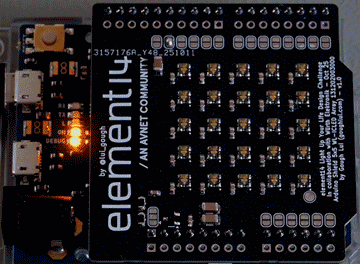

A Small Bonus Arduino Shield
As I have covered in a blog, I did create an Arduino shield as a bonus and this was demonstrated in Part 6. Just a reminder that it exists, thus I have been able to test every type of WL-ICLED there is!
image image
Bill of Materials & Design Resources
The PCB electronics bill of materials are as follows:
  • 27 x 100n 0603 capacitors
  • 3 x 100u 1206 capacitors
  • 25 x Würth Elektronik 1312020030000 WL-ICLED
  • 2 x 8-pin 2.54mm header pins
  • 1 x 6-pin 2.54mm header pins
  • 1 x 10-pin 2.54mm header pins
  • 1 x BSS138 n-channel MOSFET
  • 2 x 10k 0805 resistors
  • 1 x Arduino Zero
The gerbers for the shield can be downloaded here: LUYL-Gough-Lui-arduino-shield.zip

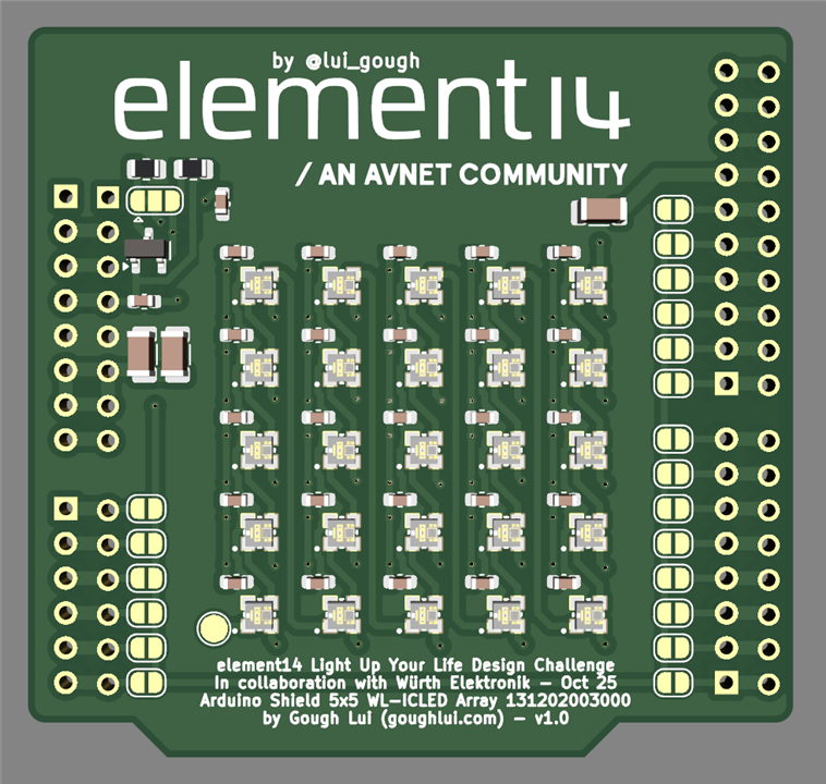

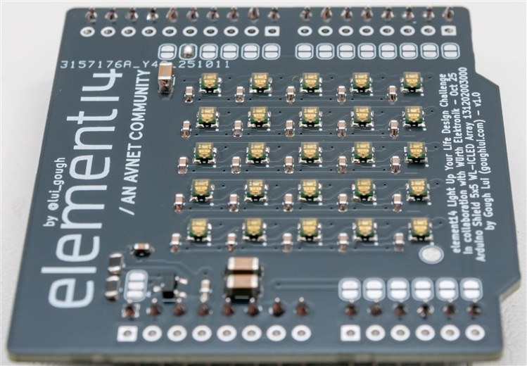

Future Work and Improvements
The shield itself was pretty straightforward. On the whole, I would have loved to have more LEDs to play with, thus a larger, more denser matrix could be formed which could have lent itself to more graphical uses. But considering what we were provided as challengers, I think it’s about as good as I could have expected – no LEDs lost or damaged!

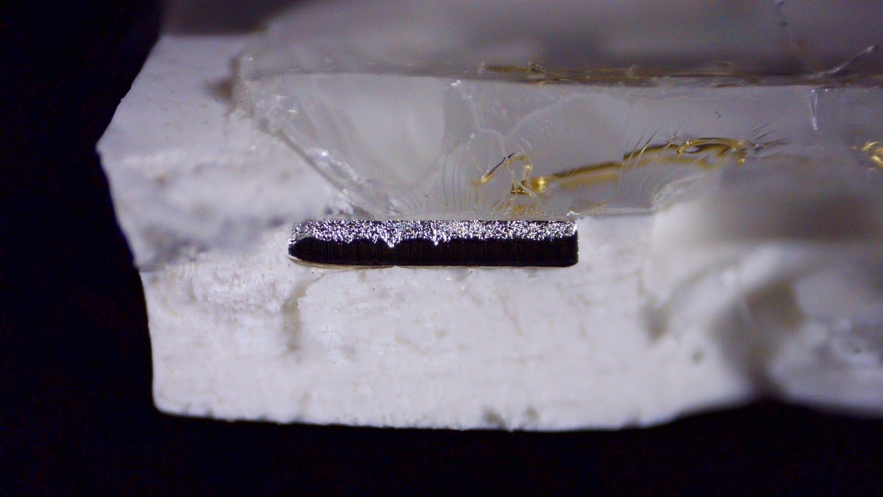

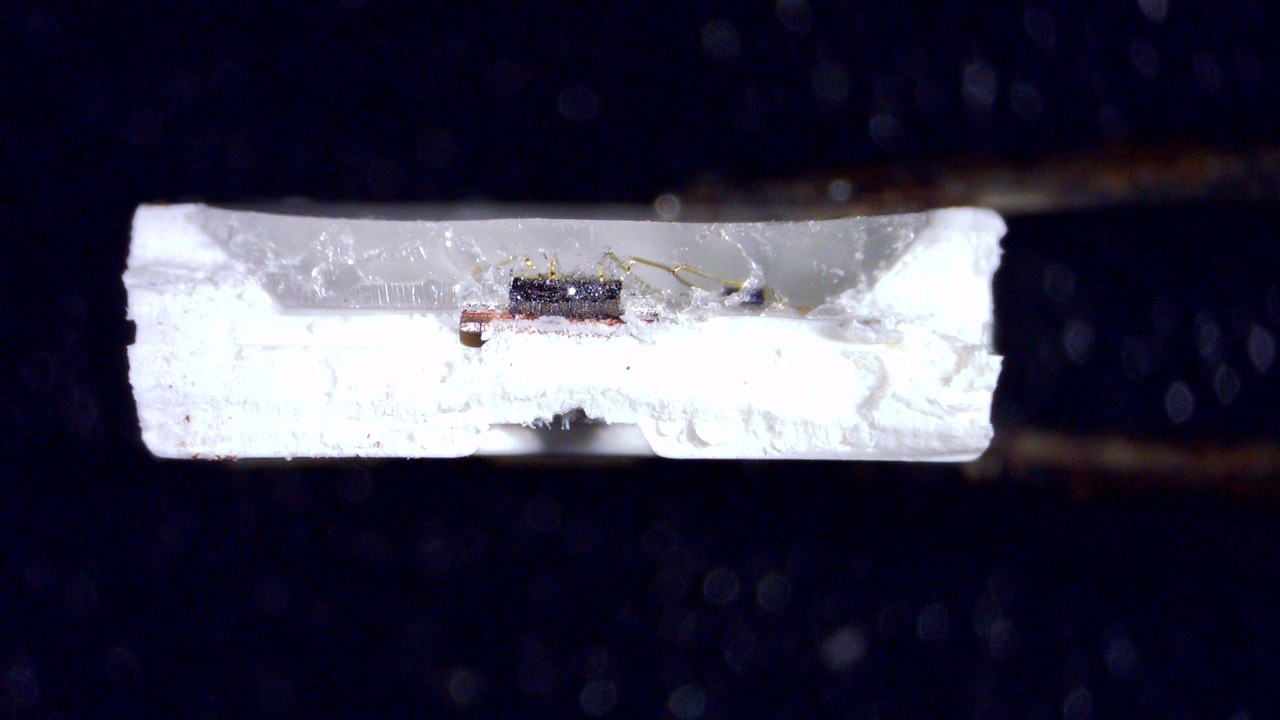

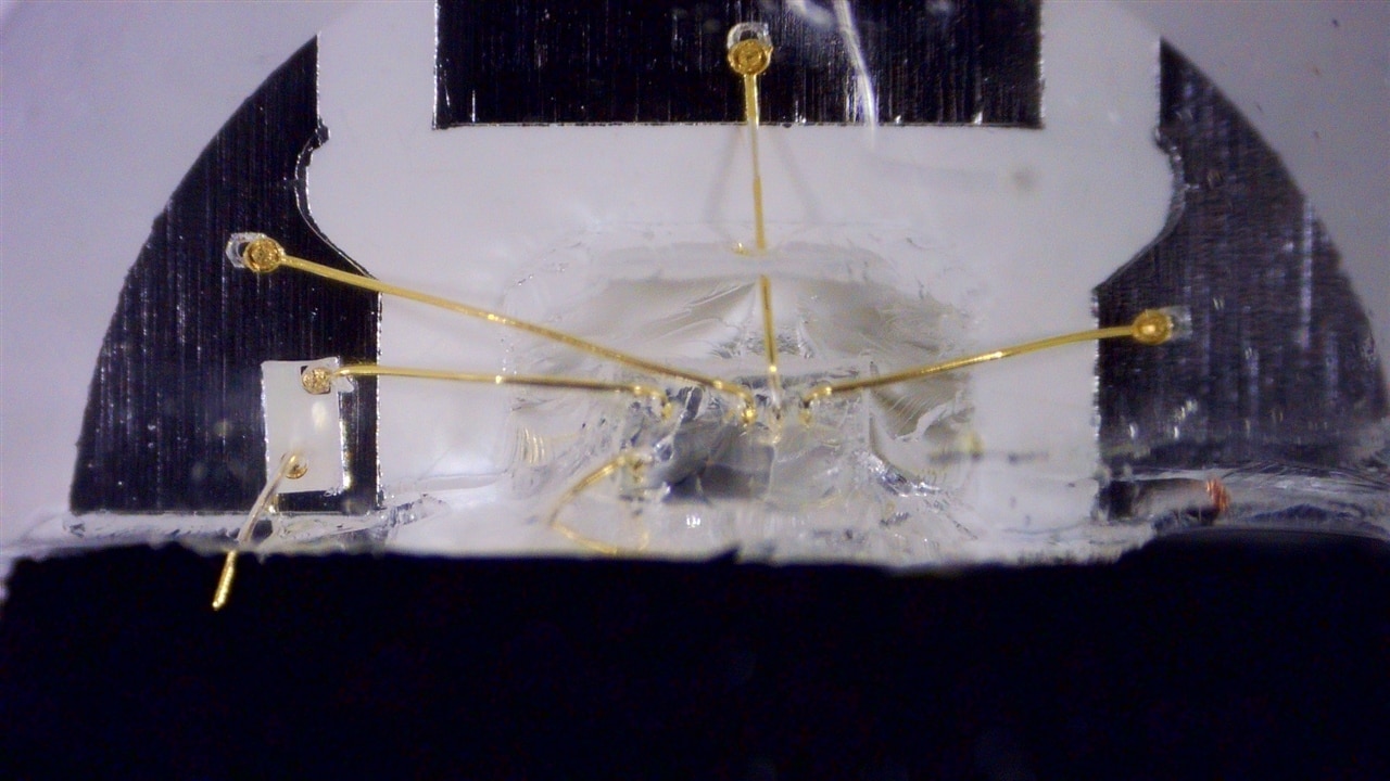

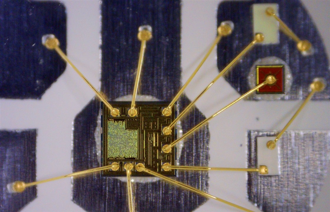

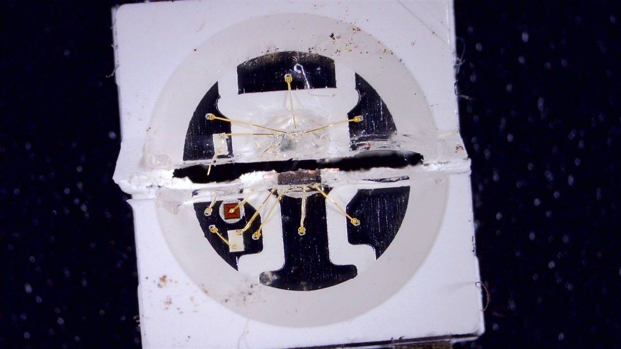

Destruction: By Special Request
At the end of my Part 1 post, balajivan1995 asked if I had any spare LEDs, whether I could cut them apart for a cross-section. Well, I didn’t see much of a point in doing it initially, but now that my project has come to its end, I decided to get my sharpest Knipex side-cutters and give it a go.
I tried for a cut right through the middle – unfortunately, this fractured the IC itself which, due to it being a silicon crystal, somewhat shattered in its brittle nature and pulled out of one half, leaving behind the wire bonds.
The half with the chip still in it, as viewed from the side. The thickness of the chip is evident as is the path of the wire bonds.
Looking closer, it seems that the base is perhaps tinned copper? An LED chip is seen in the background.
The cut went through one of the pads on the other side – a nice cut, but doesn’t show much detail.
That half of the chip practically disappeared – likely it fell out or was crumbled into dust.
I didn’t expect to see much, but I thought I should at least honour the request. My apologies to the LED gods (if there is one) for spoiling this particular device.

  • balajivan1995
    balajivan1995 over 1 year ago +1
    Cross section looks like landscape from "The Thing" movie. The gif image with LED light orbiting around looks cool as well. Thank you very much for remembering the request! And I hope the LED gods…

  • beacon_dave
    beacon_dave over 1 year ago +1
    Excellent results. Have you tried getting the light ring closer to the subject ? Usually having the key light around 30 to 45 degrees to the subject gives good 3D results. Another feature might be…

  • beacon_dave
    beacon_dave over 1 year ago in reply to Gough Lui
    Given the magnification you are working at, then perhaps a simple extension tube between the lens and the ring light to lower it. Perhaps even telescopic for some height adjustment. An initial quick handheld test would perhaps reveal if it was worth pursuing. I was just playing around with a small LED torch here on the engraved R-Pi case logo and a 20-30deg angle made it really pop out whereas 45deg worked well on an embossed coin.
    For the DSLR, then a set of Kenko extension tubes might also do the trick.
    Basic multiple key lights could perhaps be done with a slider that offsets a second key from the first. It can probably inherit the same parameters as the first in most cases. But as you say, the user interface could get quite complex the more you want to control.
    Feathering could be worth a try. Then you need the rate of feathering adjustment and perhaps an easing curve option...  Slight smile
