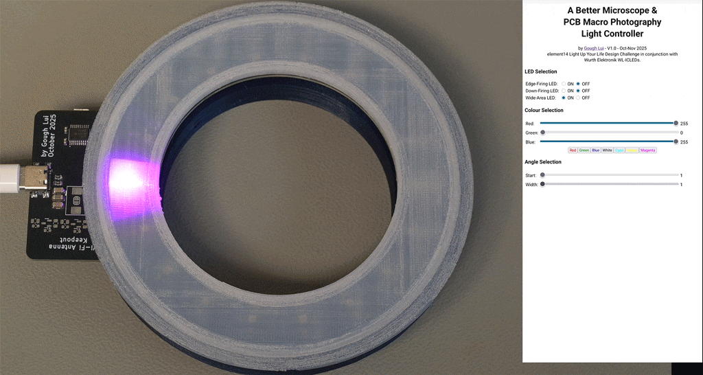

In the video above, I show you the current state of the project – both my ring light and my Arduino shield. It’s not perfect, but it’s functional and pretty much all I need for the time being. But it did take some intense work over a day or two to make it all happen.

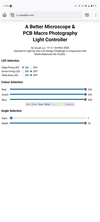

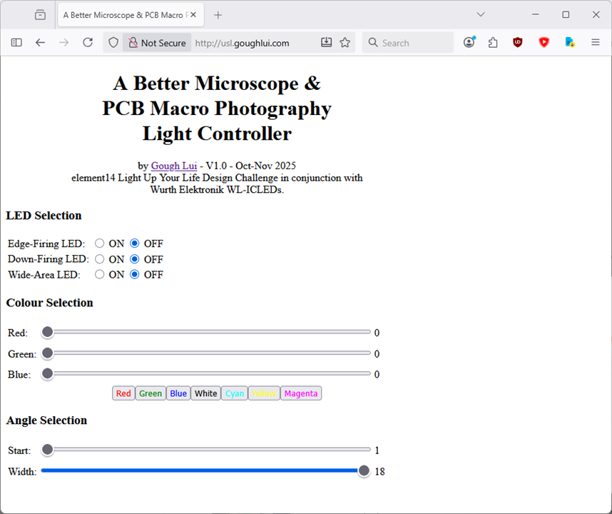

Wrangling Javascript and HTML
This is perhaps where I spent most of my time. When I was growing up, I wrote only the most basic HTML in my computer science classes – coding webpages by hand was the “norm”, so I’ve continued that tradition with coding by hand. Unfortunately for me, I’m coding inside an Arduino program, which means that every double-quote has to be escaped (\”) or else you get build issues, and the webpage was essentially one long multi-line string, broken up by “\” so the formatting quirks definitely added to the challenge.
The first step was simply to add all the UI elements needed to the form – this includes the radio buttons and sliders. Then, to format them nicely, I wrapped them inside <table> tags, the old-fashioned, pre-CSS way. For JavaScript, rather than have a .js file as a separate file to be fetched from the server, I’ve inlined them in plenty of <script> blocks. It isn’t ideal, but it does the trick.
But to really get the webpage working in the way I desired took several iterations and wrangling with JavaScript and HTML:
  • Originally, the webpage is designed as a form that can be filled, the submit button is pushed and then the page is reloaded. This is very slow. Imagine every change of lighting setting needs the submission of a form and a full reload.
    To fix this requires using JavaScript functions and the fetch API to do an AJAX request (nothing to do with cleaning, it’s Asynchronous JavaScript and XML). After reading up this posting on Dev+Coffee, I decided to define a function (formfunc) which does the actual posting of the form to the server. Then, I defined a whole stack of event listeners for change and input for each of the fields so that when a change happens, the formfunc function is called to submit the form. A key feature is that this doesn’t cause the page to reload – the form previously had its submit button (now commented out in HTML) that I had originally configured to submit without reloading (as formfunc returns false) to reduce page flicker and latency.
  • Unfortunately, since any change or change-in-motion will cause form submissions to fire continually, I found that the Pico W was having trouble keeping up with the stream of events, so a “throttle” was needed to cut down events. Thanks to this webpage, I managed to integrate the throttle into the code so that when the sliders are moved, the results go through the throttle function which thins out the calls to formfunc to 5Hz at most.
  • While I had some sliders, I wanted the actual value of the sliders to be visible and for the sliders to be big enough to actually use. That was easily fixed by adding a width parameter to the range input type using the inline CSS <style> tag, affecting all sliders in one fell swoop. Then JavaScript code was used to get the value from the slider and write it into the <div> for the value. I could have made these text inputs so users could type a precise value into the box, but somehow I felt that this wouldn’t be necessary as the LEDs aren’t exactly calibrated for colour accuracy nor is exact colour necessary most of the time.
  • I needed some pre-set colour buttons to load the most common RGB values to avoid needing to fiddle around with each slider for common operations. This was achieved with <button> tags which were set to call a JavaScript function I called setColour which received a string argument with the colour required. It would go through an “if tree” and apply the RGB values to the sliders and update the associated <div>s accordingly.
  • It needed to appear a reasonable size and fill the screen on mobile – so I used the <style> tag to set the page width to 640px, but also a <meta> tag to set the viewport. With the two, it seems to load with reasonable size in both mobile and desktop environments.
It took a lot of jumping back and forth between different resources online to learn the necessary tricks to make it all work, plus some time sitting in the element inspector and console scratching my head when things didn’t work. Ultimately, I think I have prevailed in the end.

If intending to use the code yourself, the SSID and passphrase need to be provided for your network. Also, note that the USB-CDC serial port is enabled for debugging and some initial connection details are printed to this port for debugging purposes, while other prints are mostly suppressed to save processing time.
Using the code, I was able to display the controller on both phone and PC.
image image
The HTML form is all hand-coded, so it’s ugly, and it uses outdated table tags to format the page. But it’s good enough for me for now – even though the Pico W has some space in its flash to accommodate larger and more complex “blobs” of data, I’d rather keep it simple for performance and ease of debugging.
To make it a bit more convenient, I’ve added a static DNS bind for usl.goughlui.com to the IP address of the Pico W (and reserved its DHCP address lease, so it will always be at the same address). This is a bit more tedious than mDNS (which could be easily re-added as it was in the original PostServer example), but in my experience, mDNS resolution on my network isn’t all that robust.
The full behaviour is on show in the video above, but if you skipped it, here’s a short, animated GIF showing the width and angle selection in operation:
Perhaps better performance could be had by explicitly calling the FastLED.show() call on the other core, so it has a consistent refresh rate and doesn’t interfere with the server client checking call, but that does increase the risk of “tearing” (a partial refresh) occurring.

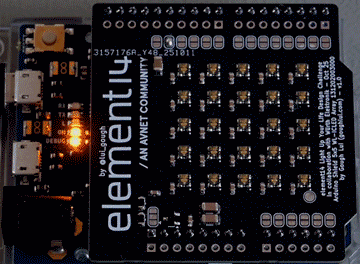

While the ring light above is the main event, I decided that the shield also needed some love, so I decided to make it into a tiny signboard displaying a fixed message instead. To do this, I used Adafruit NeoMatrix (https://github.com/adafruit/Adafruit_NeoMatrix) and its dependencies which were auto-installed by Arduino IDE.
Part of the challenge is that the display is only 5x5, so a five-pixel high font needed to be used. Luckily for me, Adafruit_GFX has one – TomThumb.
The code is as follows and is based on the included demo in the NeoMatrix library:

I modified it for the longer message, to change the font, but also to pseudorandomly change the colour by selecting an RGB value where each of R, G and B were in the range of 64 to 255, so excessively dark colours would not be chosen, but at the cost to saturation.
The full result is visible in the video above – but an abbreviated animated GIF is below for everyone else:
