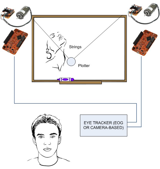

The subject of this installment is project EyeLiner by Ambrogio Galbusera (amgalbu). The goal of this project is to give the ability for disabled people to create art, even if they are paralyzed from the neck down. To do this, Ambrogio will construct a robotic drawing mechanism that is controlled by eye movement. Eye tracking will be handled by a Raspberry Pi / Pi camera combo in conjunction with the PyGaze python library. The robotic drawing platform will be controlled via the NXP’s FRDM-KV31 Freedom Development Platform and FRDM-MC-LVPMSM Low-Voltage Motor Control Kit.
Ambrogio’s first project update laid out his plans on how he will get things up and running. The whole assembly will be controlled by a Raspberry Pi that tracks the user's pupils via the PyGaze Python library. The robotic drawing assembly will feature two FRDM-MC-LVPMSM Low-Voltage Motor Control Kits that act as a . They will be addressed individually by the NXP’s FRDM-KV31 Freedom Development Platform as it receives motion data from a Raspberry Pi. While a camera based eye tracker is the first choice, Ambrogio says that he would like to explore an EOG-based eye tracker if time allows.

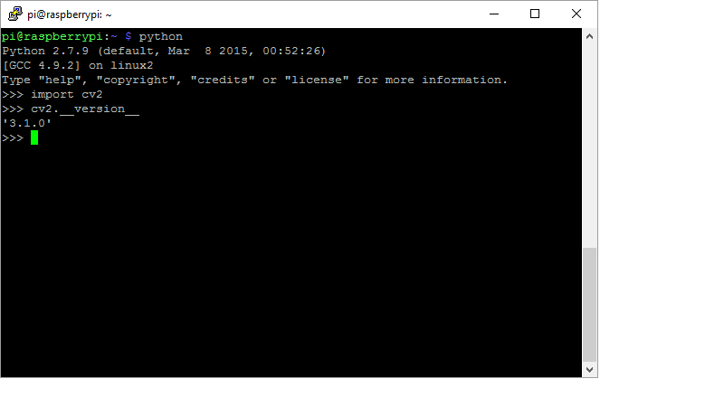

Project EyeLiner’s second and third post were all about getting the OpenCV software running on the Raspberry Pi as it is a prerequisite to getting PyGaze working correctly. Ambrogio details every step needed to get the software installed on a Raspberry Pi, including listing out all of the commands needed to get all of OpenCV’s prerequisites installed.
If working with OpenCV interest you, and the install intimidates you a little, these two post combine to make the perfect tutorial to follow if you are wanting to run the program on a Raspberry Pi. I really like it when I see challengers posting full instruction tutorials on installing Linux packages like this as they make it very easy for those at home to follow along with the project.

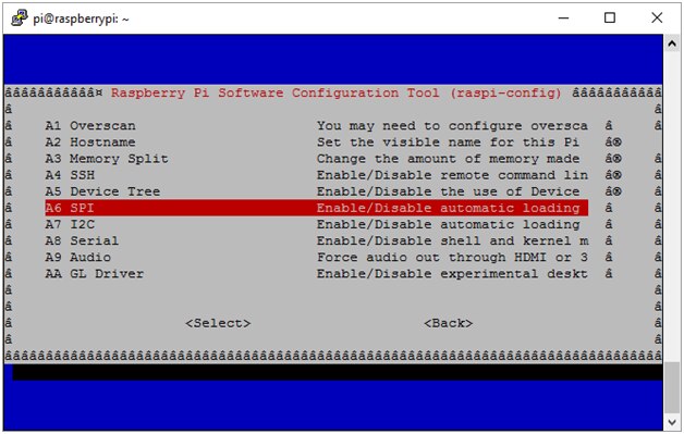

In the sixth update, Ambrogio clued us in on SPI Communication and how to get the SPI package working on Raspbian. I am sure that I have said it in the past, but I am going to say it again. Ambrogio’s project update post are exactly what I like to see in a Design Challenge. His post provide the perfect level of detail, allowing the readers at home to easily follow the project, and understand how everything works. If you are selected to be a challenger in an upcoming design challenge, I highly suggest taking an hour or so to read over Ambrogio’s post for inspiration.

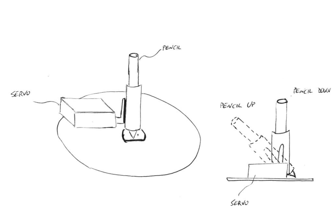

The project’s tenth update talked more about the mechanical design, this time focusing on the actual plotter itself. The purpose of the plotter is to hold a drawing instrument securely, and still be able to lift it from the paper when the polargraph is moving the plotter head to a new section of the paper. Ambrogio plans to use a servo on a tilting pen holder to accomplish this. He chose this simple design based on its low-cost and easy to build nature. “The servo will be controlled by the Raspberry Pi board. When painter blinks his or her eyes, the pencil is lifted up. When painter blinks eyes again, the pencil goes back to the vertical position,” Ambrogio concluded.

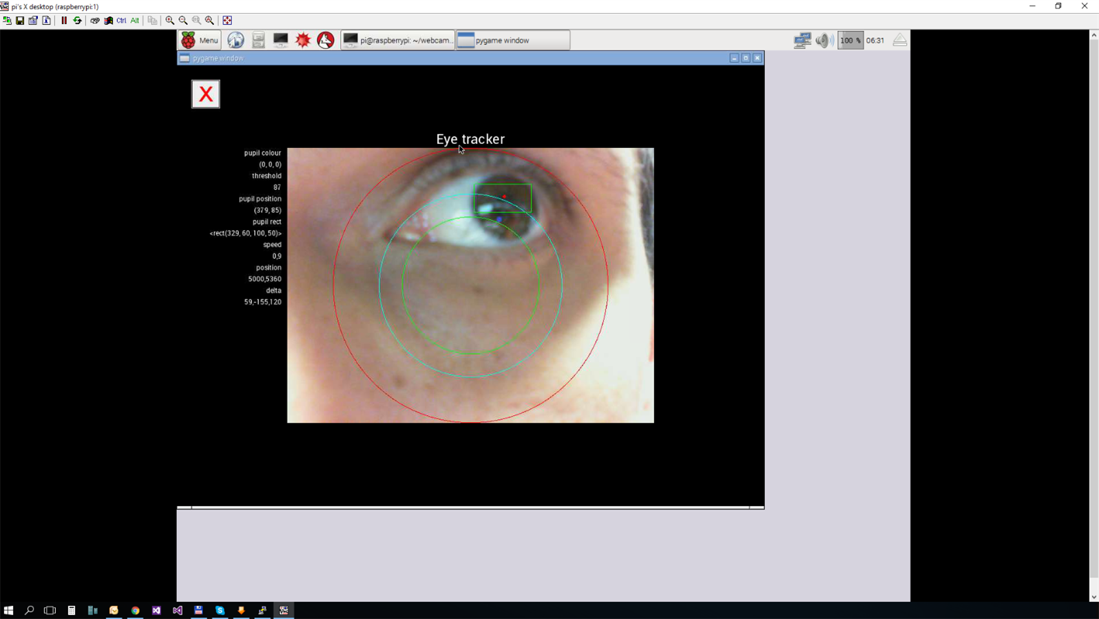

Update number eleven was all about software. In the days since his last post, Ambrogio had been hard at work writing and refining the software that he will use to track EyePrint’s user's eyes. In the image above you can see a few concentric circles. These circles are used to define where the plotter moves in relation to the eyes position and the plotters position on the paper. If the eye is centered inside the smaller green circle, the plotter stays stationary. If the user's eye moves outside of the green circles, the plotter moves in the direction the eye moved, with its speed relative to how far outside of the circles it is. For example, if the eye moves completely to the top left corner, the plotter will move very quickly in that direction. If the eye is only half way between the center circle and the top left corner it will move in that direction more slowly. Head to the link above for a more information, and a download of this software.

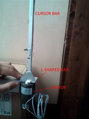

The project's main drive assembly and drawing board were the focus of update number fourteen. Ambrogio covers how he attaches the motors to the threaded rods, and how the rod is shielded in an aluminum extrusion. “Motor are fixed to an L-shaped aluminum bar. The top cover of the motor has three screw holes…” he said. “The cursor moves along a 5 mm threaded rod. The diameter is identical to the diameter of the motor shaft... The threaded rods are housed in a U-shaped aluminum bar. The bar has a 10x10 mm section, so that a bolt can slide perfectly. At the top and at the bottom of the U-shaped bar, two M6 bolts keep the threaded rod in place.“

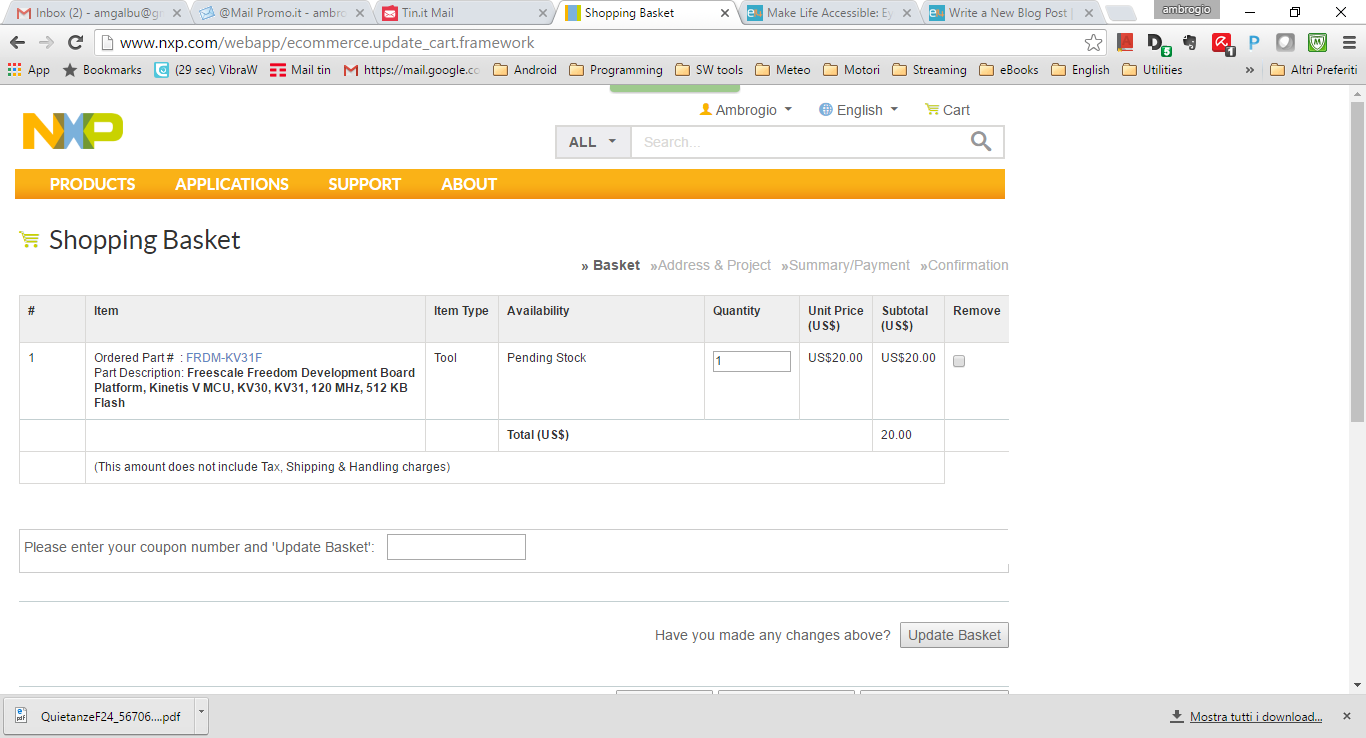

On June 21st Ambrogio broke the sad news that he was abandoning the project due to no information about a second freedom board arriving. With so much progress made over the last few weeks, I am absolutely heartbroken that I will not get to see this project finished. I am assuming that Ambrogio needs a second Freedom board and motor controller kit for the other threaded rod that is used in his polargraph. Unfortunately he also states that he will not complete the project after the competition is over, and no working prototype will be produced. He will publish all of the source code,  and while that is a major win for the open source community, I would have liked to see the project come to fruition. Either way, this was a very fun project to follow, and I wish Ambrogio the best of luck in future endeavors.
