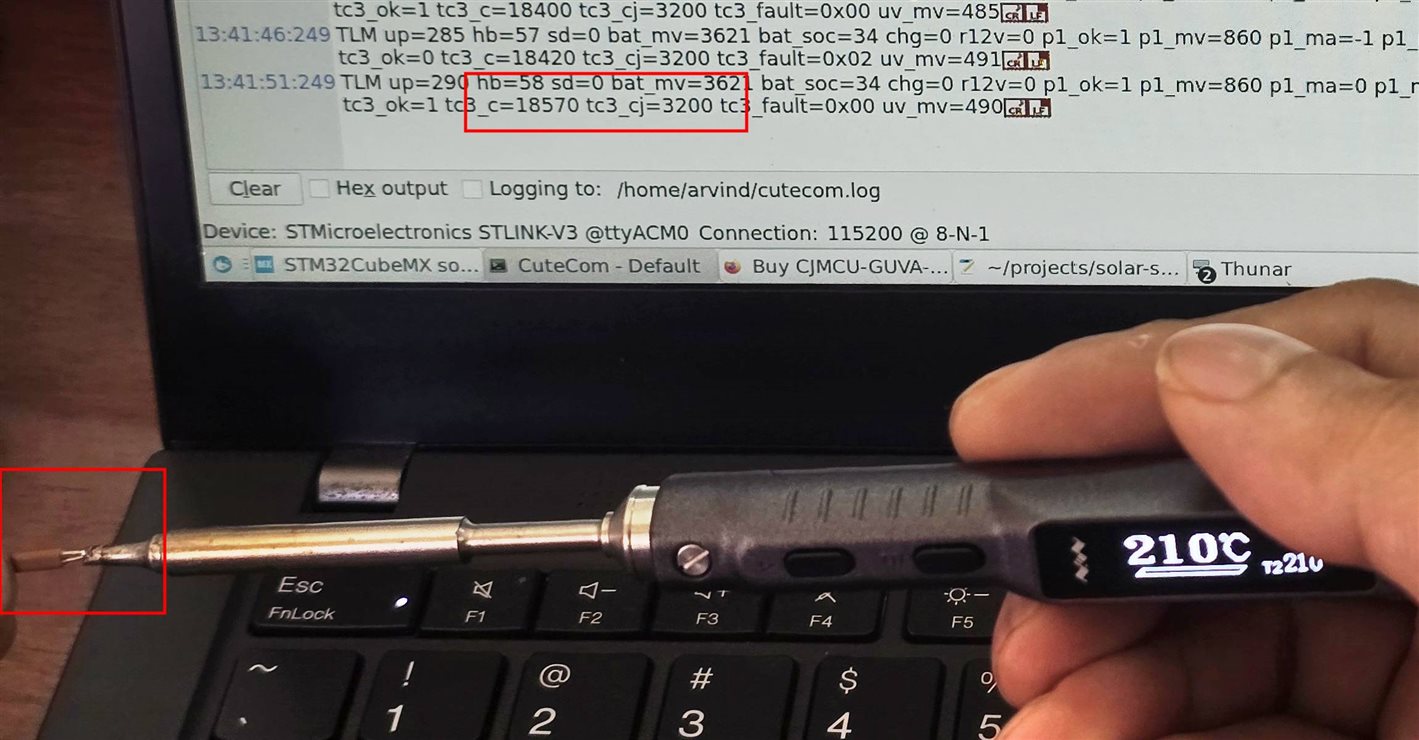

Part 6 was the MAX31855 thermocouple interface. I wired up a K-type thermocouples, to measure surface temperature.

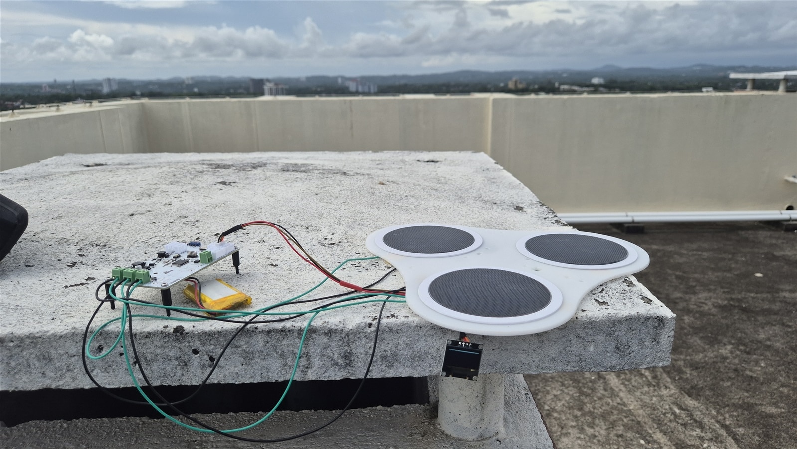

and the Mechanicals
I made a White acrylic panel using Laser cutting to keep the Panels organized with a cute triangular outline. I did add in holes for the rain sensor and UV sensor and and matching box to secure my electronics. I did not have PETG filament to 3D print the box so I replaced it with PLA for the time being. Also during the laser cutting, I somehow managed to scale up the diagram that the panel did not fit in, so I had to print a 3D spacer for a snug fit. The Wall Clip that came in with the HX94C came in handy to mount the sensor on the side of the box. I am not sure if I mentioned this before, but everything is White to effectively reduce the temperature increase of the box itself by absorbing the solar heat. Even the PCB is White.

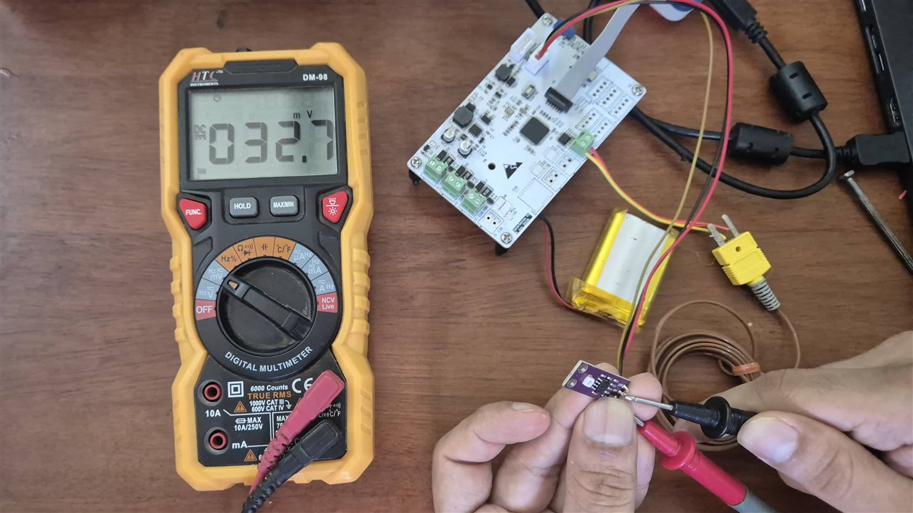

I tested everything, Sensors, SD Card, CAN but What i missed was the charging of battery. It was night and so I tested using a normal Desktop Power supply.
But as i tested further, I ran into problems
The over-voltage scenario:
With the CN3791 MPPT charger in CV mode, the cell terminal climbed to 4.41V at full charge current (CV loop not yet engaged). At that point, the pack's internal PCM over-voltage protection tripped.  the fuel gauge dropped from 4410 mV to 915 mV momentarily (chg flag to idle) and then the cell gracefully auto-recovered to a safe 4.216V OCV once charge was removed.
Key measurements (DMM at battery JST, supervised by toggling charge off):
Condition V at JST Notes
Charging 4.288 V Terminal inflated by I·R rise
Charger off (rest OCV) 4.144 V True cell state — the safety metric
Voltage difference (immediate sag) 0.144 V Resistive drop across pack impedance
Charge current measurement (via 0.1 Ω in-line shunt):
Condition Measurement Derived
Charging, V across 0.1 Ω 41.4 mV I = 41.4 mV / 0.1 Ω = 414 mA
Charging, PSU current 400 mA External reference
Battery removed, PSU current 22 mA Board + charger idle load (confirms ~390 mA went to cell)

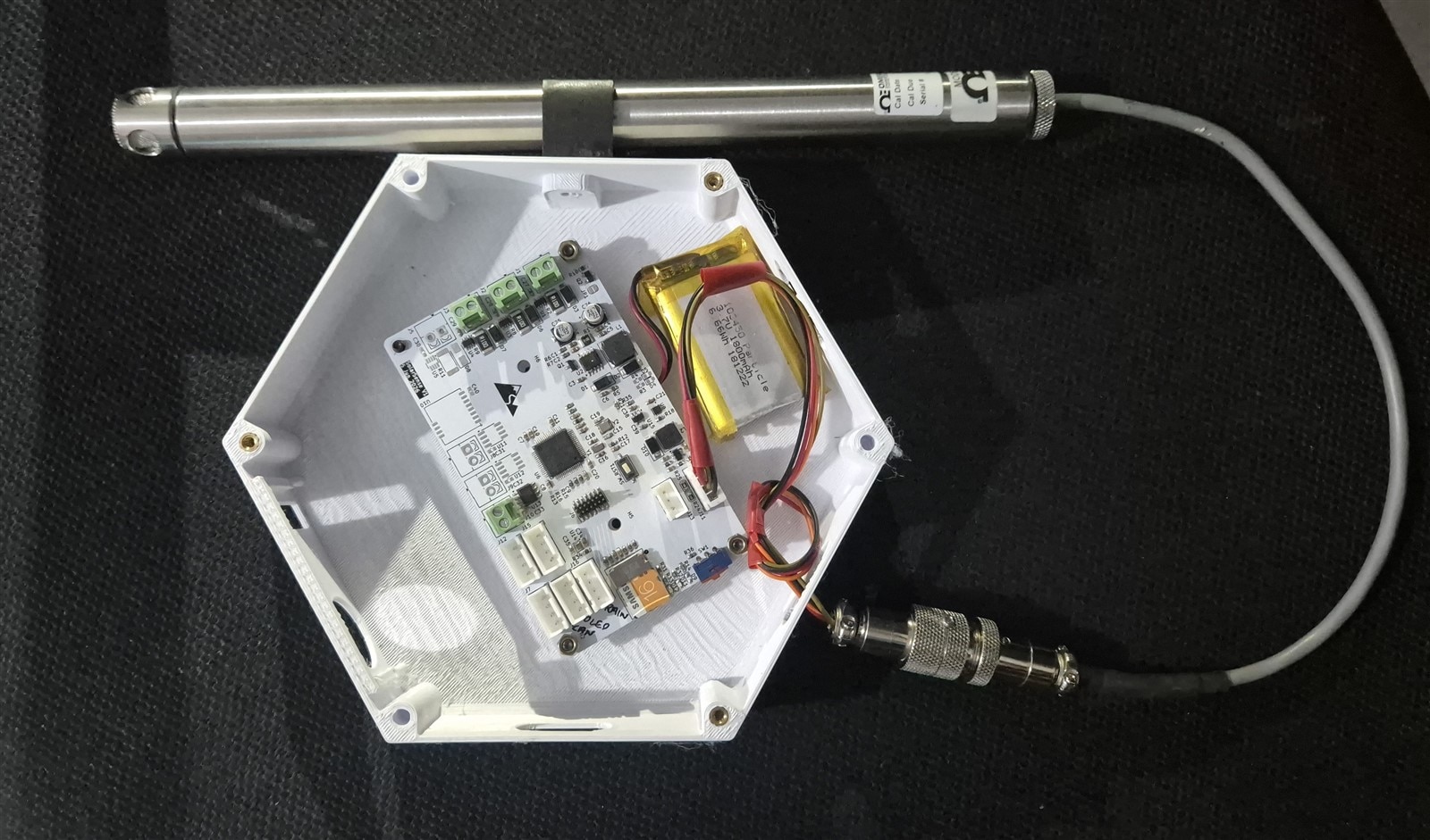

With this every unit test is completed and off to the final integration. here is the Fully wired system

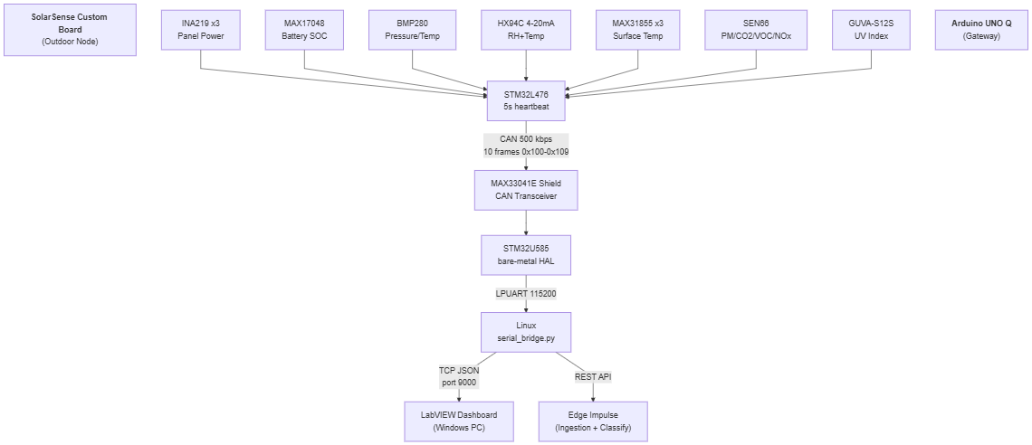

That is the full picture. Everything on the outdoor node talks to the STM32L476 over I2C, SPI, ADC, or the 4-20mA current loop. Every 5 seconds, the firmware packs all of that into 10 CAN frames and fires them out at 500 kbps. The Arduino UNO Q's STM32U585 receives those frames via the MAX33041E shield, reassembles them into a key=value text line, and ships it over to the Linux side through LPUART (/dev/ttyHS1). On the Linux side, serial_bridge.py parses that line, computes soiling ratios and UV index, and simultaneously serves a JSON dashboard to LabVIEW on TCP port 9000 while ingesting data into Edge Impulse for AI training.
The CAN Side: 10 Frames, One Snapshot
The firmware builds a SolarSenseTLM_t struct every heartbeat -- essentially a complete snapshot of every sensor at that instant -- and hands it to CAN_TLM_Send(). That function packs everything into 10 standard 8-byte frames and fires them in sequence. Each frame has a fixed ID so the receiver can decode them independently.
ID Name What's inside
0x100 SYS Battery mV, SOC, charger state, 12V rail flag, SD flag, UV mV
0x101 P1 Panel 1: ok flag, bus mV, current (tenths mA), power mW
0x102 P2 Panel 2: same
0x103 P3 Panel 3 (clean reference): same
0x104 TC Thermocouple: ok, fault, surface temp, cold junction temp
0x105 BMP BMP280: ok, board temp, pressure Pa
0x106 HX HX94C: ok, fault, RH (tenths %RH), temp (centi-degC), loop current
0x107 AQ-PM SEN66: ok, PM1.0, PM2.5, PM4.0
0x108 AQ-Gas1 SEN66: PM10, internal RH, internal T, VOC index
0x109 AQ-Gas2 SEN66: NOx index, CO2 ppm
One thing I had to think about carefully: what happens when the CAN bus is not physically connected? This problem did occur when i had a loose connection with the screw terminal connector. With AutoRetransmission=ENABLE (which the HAL sets by default), an unACKed frame sits in a TX mailbox until the bus goes Bus-Off. With 10 frames per heartbeat and only 3 TX mailboxes, you can fill up the mailboxes in under 3 frames and then the next heartbeat has nowhere to put its frames. The fix is immediate drop-and-move-on. The send_frame() function checks for bus faults first -- if HAL_CAN_GetError() returns any of BOF | EPV | EWG | ACK, it returns HAL_ERROR immediately and does nothing. If no TX mailbox is free, it returns HAL_BUSY immediately rather than waiting. CAN_TLM_Send() calls send_frame() for all 10 frames and ignores individual failures -- the UART heartbeat is still the primary data stream. CAN is a bonus, not a blocker.
At boot, the firmware logs either:
CAN TLM started @500kbps
or:
CAN TLM start FAILED - CAN TX disabled
So at least you know from the serial monitor whether the bus initialised.
The Bridge: ArduinoQ's STM32 to Linux
The can_bridge.c module on the Arduino UNO Q STM32 maintains a shadow struct for received frames. It has a recv_mask bitmask -- 10 bits, one per expected frame ID. Each time a matching frame arrives, the corresponding bit flips. When all 10 bits are set (or a 500ms burst timeout fires), it assembles a Telemetry text line in the same format as the SolarSense UART heartbeat and sends it to the Linux side over LPUART1 at 115200 baud. This is a simple way to keep track of the messages received via CAN bus and ensure that the latest data is made available to the system.
The Python Bridge: Serial to LabVIEW and Edge Impulse
serial_bridge.py is the brain of the ArduinoQ Linux side. It opens /dev/ttyHS1 at 115200 baud, reads TLM lines, and does three things with each one:
1. Computes derived metrics
The raw TLM (Telemetry) line has integer values with fixed scale factors. The bridge converts them:
panel1_ratio = p1_mw / p3_mw      # P3 is the clean reference
panel2_ratio = p2_mw / p3_mw
humidity     = hx_rh / 10.0       # tenths %RH
temp         = hx_t  / 100.0      # centi-degC
aqi          = aq_pm25 / 10.0     # tenths ug/m3
uv_index     = uv_mv / UV_MV_PER_INDEX   # config.py, default 110
battery_soc  = bat_soc / 10.0     # tenths %
The soiling ratio is the core metric. A clean panel gives a ratio near 1.0. Dust pushes it below a threshold. The thresholds are in

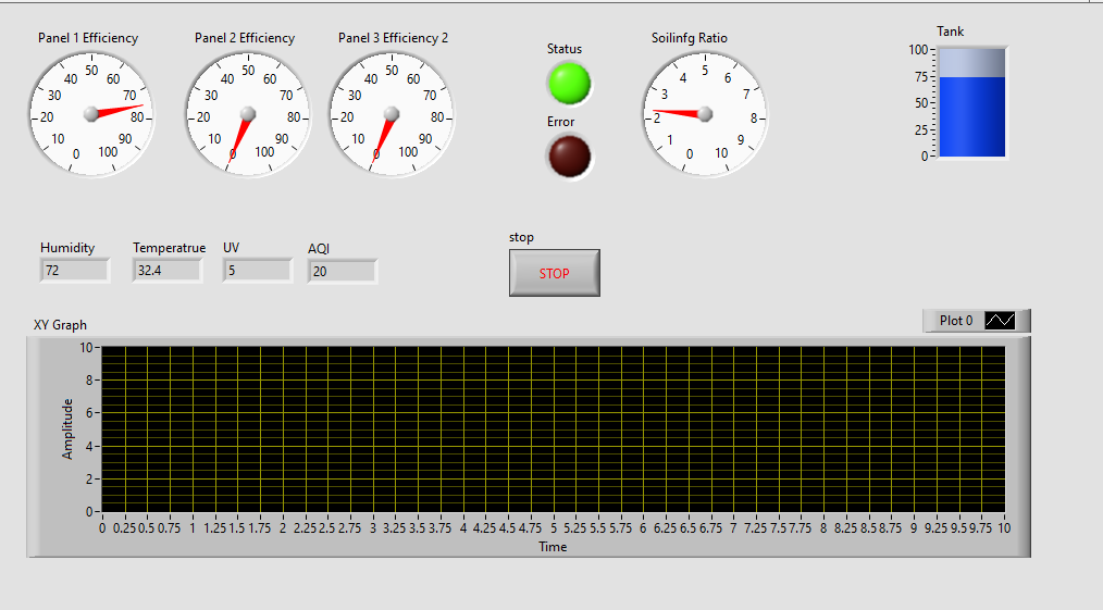

The LabVIEW Dashboard
If you read Part 5, you know how the dashboard is wired. TCP Read -> Unflatten from JSON -> distribute values to gauges and LEDs. The dashboard has:
  • Two panel ratio gauges (0.0 to 1.0)
  • UV index gauge (0 to 12)
  • AQI display
  • Humidity and temperature numeric indicators
  • Battery SOC gauge
  • Cleaning status LED (green / amber / red)
  • A chart that plots panel1_ratio and panel2_ratio over time
Nothing changed on the LabVIEW side. The format of data was locked in Part 5 and I kept it.

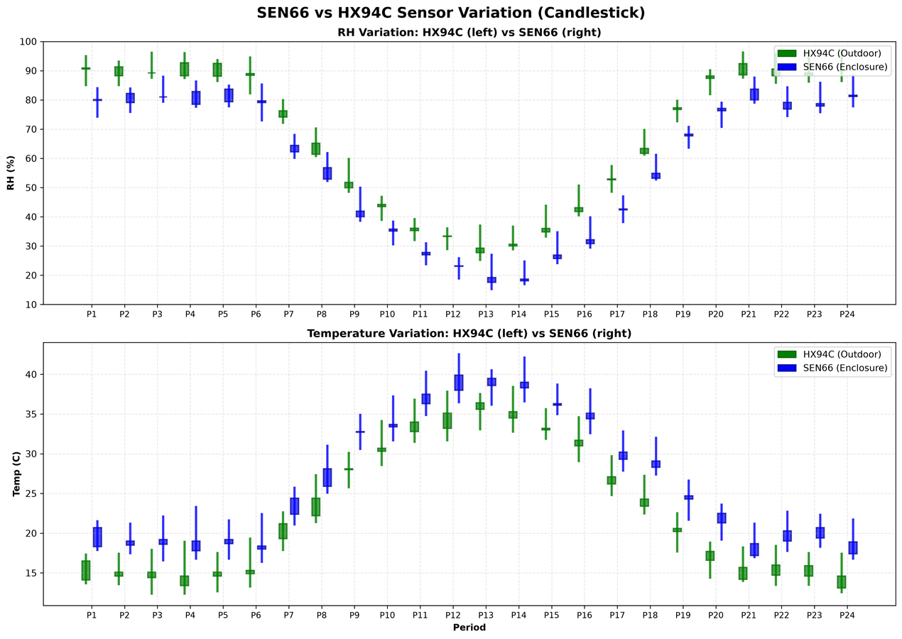

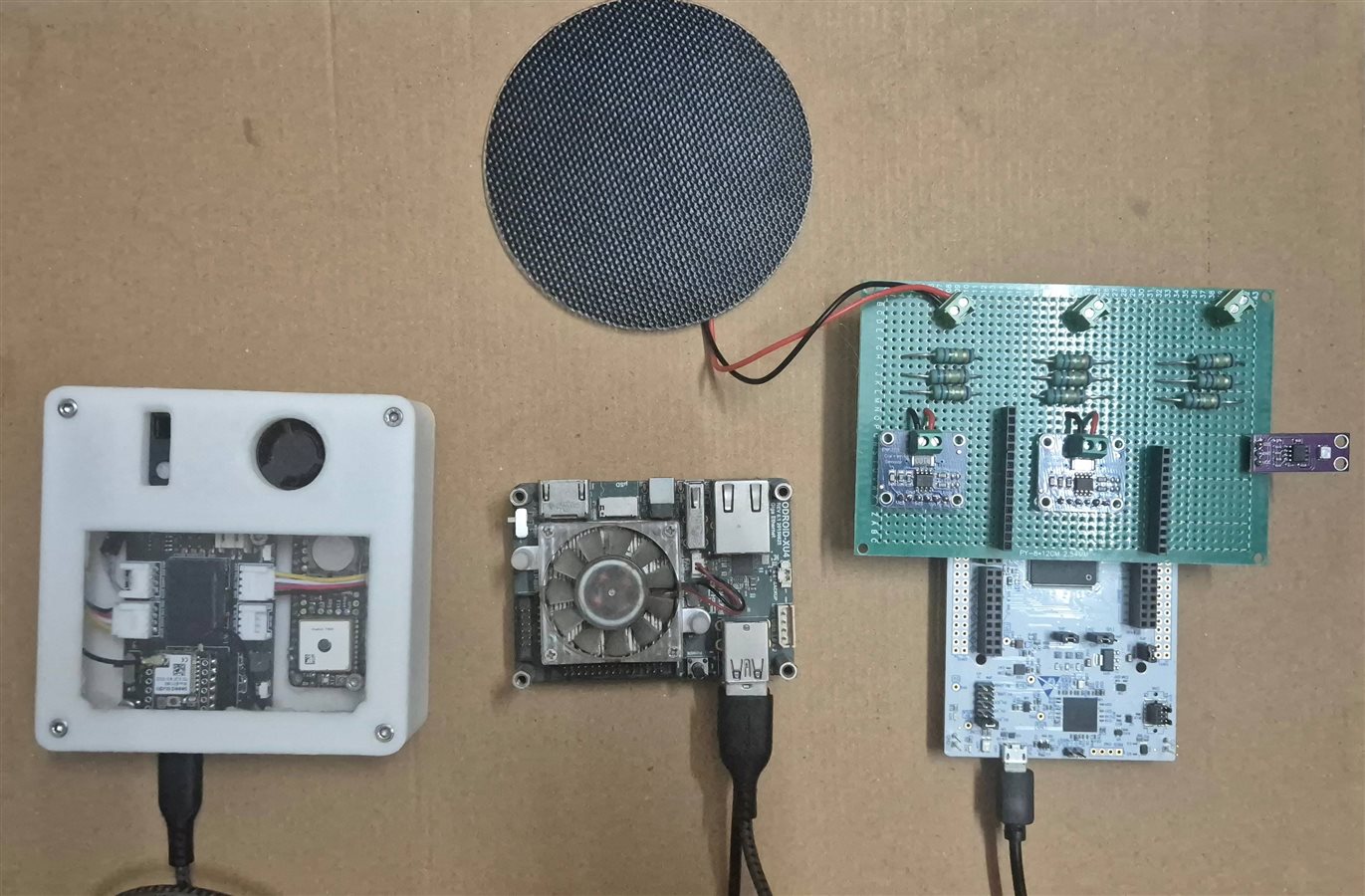

Sensor Data Comparison
One of the important nuance about HX94C is that since it is kept outside the box, it would side variations due to wind, climate etc and is immune to heat generated by the PCB itself. So i ran a comparison between them. with the SEN6X inside the box. (The final mounting has SEN66 fan facing outwards) but still HX94C outperformed. and plotted the candlelight chart.
Green (left) is HX94C sensor which is outdoor, mounted on off-board cable. Blue (right) is SEN66 sensor which is inside the enclosure.
HX94C shown in green shows more variation because it is an outdoor sensor exposed to real environmental conditions. SEN66 shown in blue shows less variation because it is inside the enclosure and thermally stable. SEN66 RH is approximately 10 percent lower than HX94C because the enclosure is hot and dry. SEN66 Temperature is approximately 4 deg C higher than HX94C because of PCB self-heating and the internal fan. Both sensors track together which indicates good correlation despite the bias differences.

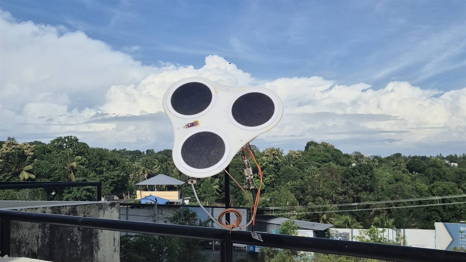

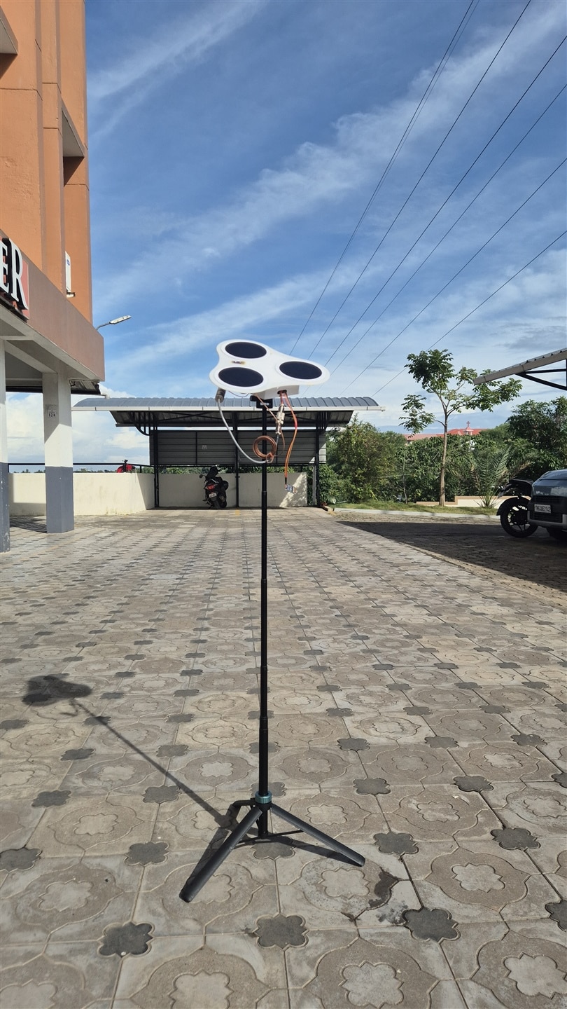

The Final Device
I have fixed the device on the camera tripod using M5 nuts. The enclosure that I currently use has some problems that need to be sorted out. I will be designing a separate enclosure for the CAN shield too. However, before making any changes, it is important for me to make sure that the sensors are made waterproof.
Final Notes
I managed to Frankenstein all the sensors within the timeline and managed to get one day of data. I’m hoping I can find a good sunny day to do a bit more data gathering for better results. I really enjoyed doing this project since it fits perfectly in my area of expertise - working with STM32 HAL libraries, aligning with my field of research, and collecting data which may end up getting published in a journal article. I want to thank the element14 community team as well as their corporate sponsors who have helped in making this build possible.

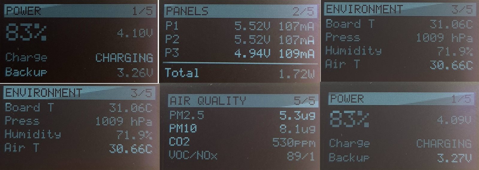

Update Posted on 22 June 5:30AM (UK Time)
Some photos and Video taken on a Sunny day. In the Morning 9am, i am able to receive 1.72W of power from the panels. Even with one panel fully out, i get more than 1W which is more than sufficient to charge the 1500mAH battery during sun time and make it run though the night till next day, even with basic power saving mode (Turn off SEN66 Fan, turn off 12V boost until next measurement is due, turn off OLED etc). The SEN66 draws around 100mA when turning on the fan but settles at 45mA, this is the largest power consumer in the device.  With the SEN66 running 30 s every 5 minutes (10% duty cycle), its average current becomes ~5 mA, bringing the total system draw to ~27 mA including the 22 mA base load (again no CPU sleep and sleep given to other sensors). This results in a battery life of roughly 44 hours (~1.8 days) in ideal conditions at 80% efficiency of battery.
If you are keen eyed, you can see You can see how fast the Panel Temperature (I am showing it as Board T on OLED) rose from 30.4deg C with Air temp 30.5T to  panel temperature of 31.6 deg within seconds of being exposed to sunlight, but with marginal air temperature rise to 30.66deg. Sadly the termocouple dislodged from the panel shortly after
