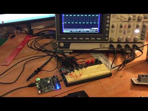

While this project could easily have been done with a microcontroller, and often is, avnrdf decided to build one with the Minized, using both its PS and PL. Here's how it works: "The WS2812 RGB LED uses a single wire serial protocol that infers '1's and '0's by varying the width of a pulse. The project moves the serial output generation & refresh to the PL. The idea is that software in the PL simply writes 'data' to an 'address' in the BRAM (which corresponds to the RGB data of a LED of a given index), and the logic in the PL independently iterates through all the data in the BRAM using the other port, refreshing the LEDs. the main parts are the application that runs in the PS, the AXI4-Lite interface, a custom AXI to BRAM interface, dual port BRAM, a custom BRAM to RGB interface and a RGB to WS2812 generator. I could have used memory mapped BRAM using the Xilinx AXI-BRAM IP, but decided to build a custom interface that uses registers."

Designed by aspork42  and based in the FPGA fabric, "it generates an interrupt every "N" clock cycles; and I mapped it to the 48 MHz clock. This interrupt then feeds into the interrupt concatenator as interrupt #0. I used the IP Library to find new IP and import into my hardware design."
Continuing, "I then exported the hardware and made a new workspace & BSP in the SDK utility. I started with some base code in the SDK and got it working with my new hardware to run things. So I'm using both the PS + PL. I had to re-map the interrupt which was used in the base program to the one generated from Vivado."image
