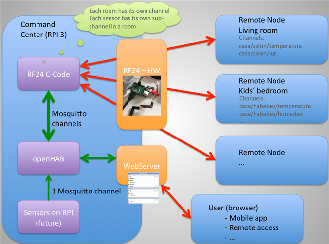

In this week I have managed to make a big step forward with setting up the Command Center. With this post I finalize the basic components in the RPI3 so hope to work on the features - those that will benefit us like the presence emulator, etc - in the coming weeks. Specifically, the post covers installing and configuring the openHAB that provides a web user-interface with interesting add-ons for home automation, Mosquitto that will "glue" all the code in the Command Center and the openHAB server, and the RF24 module to enable communication with the remote nodes via RF 2.4Ghz.
But first, the links to my previous posts and the project status.

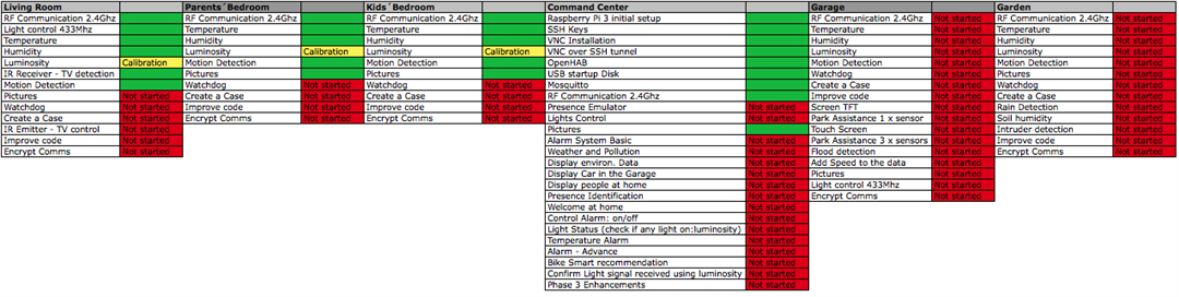

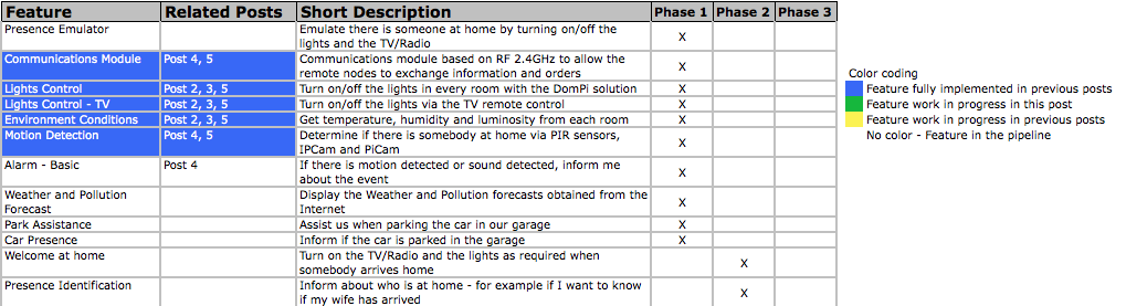

Project Status
Mosquitto - MQTT installation

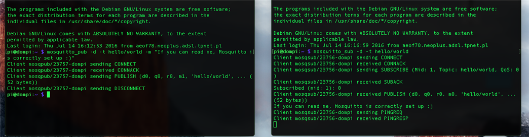

Testing
Let´s test whether the Mosquitto is correctly installed and working. To do so, I run a subscriber in my current SSH session (you can do it in a Terminal window):
mosquitto_sub -d -t hello/world
and in a separate SSH session (or Terminal window) I execute the publisher
mosquitto_pub -d -t hello/world -m "If you can read me, Mosquitto is correctly set up :)"
And, voila, here you have a screenshot of the successful communication between both processes using mosquitto:

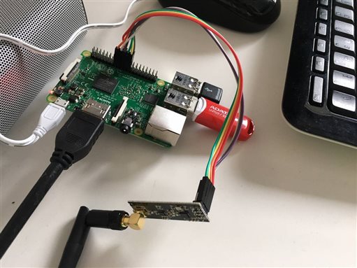

RF 2.4GHz Comms HW and libraries
As discussed in previous posts, the remote nodes - living room, bedrooms, garage and garden, Arduino based - will communicate with the Command Center RPI3 based. This communication is based on the RF 2.4GHz modules. I already connected the board to the Arduino's in previous weeks, let´s now connect the RF board to the RPI3. As with the Arduinos, although the RF board has 8 pins, the pin for the IRQ is not required for DomPi, so I only need to connect 7 as per this table:
NRF24L01+ Radio moduleRPI3 GPIO pin (header pinout here)
MISOMISO (21)
MOSIMOSI (19)
SCKSCKL (23)
CSNGPIO8 (24)
CEGPIO22 (15)
VCCAny 3.3v pin
GNDAny GND pin
IRQ(none - not required)
More details here.
