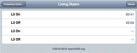

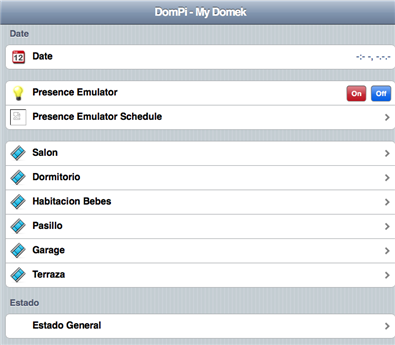

This post covers three key components:
  • the C++ module that connects the external RF24 messaging with the internal mosquitto channels,

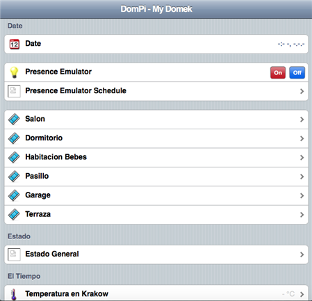

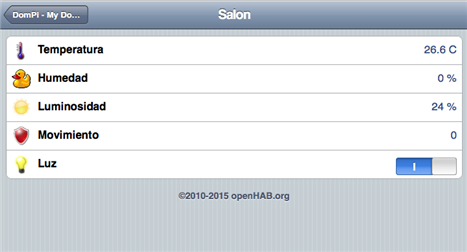

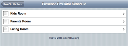

  • the initial openHAB sitemaps, items and rules
  • the Presence Emulator feature to simulate that I am at home instead of enjoying my vacations

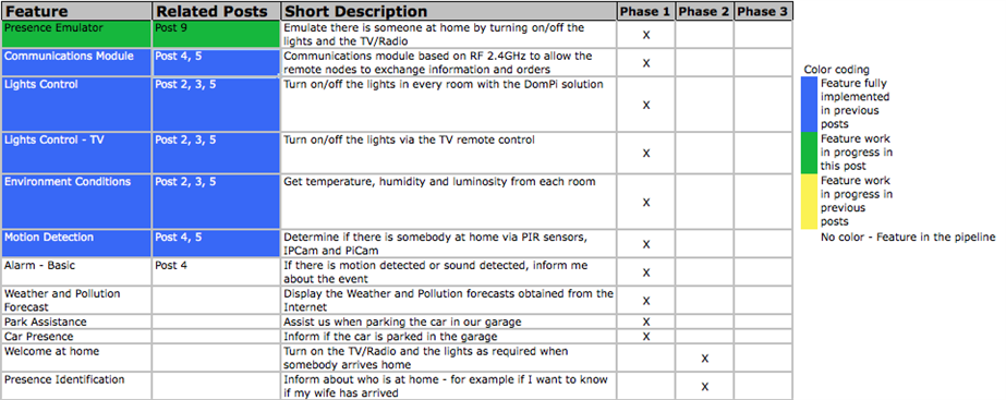

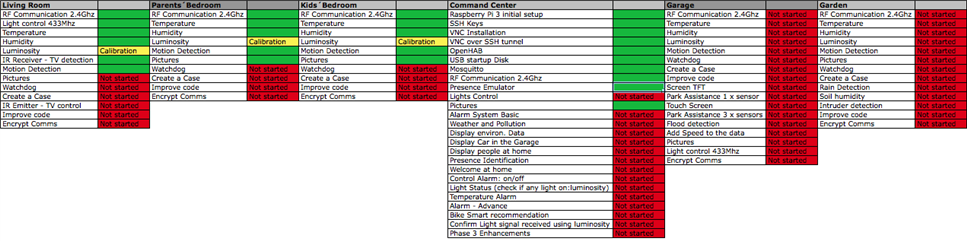

Project Status

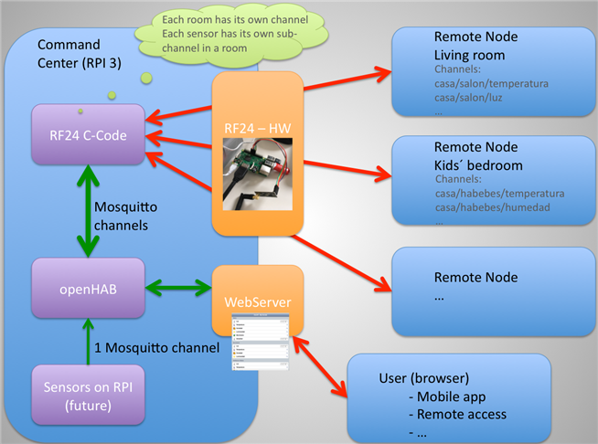

RF24 C++ Gateway
This module governs the RF board, enabling the communication with the remote nodes. It will receive and send any data and commands at DomPi. Internally, it interfaces with the Mosquitto hub in the Command Center (RPI3), subscribing and publishing to the relevant mqtt channels. Via these channels it shares the information received from the nodes with the openHAB and gets commands from it - like turn on/off the lights, provide updated temperature, humidity or movement detection.
As a quick summary, this is the architecture in a nutshell - further details at PiIoT - DomPi 08: Setting up the Command Center (3) openHAB, mosquitto, RF24:

Sitemap file:
Sitemap file:
sitemap default label="DomPi - My Domek"
    Frame label="Date" {
        Text item=Date
    Frame {
        Switch item=Presence_Emulator mappings=[ON="On", OFF="Off"]
        Group item=gPE visibility=[Presence_Emulator==ON]
    Frame {
        Group item=P_Salon         label="Salon"                 //icon="firstfloor"
        Group item=Dormitorio     label="Dormitorio"             //icon="firstfloor"
        Group item=Habebes         label="Habitacion Bebes"     //icon="firstfloor"
        Group item=Pasillo         label="Pasillo"             //icon="firstfloor"
        Group item=gGarage         label="Garage"                 //icon="firstfloor"
        Group item=gGarden         label="Terraza"             //icon="firstfloor"
    Frame label="Estado" {
        Group item=gStatus
    Frame label="El Tiempo" {
        Text item=Weather_Temperature valuecolor=[Weather_LastUpdate=="Uninitialized"="lightgray",Weather_LastUpdate>90="lightgray",>25="orange",>15="green",>5="orange",<=5="blue"] {
            Frame {
                Text item=Weather_Temp_Max valuecolor=[>25="orange",>15="green",>5="orange",<=5="blue"]
                Text item=Weather_Temp_Min valuecolor=[>25="orange",>15="green",>5="orange",<=5="blue"]
                Text item=Weather_Humidity
                Text item=Weather_Humidex
                Text item=Weather_LastUpdate visibility=[Weather_LastUpdate>30] valuecolor=[Weather_LastUpdate>120="orange", Weather_LastUpdate>300="red"]
            Frame {
                Switch item=Weather_Chart_Period label="Chart Period" mappings=[0="Hour", 1="Day", 2="Week"]
                Chart item=Weather_Chart period=h refresh=6000 visibility=[Weather_Chart_Period==0, Weather_Chart_Period=="Uninitialized"]
                Chart item=Weather_Chart period=D refresh=30000 visibility=[Weather_Chart_Period==1]
                Chart item=Weather_Chart period=W refresh=30000 visibility=[Weather_Chart_Period==2]
    Frame label="Conjuntos" {
        Text label="Agrupacion" icon="firstfloor" {
            Switch item=Lamparas mappings=[OFF="All Off"]
            Group item=Movimientos
            Text item=Temperaturas
            Text item=Humedades
            Text item=Luminosidades
        Text label="Widget Overview" icon="chart" {
            Frame label="Binary Widgets" {
                Switch item=DemoSwitch label="Toggle Switch"
                Switch item=DemoSwitch label="Button Switch" mappings=[ON="On", OFF="Off"]
            Frame label="Map/Location" {
                Mapview item=DemoLocation height=10

Presence Emulator
Strictly speaking, last feature of the project was developed in the PiIoT - DomPi 05: Ready for use Living Room and parents and kids´ bedrooms (lights control via the TV remote). That was "long" time ago and I am very happy to be able to deliver the next feature from the Project Status list image
The purpose of the Presence Emulator feature is in this first development to turn on and off the rooms´lights simulating that there is someone at home while we are away on vacations or for the weekend. This is key for us as we live in the basement and want to avoid "surprises" when returning home. I have developed a openHAB set of rules that govern this emulation. You can see the rule file below. Additionally I have added a new item to the item file (as per above), the Presence_Emulator, that allows the user to activate or deactivate the feature. Finally, I did add the item in the sitemap, I just added it to the main page to have it handy. If the main page starts to get busy I might move it out to other pages.

The key part is the rule called "Presence Emulator to ON", which is called when the feature is activated. Its first action is to create the scheduler for turning on and off the lights for the day of today. In this first development I have just added 1 on cycle and 1 off cycle per light. The light in the living room has different hours than the other two for turning on and off. To make it more real, I have randomized all of the times, so that each day the lights turn on and off at different hours.
This approach is quite basic and in future developments I plan to add: automatic addition of another cycle for Winter (it will differentiate between Summer and Winter since where I live there is big time differences) and I will add some random cycles (from time to time, to turn on/off the lights more times per day). Not sure if I will be able to make it within the PiIoT challenge as I will need to focus on adding more features. In any case, in the items file, I have already added a placeholder for a second cycle for all of the lights.
Finally, a cool feature from openHAB is that you can hide/unhide some items in the User Interface by adding the "visibility" label. In the screenshot above of openHAB for the main page, you can see the buttons to activate/deactivate the Presence Emulator. If it is "On", openHAB will display an additional clickable line that brings you to the scheduler to check the hours when the lights will be turned on and off. See the screenshots below.
