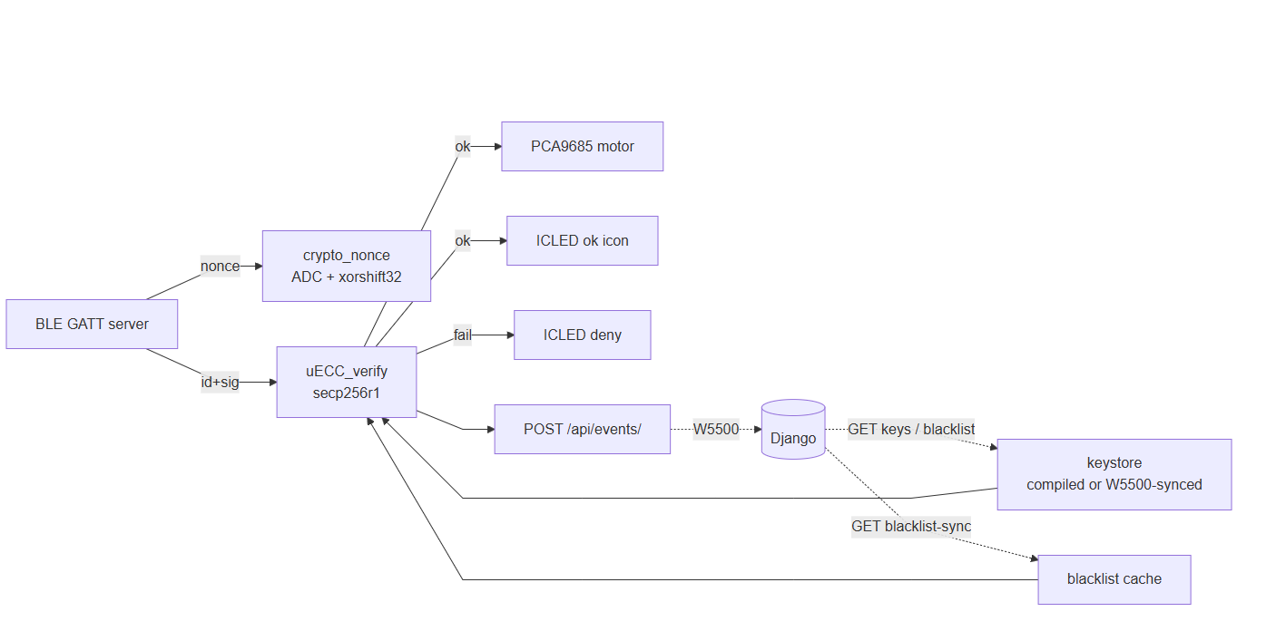

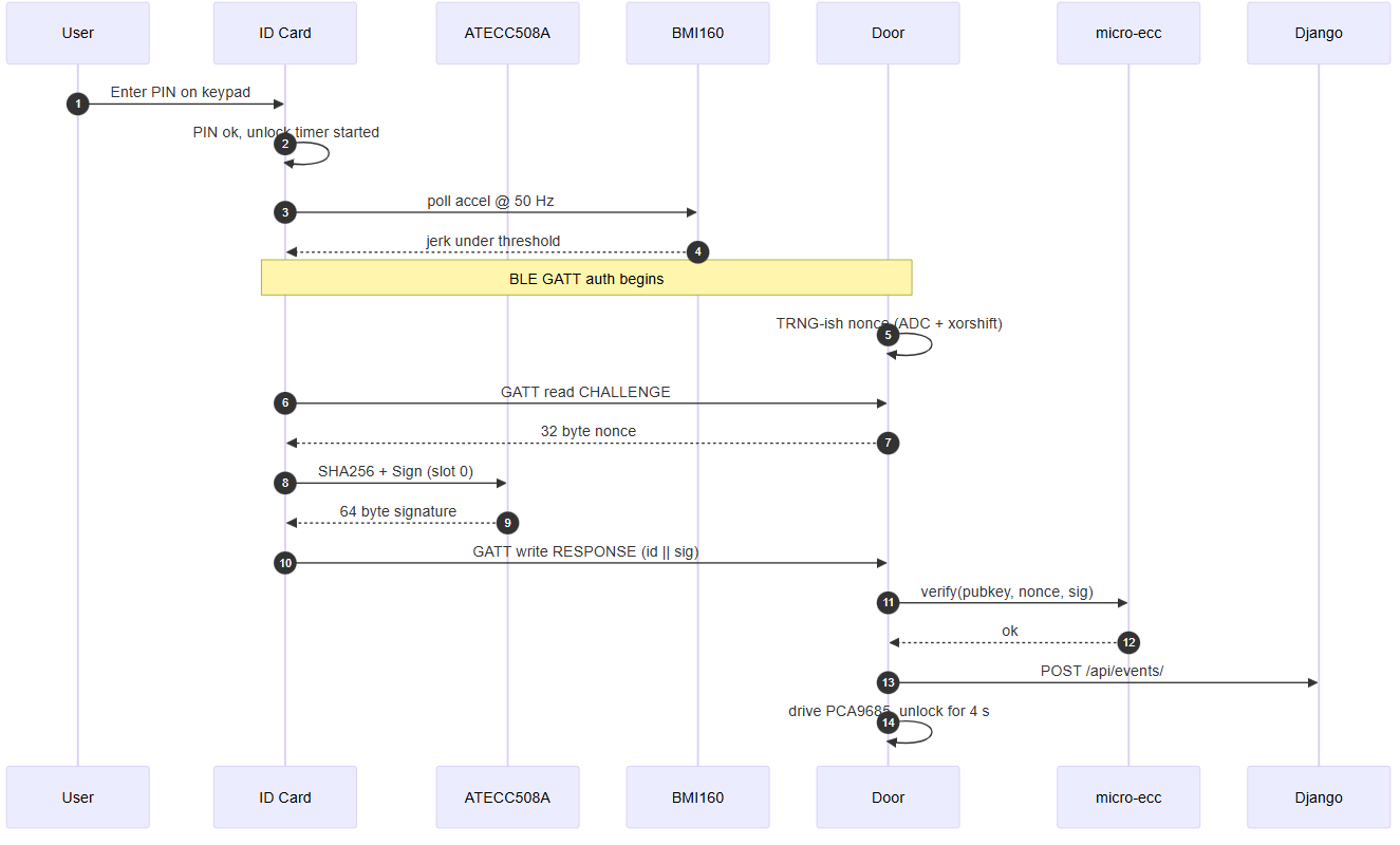

The big picture
Here is the end-to-end flow with everything wired up. This is what actually runs now, I don't want to compare what i proposed and what i ended up with after the technical hurdles i had to go around as well as the occasional laziness.

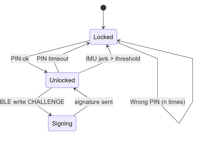

And the device states the ID card cycles through:

id_device.c - basic layout
int main(void)
    Board_Init();                 // fthr-board, not EvKit_V1
    debug_uart_init();            // UART1 MAP_A, printf goes here
    led_init();
    keypad_init();
    pin_state_init();
    imu_init();                   // BMI160: soft reset, accel-normal, check 0xD1
    crypto_init();                // ATECC508A wake, read serial -> device_id
    auth_ble_init();              // BTstack: HCI up, start scanning Auth-Door
    for (;;) {
        int key = keypad_scan();
        if (key >= 0) pin_state_feed(key);
        if (imu_jerk() > JERK_LOCK_THRESHOLD) pin_state_force_lock();
        if (pin_state_timed_out()) pin_state_force_lock();
        led_show(pin_state_get()); // green / red / amber
        // BLE GATT state machine runs in BTstack callbacks:
        //   on CHALLENGE read complete -> SHA256 + atca_sign -> GATT write RESPONSE
        btstack_run_loop_execute_once();
door_device.c - basic shape
int main(void)
    Board_Init();
    debug_uart_init();
    icled_init();                 // PWM timer, warmup, switch func_sel after rollover
    motor_init();                 // PCA9685 over I2CM2
    optical_init();               // reed switch -> IRQ
    eth_init();                   // SYS_IOMAN_UseVDDIOH(PORT_5, ...) then SPIM_Init
    eth_static_ip(IP, MASK, GW);
    keystore_init();              // try eth_sync_pubkeys(); fall back to compiled keys
    auth_server_init();           // BTstack: advertise "Auth-Door", custom GATT
    for (;;) {
        auth_server_tick();
        eth_tick();                // poll for blacklist sync
and in auth_server.c
// Called when central reads CHALLENGE
uint16_t on_read_challenge(uint8_t *out)
    crypto_nonce(out, 32);        // ADC noise + xorshift32 (Part 8)
    memcpy(active_nonce, out, 32);
    return 32;
// Called when central writes RESPONSE
int on_write_response(const uint8_t *buf, uint16_t len)
    if (len != 4 + 64) return -1;
    uint32_t device_id = be32(buf);
    if (blacklist_contains(device_id)) {
        log_event(device_id, RESULT_BLACKLISTED);
        icled_show(ICON_DENY);
        return -2;
    const uint8_t *pubkey = keystore_lookup(device_id);
    if (!pubkey) return -3;
    uint8_t hash[32];
    sha256(active_nonce, 32, hash);
    if (!uECC_verify(pubkey, hash, 32, buf + 4, uECC_secp256r1())) {
        log_event(device_id, RESULT_BAD_SIG);
        return -4;
    motor_unlock(4000);
    icled_show(ICON_OK);
    log_event(device_id, RESULT_OK);
    return 0;
And the data flow on the door device

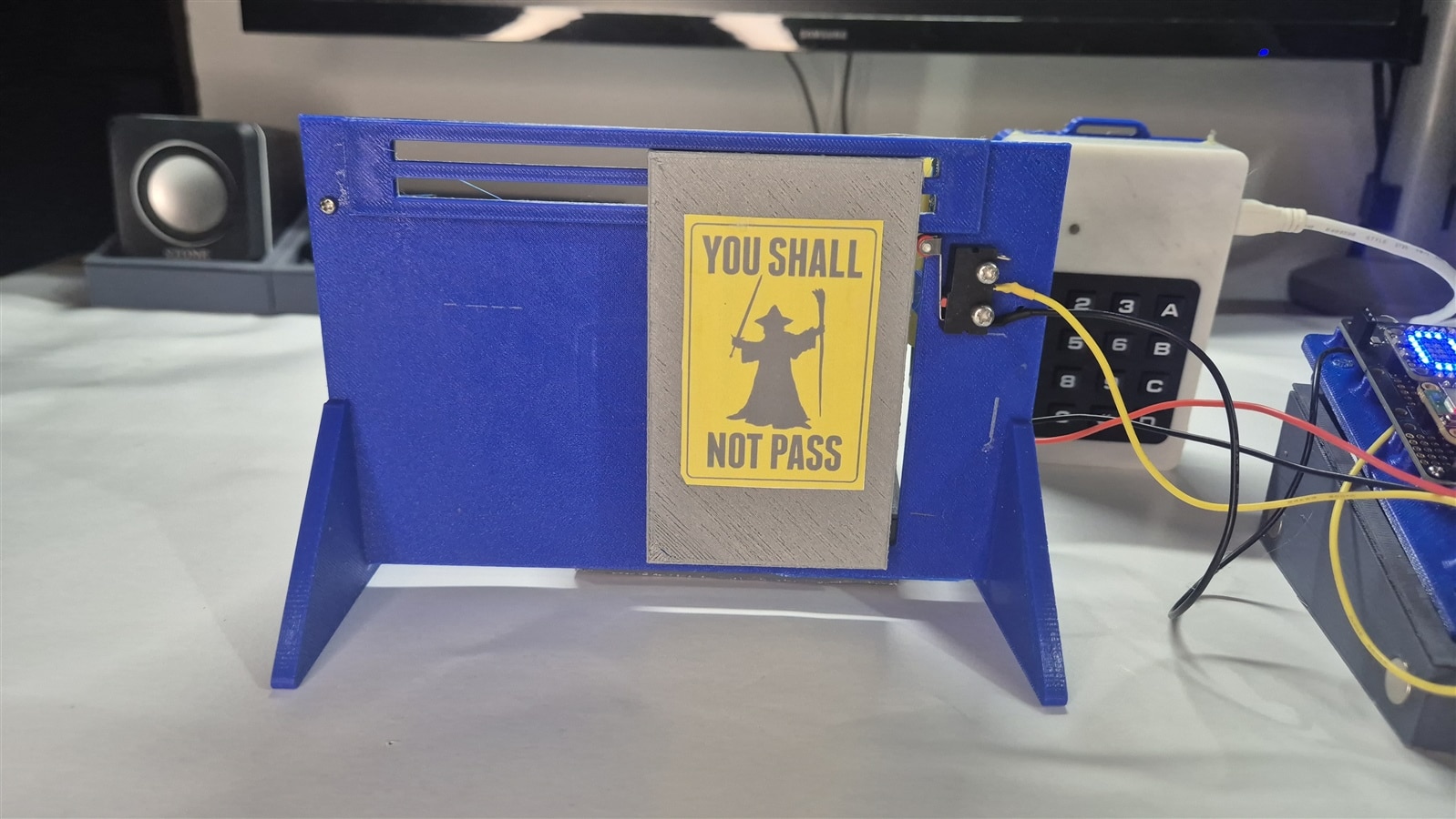

Mechanical Works
Nothing is purely electronics for me, i want some motion too. So i made a 3D printed Automatic door. Using a micro 90Deg Motor, A limit switch, pulley and a rubber band. It was not an very elegant setup but it works. I was trying to be an environmentalist to finish off filaments which was purchased over two years ago (Spring Clean!!!) and had gulped down moisture significantly. It had to dry them to get it to working.
The inside of the ID Device. It is messy,. Lots of Hot glue. Note the ATECC508A is on the top right corner. The moisture laden filament did cause dimension issue due to which i had to rely on hot glue.
Me using Leftover filaments.
and the  result of the mix.

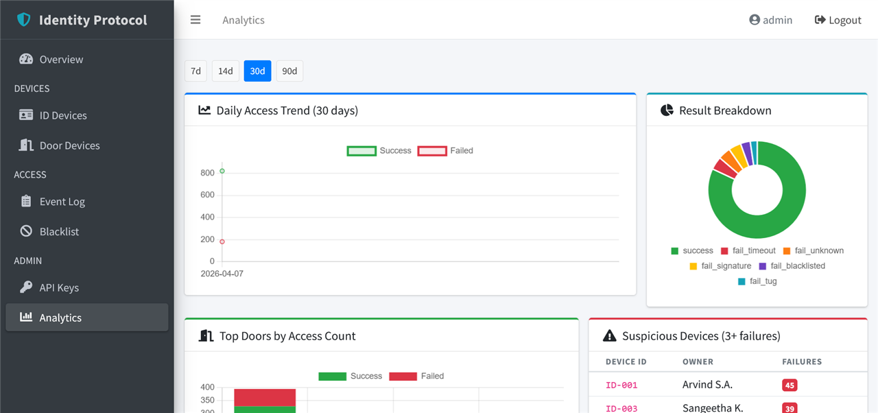

And on The Django Side
Dashboard
Door Device CRUD
Access Log
Device Keys
Analytics
