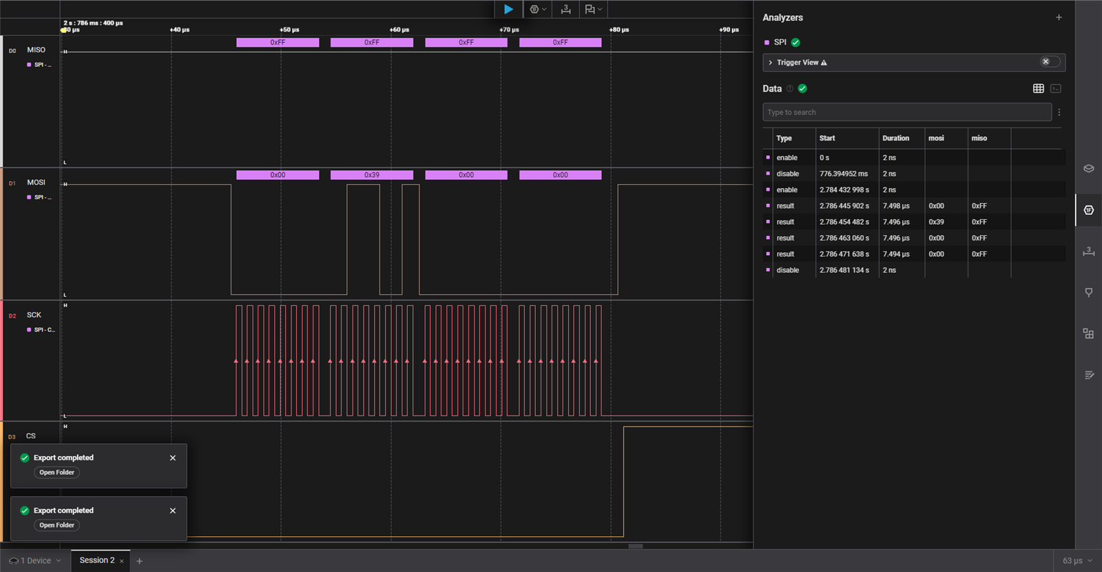

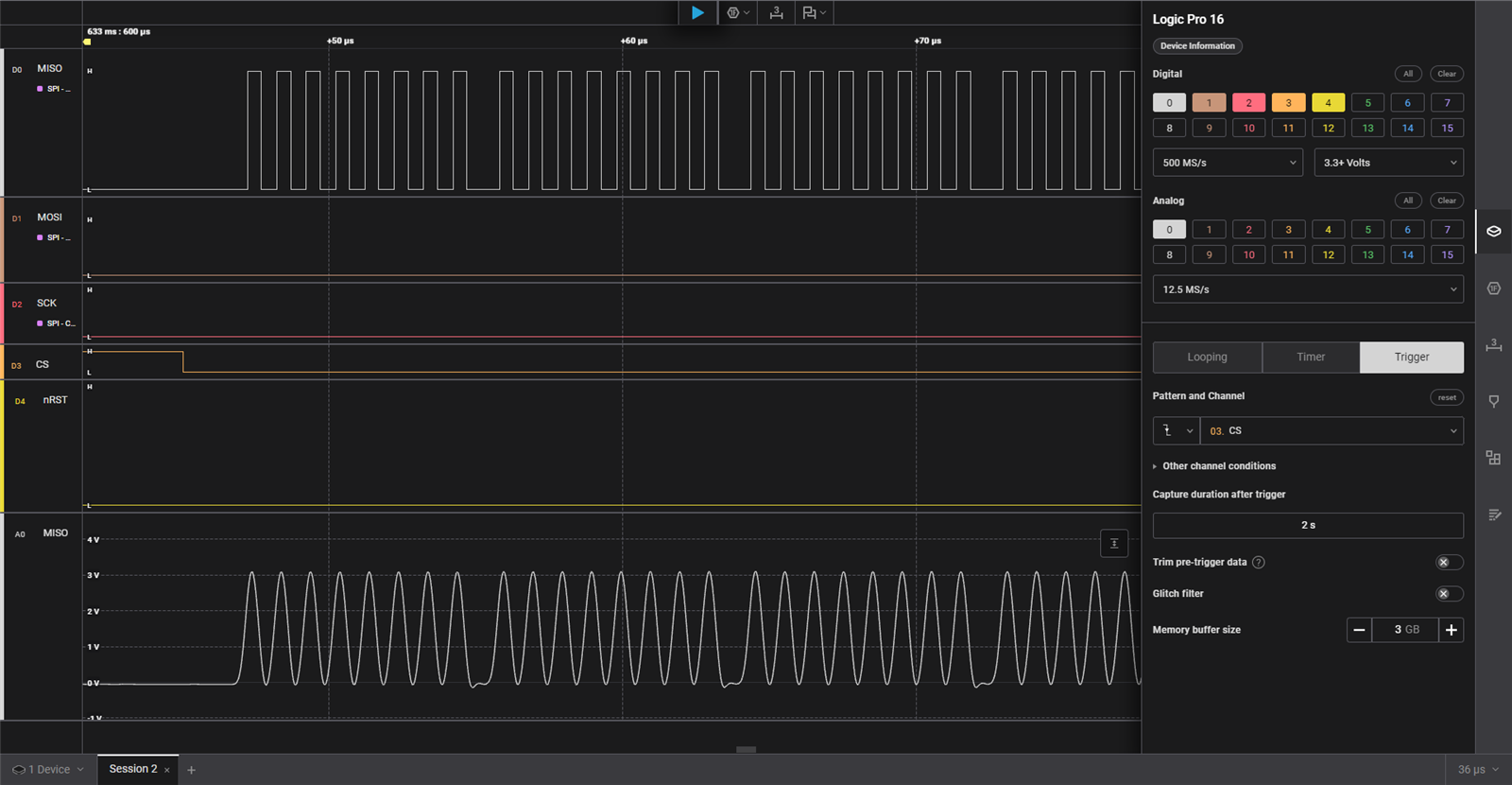

But my code was being heard on deaf ears, No response. I tried going though the documentation, it's clear as day. It should work, But it did not. So, I hooked up my logic analyzer. No signals on the clock lines. Then spend an hour trying to see why the SPI peripherals is not being initiated. I even compiled the official examples, yet no avail. But then I "Accidentally" Clicked the Analog reading of the signal lines and then i saw something like an ECG. The SPI's clock line. But the logic levels was around 1.7V. And then it hit me. The chip is communicating at 1.8V levels. But W5500 Does not respond back to such levels. So first instinct, I used TXB108 Level shifter, I checked the output lines, and it was working but W5500 Never responded. I was greeted with 0xFF
Now, what i noticed is that when i reset, the MOSI was not very consistent. Ideally it was supposed to sent 0x00 0x39 0x00 0x00 (the image above has the ideal sequence) but many times i noticed, there would be extra 0xFF in between the right sequence. I felt the level shifter had to do something to with the ghost bits, In my past, the level shifter had created issues for me. Without a reliable level shifting, I was stuck, But then i remembered the MAX32630 was working fine with the I2C lines which was pulled up to 3.3V which means it is 3.3V tolerant,  so i dug into the documentation to find, i can change the Logic level of the Pins on an individual level. Whoa is what i said,
By changing the IOMAN has select bits to move a pins output buffer to another voltage level (use_vddioh_0/1/2). By calling SYS_IOMAN_UseVDDIOH(&cfg) after SPIM_Init, I get a 3.3V SPI Signals
const spim_cfg_t spim_cfg = { .mode=0, .ssel_pol=SPIM_SSEL0_LOW, .baud=1000000 };
SPIM_Init(MXC_SPIM2, &spim_cfg, &sys_cfg);
const gpio_cfg_t spim2_vddioh = {
    PORT_5, (PIN_0 | PIN_1 | PIN_2 | PIN_3),
    GPIO_FUNC_GPIO, GPIO_PAD_NORMAL
SYS_IOMAN_UseVDDIOH(&spim2_vddioh);
Careful enough to change only the SPI lines i tried again and It is alive. W5500 was talking back 0x40.
