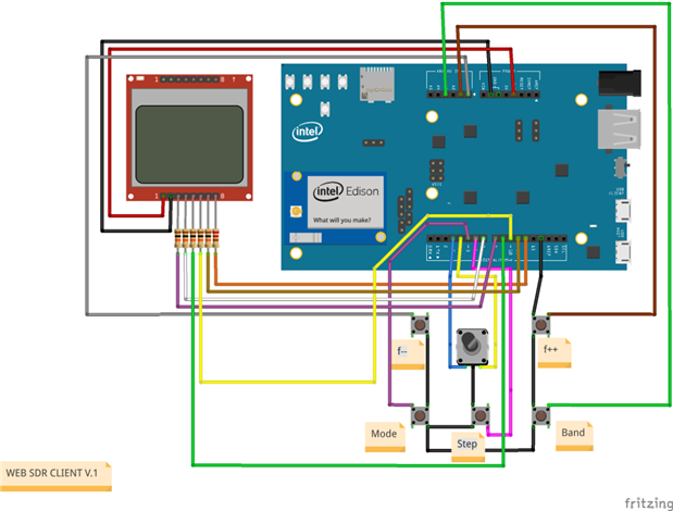

I started to read more about MRAA and UPM in my effort to understand how I could set up my environment for my project which is my final goal.
I had to setup a plan on how to make my Arduino ATMega328 part of my software ported to Edison environment.
First of all my display. The Nokia 5110/3110 84 x 48 monochrome with the PCD8544 controller.
It was not listed among the displays listed in UPM.
I registered with the Intel community and started searching about it.
I only found that some people had tried to use it but with no success or evident success.
I decided to make some follow up to find if there was some update on that issue, but although I contacted the people that tried to use the display and had started discussions on the Intel community.
In one of the three instances the reply came to me negative and the person who had tried using the LCD, simply changed to something like JHD1313M1.
I then found the reference that Adafruit had a Python Library for that display and by searching further, I found that the Nokia LCD was being used with Rpi and BeagleBone.
I found the following link https://github.com/XavierBerger/pcd8544
and https://learn.adafruit.com/nokia-5110-3310-lcd-python-library/overview , so I decided that the next big milestone for me would be to manage to make the LCD play with the Edison.
So I have to study the documentation and carry out some tests now that I have all the hardware.
As that LCD is using Hardware-SPI, which obviously is available with MRAA, I will try using the pin connectivity that is being used also for the Sparkfun 64x48 OLED Display.
According to the schematic of that display (https://cdn.sparkfun.com/datasheets/Dev/Edison/oled_block.pdf), it is connected as follows:
D0/SCK GP109_SPI_2_CLK
D/MOSI GP115_SPI_2_TXD
D/C GP14_
RESET GP15_
CS GP110_SPI_2_FS0 or GP111_SPI_2_FS1 (by default wired to GP110)
So, I need to understand the GPIO nomenclature which to my thinking (please correct me if I am wrong) is different for the Arduino Board and the Breadboard.
Moreover in the Arduino board, although electrically you use Arduino naming (i.e. D0, D1, D2 …, A0, etc.), in the Edison sketch you must use the Edison GP numbering (i.e. GP109, GP115, etc.). As for the connectivity issue, my original drawing should work.
Having said that, I think making the Nokia 5110 display to work is number one priority for my project.
Then of course I have to see and test the interrupt issue, as in the original Arduino, I would initialize things by using the following code:

I assume that the interrupt and io calls for the avr system should be replaced by the equivalent calls for Edison.
For the whole series of first tests, I will stick to the Edison Arduino board, in order to keep things as easy and clear as possible.

    mcb1 over 9 years ago +1
    Moreover in the Arduino board, although electrically you use Arduino naming (i.e. D0, D1, D2 …, A0, etc.), in the Edison sketch you must use the Edison GP numbering (i.e. GP109, GP115, etc). When using…
    DAB over 9 years ago +1
    Nice update. It looks like you are making good progress. DAB
  • konstantinoskonstas
    konstantinoskonstas over 9 years ago in reply to mcb1 +1
    @mcb1 Thanks a lot for the guidance Mark. It starts to get clear gradually. MRAA, UPM and the like. It is 11 am Pacific time and I am trying to figure out how to set up the Python lib for the Nokia 5110…
    mcb1 over 9 years ago in reply to konstantinoskonstas
    I ran across this that Scott has done with a Nokia 6100 display .... it may help, or not.
    CapperLabs Greenhouse Controller - Blog 3 - Intel Edison
    @mcb1
    Thanks Mark for pointing that out.
    I am aware of such issues and prepared to face them.
    You are right that there is no compatibility between the two worlds, and I am well prepared to write everything from scratch in any environment that will best suit my solving the display issue and make it working. Language is not an issue. And thanks for pointing out the issue with Yocto. I have ready Ubilinux on the second Edison. But yet I want to try some things.
    What I really need to know are those don'ts with various issues. I am sure Hardware SPI is on the dark side of Edison, but I have to find out somehow. If you look at the MRAA page, say ver. 1.6.x compatibility over a number of systems (including RPi) is stated, whatever that may mean.
    So basically I am looking for the implementation method of that Python library with Edison, but I still read a few things.
    Thanks for sharing any detailed that may have come to your experienced eye with me.
    Cheers,
    Konstantinos
    I seem to recall there are some examples of talking to it using the Arduino boards.
    Whether that translates into it working on the Edison (and on the Linux side) is ???
    Even if you can make it talk on the Arduino sketch side, getting the data from the Linux side is another headache.
    I'm imagining that you need variables that are availble to both the sketch and Linux.
    The issue I have seen with Yocto is that it doesn't inlcude some libraries that the other distributions have included.
    Good luck
    konstantinoskonstas over 9 years ago in reply to DAB
    @DAB
    Thanks again.
    I am not up to what I would like to be.
    I can write an Arduino library, but not sure yet about putting one in UPM.
    OK, back to work.
    Konstantinos
    @mcb1
    It is 11 am Pacific time and I am trying to figure out how to set up the Python lib for the Nokia 5110 working with Edison.
    Actual example is for RPi, so again there is a leap here.
    But at least I know that the electrical connections won't give me a shock!
    I keep the Grove LCD as the worst case backup, so back to work.
    Konstantinos
