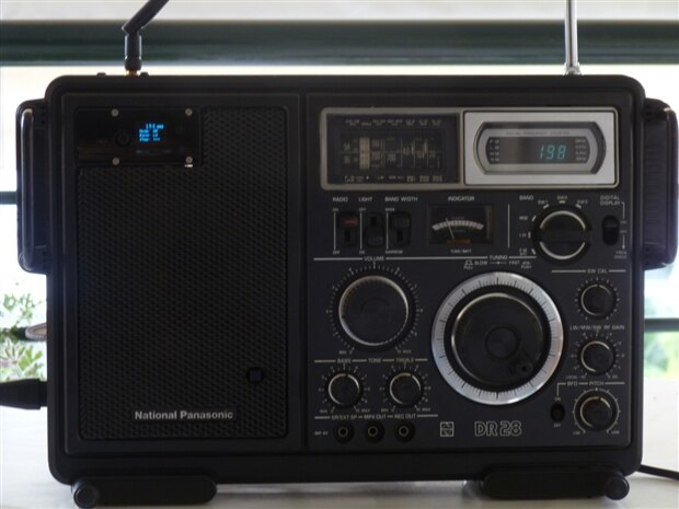

Upcycle finished! The Hybrid Radio is ready
I published the first draft pic as a comment to my last post #10. Here is a better one.
This is my last post for the Upcycle-it Challenge,
During the last week of the project everything had to go according to plan. On Friday, June 2nd  noon time,  I had an almost finished radio that still needed some finishing touches, but it was working.
While I was in the process of preparing it and the software  ready, more ideas and features came to my mind. Things that if you do not have something up and running to familiarize yourself with, you cannot even think of.
We live in the IoT era and experiment with it. I am not sure what the next leap will be. One thing is sure, I have come a long way from my first Intel 8080 and the ARPANET of the 300/75 bps modems to our wifi super fast society. I decided to participate in this Challenge as I wanted to experiment with new ideas. Intel Edison proved to be quite an interesting and powerful platform. As I have another board I am thinking to use for an upgraded version of the Web SDR Analog Radio Client.
It would be really nice if a friend or fellow Ham  could share directly with you an interesting or rare reception the moment it takes place, and you could listen to it on your hardware right away.
Web SDR movement expands. Have a look at   www.sdr.hu, and you can get a taste of it.  Companies like ICOM, specializing in Amateur Radio equipment start using SDR technology in their products. KiwiSDR (http://kiwisdr.com/KiwiSDR/) lets you build a Wideband Web SDR server with a BeagleBone Black.
Although I have accomplished my task for my 1978 Panasonic vintage receiver, I want to  continue my experimentation. There are plenty of vintage receivers to Upcycle, adding various flavors to them.

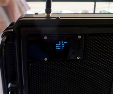

The idea with the OLED display and the building block from Sparkfun gave me the smallest possible footprint, but for the next project, I would opt for a larger screen.
Tuning to the same station both from my location through the analog portion of my receiver and the Web SDR portion of my Intel Edison I can compare the reception conditions of the same broadcasting transmission at two different locations in one panel and come with useful observations about Wave Propagation, just to name one important feature.

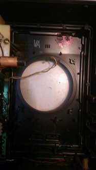

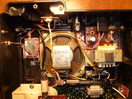

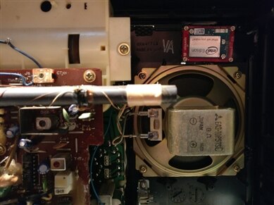

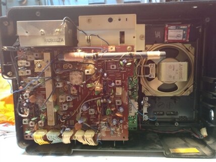

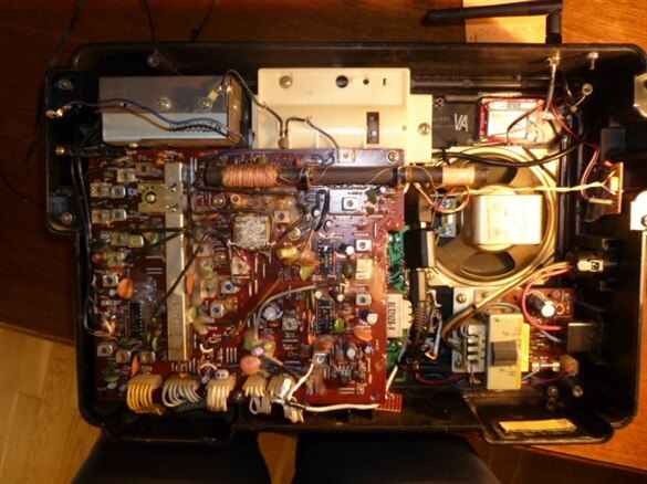

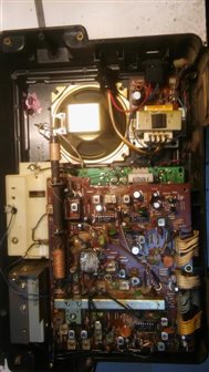

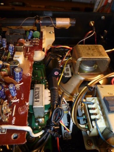

Wrapping the Panasonic receiver

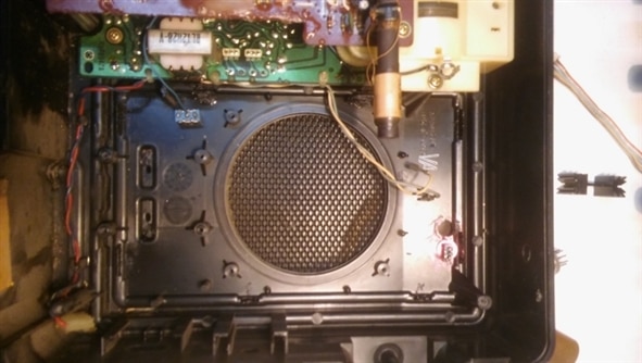

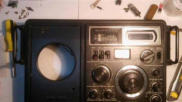

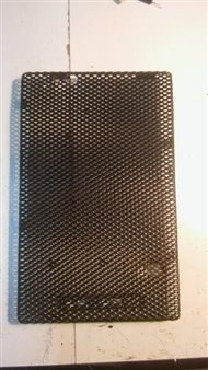

Well, before wrapping it up, I had to open my receiver, carefully remove the antenna wire and the battery connections and put away the back comer. Then I removed the power supply, the speaker, the logo name plate and eventually the speaker metal front grill.
Getting ready to be recycled/imageimage
I decided to use a plexiglass front plate from a scrapped device that was a short of magnifying glass as well.
I mounted the Edison block on it with four screws. The most difficult part was to find a knob for the joystick button. All the possible places that I visited had knobs that had a larger square diameter than the one that was needed which was 2.2 mm. That was a problem. I should have thought of it earlier, but I was always under the impression that shops that sold such joystick buttons, would also have the right knob for it. As that was not true, I thought that I could print a 3d button from the local 3dhub print shops, but I needed the file in the right format for it. Delivery was next day, so I was still withing my plan. But I did not find such file. I contacted Sparkfun’s support, but they only had the pdf file of the switch that I had in the meantime traced (SF303GJ26-3).
So I decided to make one myself with the help of a friend that is more experienced on such mechanical tasks. The plastic axle of an Alps potentiometer was used for the purpose, as it had a small hole in the center. It was cut in the right length and the hole was enlarged to 2,2 mm so that it could be fit on the joystick. It was successfully fitted by 03:15 on Thursday morning and to mark the occasion we named our effort as the Midnight project.
We also had to change the two buttons on the OLED board, with ones that had longer axle, but that less difficult. We then cut a conical hole on the plexiglass for the joystick button and by 06:30 on Friday morning the Midnight project was over. During that time we also had to cut and bend the grill, fit a new 2 gang push button change-over switch and put everything together using simple tools. It was a great experience for me.
After some hours sleep, I had to make a small LM317 regulator board that would power the Edison with 4 volts, to be on the safe side, make the Audio and power connections and put everything back hoping that it would work.
That “easy” task took time to complete, as the schematics that I had found did not correspond to the pcb’s of my radio, but with patience everything was gradually resolved and I  ended up with a working radio, a dual mode Hybrid, Web SDR & Analog Receiver. One of its kind if you really think of it. It combined all kind of technologies. A mechanical frequency dial, a switchable frequency counter and a Web SDR client with an OLED display powered by an Intel Edison. The 1978 receiver had been Upcycled to modern standards.
I was the proud and happy owner of it. Panasonic DR-28/ MK-I.
